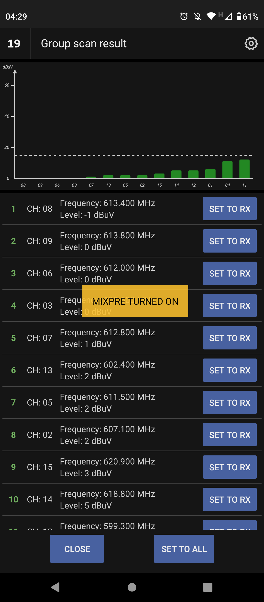

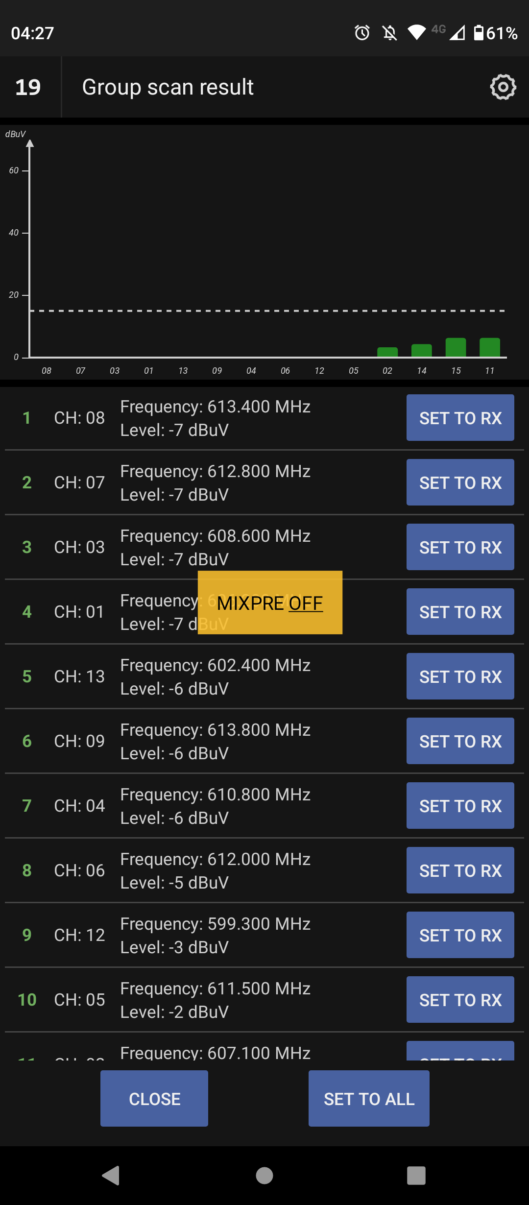

JamesClark1991 Posted March 15 Report Share Posted March 15 I've just noticed this myself when doing tests using my Mixpre-10 ii and MCR54 (screenshots attached). I've now added Betso Bowties to the outer of my ORCA 280 bag which has reduced the effect (although not completely eliminated as the bag is very small). Quote Link to comment Share on other sites More sharing options...
