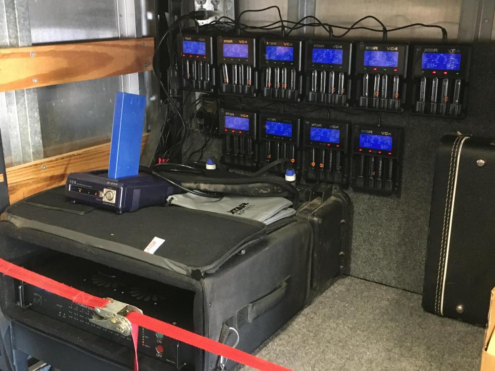

Izen Ears Posted November 19, 2021 Author Report Posted November 19, 2021 Just a li’l update: We got the Eneloop Pros + these weird 3rd party chargers that operate using 5 volt USB power. The stupid Panasonic chargers are AC! That threw me for a loop, but now we have the XTAR VC4 chargers and they’re great. Because we don’t have a genny on our truck this show, I devised a DC system that uses my backup Powermax + 2x old school PSC block batts, custom cables that go from XLR4 M to cigarette lighter receptacles, and finally some car USB chargers that can handle 1A output. With this system, as long as we get stung for a few hours per week, those chargers can run uninterrupted. We do not charge overnight, the system is powered down at wrap. It’s working great! I have to say there is a lot more freedom using rechargeables. In the past with the Energizer lithiums, I felt the need to run them down before changing. This led to lots of “last minute” batt changes, and on occasion that fun anxiety-based game “battery flashing during the long take” But now, we just change em whenever we feel like it, without the environmental guilt of not fully using a lithium. I’m just glad I didn’t have to pay for all this new crap! Dan Quote

DanieldH Posted November 25, 2021 Report Posted November 25, 2021 On 11/19/2021 at 6:29 PM, Izen Ears said: Just a li’l update: We got the Eneloop Pros + these weird 3rd party chargers that operate using 5 volt USB power. The stupid Panasonic chargers are AC! That threw me for a loop, but now we have the XTAR VC4 chargers and they’re great. Because we don’t have a genny on our truck this show, I devised a DC system that uses my backup Powermax + 2x old school PSC block batts, custom cables that go from XLR4 M to cigarette lighter receptacles, and finally some car USB chargers that can handle 1A output. With this system, as long as we get stung for a few hours per week, those chargers can run uninterrupted. We do not charge overnight, the system is powered down at wrap. It’s working great! I have to say there is a lot more freedom using rechargeables. In the past with the Energizer lithiums, I felt the need to run them down before changing. This led to lots of “last minute” batt changes, and on occasion that fun anxiety-based game “battery flashing during the long take” But now, we just change em whenever we feel like it, without the environmental guilt of not fully using a lithium. I’m just glad I didn’t have to pay for all this new crap! Dan With the VC4 do you have some sort of charging "regime" to avoid 1A charging? E.g. only 4 at once/limited power supply/loading bays 2&3 first. I avoid charging my NiMh much over 500mA. I have a VC4 but rarely use it for some 18650 LiIon. Quote

Izen Ears Posted November 27, 2021 Author Report Posted November 27, 2021 On 11/25/2021 at 4:00 PM, DanieldH said: With the VC4 do you have some sort of charging "regime" to avoid 1A charging? E.g. only 4 at once/limited power supply/loading bays 2&3 first. I avoid charging my NiMh much over 500mA. I have a VC4 but rarely use it for some 18650 LiIon. Nope. At call we throw in the previous day’s AAs for charging and take all the latest charged ones for the day. I never even thought about it! I’m just getting into this AA thing. I didn’t know there was any way to know or avoid a certain mA output! It says MaH on the charger, but isn’t that just the indicator of how much it’s charged each batt? We load however many AAs need to charge. What’s the concern for 1A charging? On 11/24/2021 at 12:05 PM, LarryF said: In today's electronics, switching power supplies at the power input of the transmitter pull a fixed Wattage. Therefore, for a higher input voltage, less current is pulled. That means a lithium battery that maintains a higher output voltage over its life, will run at a lower total current draw, making it run longer. Alkalines start at 1.5 Volts and fall relatively rapidly to end of life at 0.8 Volts. NiMh start at a low 1.2 Volts and stay there until they suddenly die. Lithiums maintain 1.5 volts down to 1.2 Volts for a longer time. The current draw on a lithium is 20% less at the beginning than for a NiMh. Since most of the transmitters are current hogs, the higher current capabilities of a lithium mean the voltage stays higher, resulting in a lower current draw and longer life. Alkalines give up voltage early and result in higher current draws. All of this would be clearer if batteries could be rated in Watts. However, this would fluctuate with the load making things even more confusing. Interestingly, under very light loads such as 100 mA or less, alkalines have more competitve lifetimes since their current is now delivered at a higher, light load voltage. Under very heavy loads such as 4 to 5 amps, Ni-Mh are ideal since their output voltage is constant even at very high loads. For transmitters running middle of the road 5 to 8 hour discharge rates such as 500 mA, lithiums are the choice. Best Regards, Larry Fisher That is such a bounty of useful information! Thanks a lot for the great post. It totally explains so much that I had no idea about. Thanks so much! Dan Izen Quote
DanieldH Posted November 27, 2021 Report Posted November 27, 2021 21 hours ago, Izen Ears said: Nope. At call we throw in the previous day’s AAs for charging and take all the latest charged ones for the day. I never even thought about it! I’m just getting into this AA thing. I didn’t know there was any way to know or avoid a certain mA output! It says MaH on the charger, but isn’t that just the indicator of how much it’s charged each batt? We load however many AAs need to charge. What’s the concern for 1A charging? IIRC bays 1 and 4 charge with up to 1A when only they are populated and enough input power is supplied (2A@5V ?). Bays 2 and 3 charge with up to 500mA, and all bays populated charge with up to 500mA (again when enough input power is supplied). But with your setup, I guess you'd only run into higher currents with only one in bay 1 or 4. I prefer my batts to charge slow (and thus cool) over night as I "believe" they keep their initial capacity longer and have an overall longer lifetime. Quote
daniel Posted November 28, 2021 Report Posted November 28, 2021 12 hours ago, DanieldH said: IIRC bays 1 and 4 charge with up to 1A when only they are populated and enough input power is supplied (2A@5V ?). Bays 2 and 3 charge with up to 500mA, and all bays populated charge with up to 500mA (again when enough input power is supplied). But with your setup, I guess you'd only run into higher currents with only one in bay 1 or 4. I prefer my batts to charge slow (and thus cool) over night as I "believe" they keep their initial capacity longer and have an overall longer lifetime. The ISDT chargers also let you dial the current used as well as handling multiple chemistries (not at the same time). Quote
