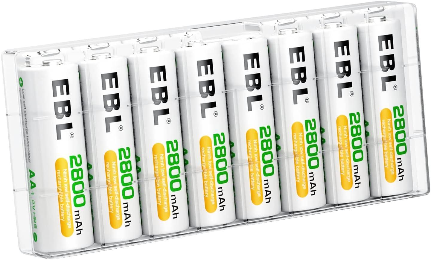

SDsmixer Posted June 6, 2025 Report Posted June 6, 2025 I've been running the EBL's on several films for the past 2 years. Solid performance and have well over 60 currently. I just cycle thru so they don't get overly used. $12 for an 8 pack on Amazon. Quote
