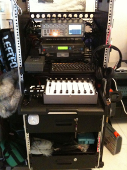

fatfatjames Posted March 16, 2010 Report Posted March 16, 2010 my film cart setup with my brand new looking mix 8 from Mark... Quote
fatfatjames Posted November 14, 2013 Author Report Posted November 14, 2013 Now it look different... Sent from my GT-I9505 using Tapatalk Quote

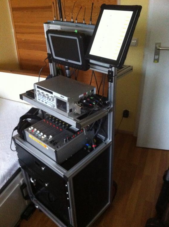

Bacutada Posted January 28, 2014 Report Posted January 28, 2014 This is my self built sound cart, made of alluminium profiles. 19-inch inner wide. weighs without Pelicase Accu prx 25KG. Quote
Soundwil Posted January 28, 2014 Report Posted January 28, 2014 Nice work Bacutada. 19 inch width - good idea. Foldable shelf and drop down top (looks like) - excellent. Simple and effective design. I'm looking to do the same because the aluminium profile is so useful. Is the middle platform held in place with supporting wires? Ah just noticed how you've 'clamped' the Deva to the shelf - good job. Quote

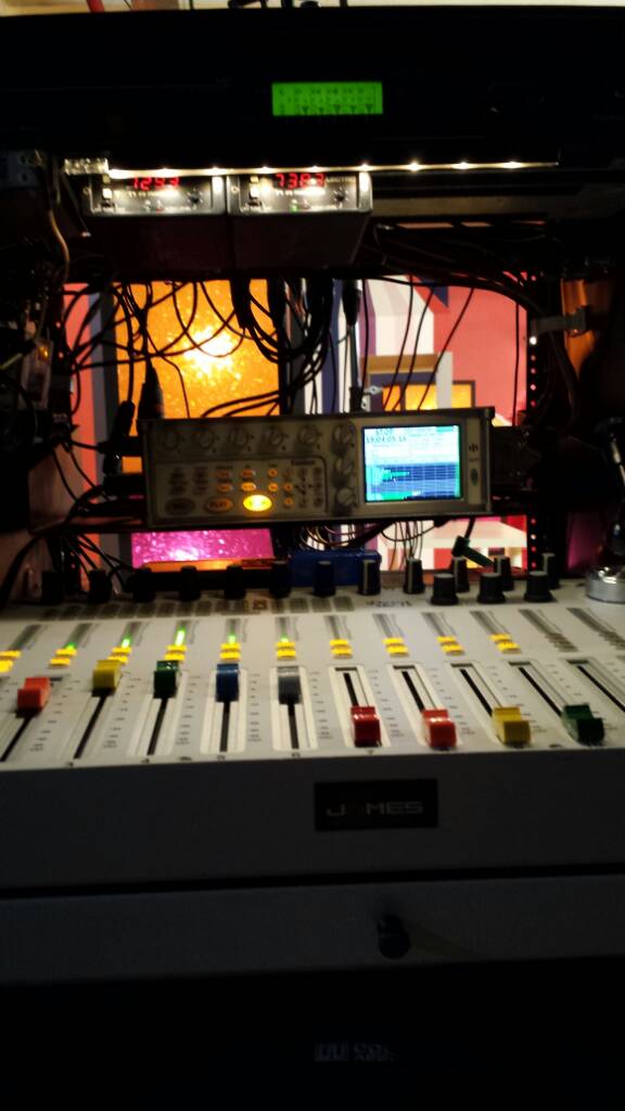

Bacutada Posted January 28, 2014 Report Posted January 28, 2014 The Deva is fixed with 2 aluminium sheets and two screws. One for left, one for rigt side, easy to unlock - see pic 3. The ajustable shelf is fixed by 2 Clamb Screw. You need a half turn with them, to adjust and lock. The wire ist only for safty reason. Quote
pvanstry Posted January 29, 2014 Report Posted January 29, 2014 He Batacuda, great cart, clean and simple. Quick question, i see that the shelf holding the Deva is simply holding by the some sort of swivel mount. Is it really solid? When rolling, is the Deva too Heavy and the shelf goes down? Also can you take a picture of your back wheels arrangement? Thank you Quote
Bacutada Posted January 29, 2014 Report Posted January 29, 2014 Its save for stand and for little movements. For longer distances, I put the cart on the rear axle. (Such as a hand truck). Stairs are not a problem. The Shelf for the Deva is while longer movements fixed horizontally, then it is held by a wire cable too. Quote
