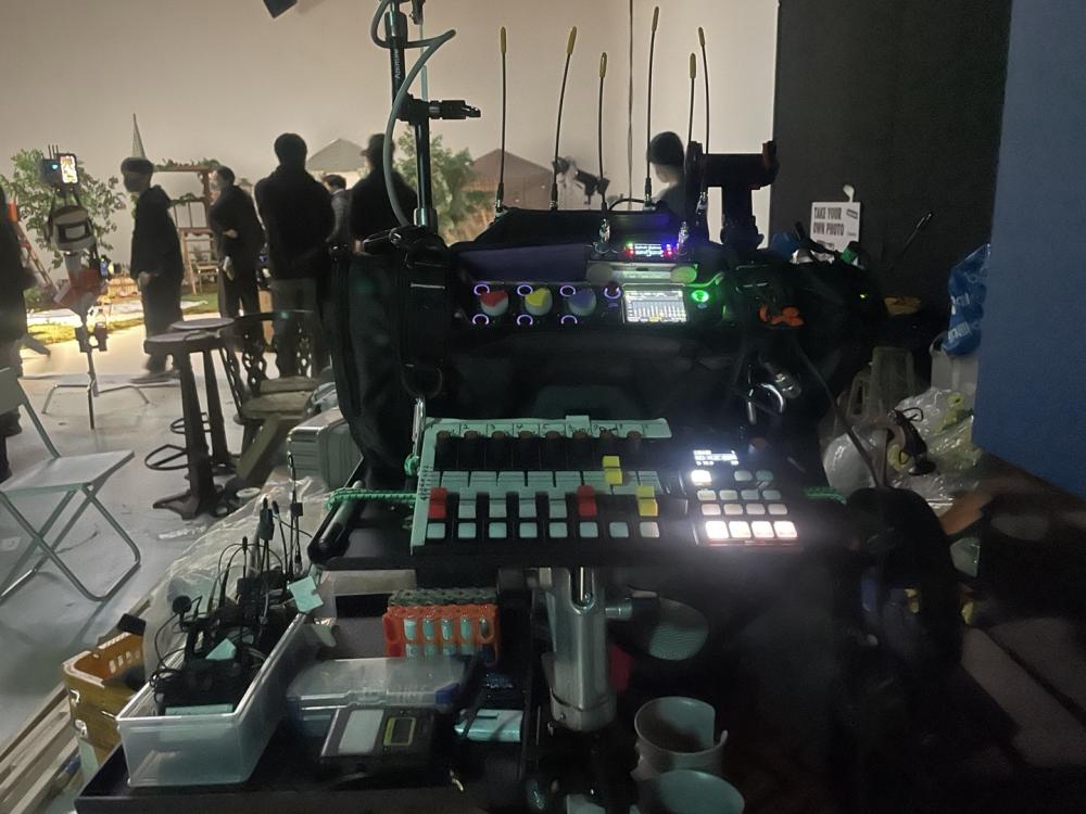

filmsalang Posted January 9 Report Share Posted January 9 833 with Mixface at location. More than 8ch inputs needed, I go with Platform M+. Quote Link to comment Share on other sites More sharing options...
vizualize Posted March 17 Report Share Posted March 17 On 1/9/2023 at 8:18 AM, filmsalang said: 833 with Mixface at location. More than 8ch inputs needed, I go with Platform M+. Hi, where did you get the new faderknobs from, it looks great and better to mix? Quote Link to comment Share on other sites More sharing options...
