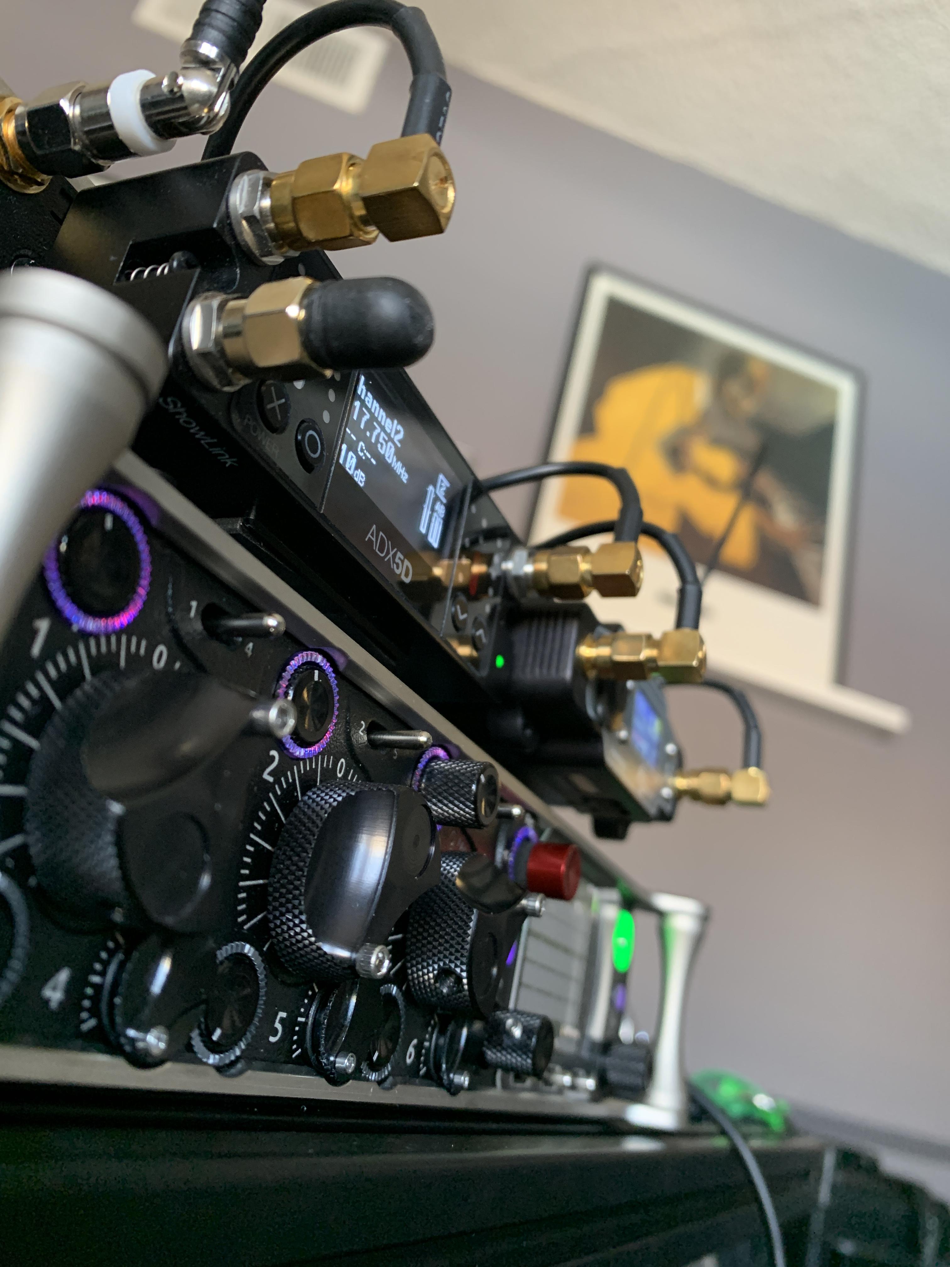

I rented one a week ago and field tested it in a SL2. Using the SL2 antenna distro, it preformed as expected, which is to say pretty well.
It was used in a major metropolitan area, in both D2 & NA hybrid modes.
I did not do a direct comparison to any other lectro rx, but RF stability was good. I own the DCR822 and DSQD and the DSR4 performance was similar to those. To me, the DSR4 feels and operates like a mini DSQD. I like the option to make 2 pairs when you don't need more than a total of 2 rx, the 822 doesn’t do this. Freq scans are quicker as well.
Hard buttons are and color screen are great.  Prefer them over the 822.
I did have an occasional odd boot up anomaly where the DSR4 would output a constant audio whine and do nothing else.  A power cycle was the quick fix.
There is enough to like about the unit and not much not to like.   If you’ve got a handful of lectro transmitters you want to keep in the daily workflow it deserves a look.
pictures show size comparison to other slot rx.
