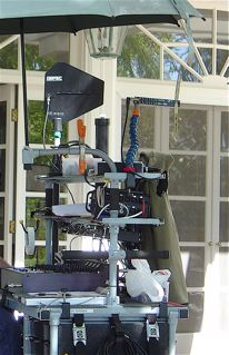

Guest BobD Posted May 31, 2010 Report Share Posted May 31, 2010 This mount easily adjusts 10 different ways...and allows the antennas to simply swing to the middle so it can lie flat in a case...or in any direction sideways or up and down..Very light, and reasonably priced.... http://www.fullcompass.com/product/384555.html One stop shopping too... Manfretto 154B.... It's the sh-t!!!! LOVE it... Oh yeah, that's my flashing OT light in the middle, keeps planes from hitting it as well... Sorry the pic was a crop from a much wider pic... Quote Link to comment Share on other sites More sharing options...

RPSharman Posted May 31, 2010 Report Share Posted May 31, 2010 Brian, After working with, seeing, and using many antenna rigs, I have found this to be the best and least expensive option for me. The antennas are mounted to the last section of a loc-lite Flex Arm (which is an easy self-build). That is, in turn, mounted to the metal bar using the available loc-line mounting section. The metal bar is a support bar for an American Combo Stand with and extra hole drilled in the middle for the baby-pin mounting and pin combo. All the bits were bought from American Grip in Los Angeles (SF Valley). I love being able to easily remote the antennas to a C-Stand, of can even pull one off and mount it to a Flex Arm and clip it somewhere. The above Manfrotto option is similar and very cool too. Quote Link to comment Share on other sites More sharing options...

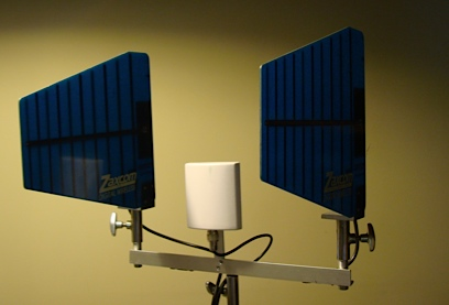

Jeff Wexler Posted June 1, 2010 Report Share Posted June 1, 2010 I built a simple and inexpensive antenna bar out of right angle aluminum stock and 2 baby-pin spuds. The bar now holds 2 log-periodic antennas and 1 2.4 ghz directional antenna for the Zaxcom IFB. - Jeff Wexler Quote Link to comment Share on other sites More sharing options...

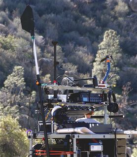

Jan McL Posted June 1, 2010 Report Share Posted June 1, 2010 Really enjoyed this thread. Would love to see more antenna mast solution pictures Will post mine in due course unless there's another thread that would be more appropriate. Vin, I would love to have a picture of what you describe... I too went with the microphone bar, but smaller, mounted to the top of a light weight, light stand "riser" with a cardellini clamp. The "riser" fastens to a 5/8" spud at the bottom, and is cable-tied to the side of the cart in a few places. For the other side, used a heavy-duty grip gooseneck affair that may be easily bent down for sleep. This rig needs finesse. I use WindTek quick releases in the chain for flyouts, the extra males mounted to various 5/8 spud adapter/spring clamps. Bingo. Jeff, how are you liking that 2.4Ghz antenna? Mine's a lot bigger and would LOVE to scale it down... All the best, Jan Quote Link to comment Share on other sites More sharing options...
Jeff Wexler Posted June 2, 2010 Report Share Posted June 2, 2010 Jeff, how are you liking that 2.4Ghz antenna? Mine's a lot bigger and would LOVE to scale it down... Jan I haven't really had a chance to use it on a job yet. Seems to perform well in my limited testing. It specs out as a 10 dbi antenna and is of the corner-directional (not ultra directional) variety with reasonable horizontal and vertical dispersion pattern. I'll have to wait to see if it really works properly on the job. It is considerably smaller than some of the others in use out there but I'm hoping it will perform "big" like the others. - Jeff Wexler Quote Link to comment Share on other sites More sharing options...

Kevin Sorensen Posted June 2, 2010 Report Share Posted June 2, 2010 This what I use. I found an inexpencive fishpole on e-bay, so that the bat wing can be raised fairly high. The dia-pole is on a flex arm w/clamp. Kevin Quote Link to comment Share on other sites More sharing options...

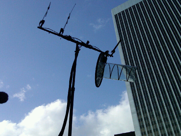

Richard Lightstone, CAS Posted June 2, 2010 Report Share Posted June 2, 2010 OK, I'll jump in. I have the original Remote Audio Antenna Bar on a K-Tek pole that can get my SNA-600's, and or the PWS HA-8089 Hellical and the Remote Audio Comtek 216mHz whips up over 15 feet. RL Quote Link to comment Share on other sites More sharing options...
