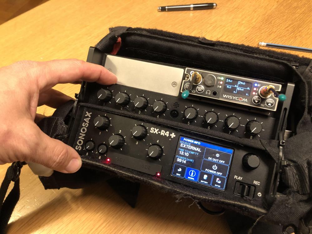

Patrick Tresch Posted March 17 Report Share Posted March 17 Just got mine 😉 everything works like a charm (with beta FW 4.0) I do use a MCR54 in one slot.  The R4+ and the RX8+ with an Audioroot 48wh and a 96wh battery is 3.55 kg (7,8 pounds). 13hours to empty with 4x analog 48v and 8x AES in and 4rx enabled MCR54.      Quote Link to comment Share on other sites More sharing options...

colinmk Posted March 19 Report Share Posted March 19 On 3/17/2023 at 9:32 PM, Patrick Tresch said: Just got mine 😉 everything works like a charm (with beta FW 4.0) I do use a MCR54 in one slot.  The R4+ and the RX8+ with an Audioroot 48wh and a 96wh battery is 3.55 kg (7,8 pounds). 13hours to empty with 4x analog 48v and 8x AES in and 4rx enabled MCR54.        Nice. Is that the portabrace bag and it fits perfectly? Just about to order the RX8 and use for Wisycom too. Quote Link to comment Share on other sites More sharing options...

Patrick Tresch Posted March 19 Author Report Share Posted March 19 12 hours ago, colinmk said:   Nice. Is that the portabrace bag and it fits perfectly? Just about to order the RX8 and use for Wisycom too. It could be a bit wider for the AES multipin out. Mine was a custom made (adapted from r4 bag https://en.vocas.nl/porta-brace-ar-sxr4-audio-recorder-sonosax-sx-r4-black.html ) but the 96wh battery needs a cut out... work in progress.  The important thing with the module is : - either you don't have any mechanical contact between the R4+ and the RX8+ other than the AES/Power cables. - or you use the metal brakets given by Sonosax.  I must admit that ground loops and other electronic interference is something I don't understand nor manage to control. Quote Link to comment Share on other sites More sharing options...
