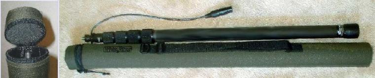

EnotsMedia Posted April 15, 2023 Report Posted April 15, 2023 I fly a lot with gear and it’s not fun. Actually gear or no gear flying isn’t fun. You have to remember that airports (U.S.) are just like the States in which they operate-completely UN-United. Meaning what one airport (TSA) says is okay to carry on another will say the opposite. There is no reason, there is no justification, it just is. If the answer is “No” it’s game over, there is no discussion that will change the outcome. Move along. Over the years I’ve seen some pretty interesting items brought onto a plane that were clearly not allowed but “somehow” there they are. (Btw I have a great idea for a game show called “Will it Fly” if anyone is interested in a pitch!) For carry on only flights, I use a fly fishing rod tube (30” in length I believe) and it’s been “mostly” ok. I’ll give it a 85-90% success rate. No matter how full the overhead bin is it will ALWAYS fit. One key I believe is to not make the tube stand out (IE: DIY / PVC pipe) and this should go without saying- be kind and respectful towards others (as we always should be doing) …especially at the airport. Also make the tube “look” like it’s part of your mixer bag/ carry on somehow, meaning don’t have the tube in one hand and the mixer in the other. With the tube resting on top of the mixer it’s clearly “one” carry on and if asked I NEVER say the word BOOM pole- it’s always a FISHpole…and if pushed …Fishpole….for sound. I know this all sounds so ridiculous but so is the TSA and flying commercial of late. (Fly) Fishing rods have been carried on (in tubes) for many years so they usually don’t raise an eye with TSA / Gate Agents seeing the tubes. I know there’s a variety of boom pole holders/ cases, but this Mfg I found randomly on Amazon of all places, makes custom length cases, and colors - (usually the off the rack fishing rod holders are not the exact length you really want- ) for a very respectable rate. Bonus points, made in the USA. https://mtncork.com I have been toying with the idea of a Peli 1510 for carrying on only shoots and I’d love to see some pics of anyone’s setup like this- with a traveler pole stuffed inside. I don’t think anyone enjoys the smaller traveler boom poles but sometimes it’s the sacrifices we have to make. Sorry for the rant but TSA pre check does nothing for you when traveling with gear. Unless you mean getting to keep your shoes on through security. And now that there’s like 50 different “brands” of “pre check providers” it’s clearly a cash grab. I personally avoid supporting any Pre Check program as it’s an absolute scam in my eyes….. Just my 2¢. Quote

Tim Norris Posted April 16, 2023 Report Posted April 16, 2023 On 4/14/2023 at 10:05 PM, osa said: This is interesting as i had assumed under current flying conditions i was limited to overhead bag 22x14x9 and backpack under seat in front of me and all fitting in those sizes. Is what you may be saying a “fly rod” is the personal item i.e boom pole n mic combo in a longer slim case? Where would they stow such an item? This is interesting as i had never witnessed anything unusual carried on I currently carry onboard the plane my 30# mixer bag (not in a case), a small bag with with all of my lithium batteries, my boom/mic and whatever wearable personal stuff I need. I did not have a problem on any of the six flights I took last year. The boom usually sits on top of the camera and mixer in the overhead bin. I stuff any soft things (jackets) I have in as cushioning. The battery bag fits under the seat back in front of me. The boom can also go in a flight attendants closet or some other place up front in a pinch - mine rode in the cockpit once long ago. Flight attendants are always very helpful when needed. Perhaps I've been lucky. Or it's my smile and disarming nature. Maybe it's a News thing. Cheers, Tim Quote

stef Posted April 22, 2023 Report Posted April 22, 2023 On 4/14/2023 at 9:05 PM, osa said: This is interesting as i had assumed under current flying conditions i was limited to overhead bag 22x14x9 and backpack under seat in front of me and all fitting in those sizes. Is what you may be saying a “fly rod” is the personal item i.e boom pole n mic combo in a longer slim case? Where would they stow such an item? This is interesting as i had never witnessed anything unusual carried on It's certainly easier if your boompole fits in a bag, but no guarantee it'll be allowed. Some things are allowed to be carried on as an extra, like an umbrella. I just carried on a larger boom pole (QP480) in a soft case. Keep the mic separate and packed in a bag. You want the TSA person to think "fly fishing rod" and not "baseball bat". Tell him it's a boom pole, sometimes called a fish pole (and it is), and the closest thing to it in the TSA lists are fishing pole. You can also compare it to an umbrella, which it's about the size of, if size is an issue. Fishing poles and umbrellas are allowed. Just make sure it doesn't "feel" like a baseball bat. (Actually, maybe you do want the mic attached, but remove it and pack in bag before getting on plane.) Also, make sure you don't have any loose batteries. All terminals should be covered, and max 100Wh LI-ion batteries. Don't forget a charger. So if you don't check bags, what are you going to wear? Equipment in a pelican for overhead, recorder in a bag for under seat... are you able to get your recorder into the overhead with all your equipment? Quote
Rick Reineke Posted April 24, 2023 Report Posted April 24, 2023 I have a (Green River?) fly fishing rod case that fits my K-Tek Avalon 100 boom perfectly. I even has a shoulder strap. Quote
