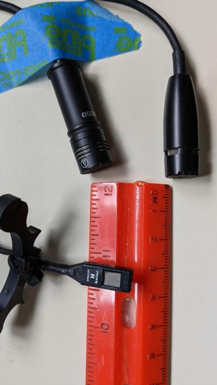

Ira Seigel Posted May 4 Report Share Posted May 4 Recently I was tasked to do a live PA mix for Netflix of a 12-piece string ensemble. In the past, they'd had other engineers use 6 SM-57 on tall booms to mic this orchestra. I decided close-miking for an outdoor venue (a soccer stadium) would be better. I used various mics in my inventory for the task - Audio Technica AT35 and ATM350, DPA4099 and Countryman. All except the DPAs could be considered lavs, with a diameter of 10mm for ATs and 8mm for the Countryman. Because this was an outdoor venue and the performance was getting on sunset, the breeze was significant, and my issue was the uselessness of the foam windscreens for all those mics, including the DPAs, in a windy environment. The foam windscreens are OK in varying degrees for plosives but not for actual wind. In some threads here there is mention of the Bubblebee Windbubbles. These are the only windscreens I can find that are designed for lavs or lav-sized mics. Can anyone comment on the effectiveness of the Windbubbles for this type of application, i.e., close-miking violins, violas, etc with clamp-on or strap-on clips? Thanks very much, Ira Seigel in the Pacific Northwest Quote Link to comment Share on other sites More sharing options...

Ira Seigel Posted May 5 Author Report Share Posted May 5 "Cardioid mics are inherently sensitive to wind (and handling) noise" I did not know this. Thanks for the tip, Rick. I hadn't noticed the Rycotes you mentioned on their website. I'll take a look. Also the Microcats - thanks Syncsound (a fellow Pacific Northwester). Ira Quote Link to comment Share on other sites More sharing options...
