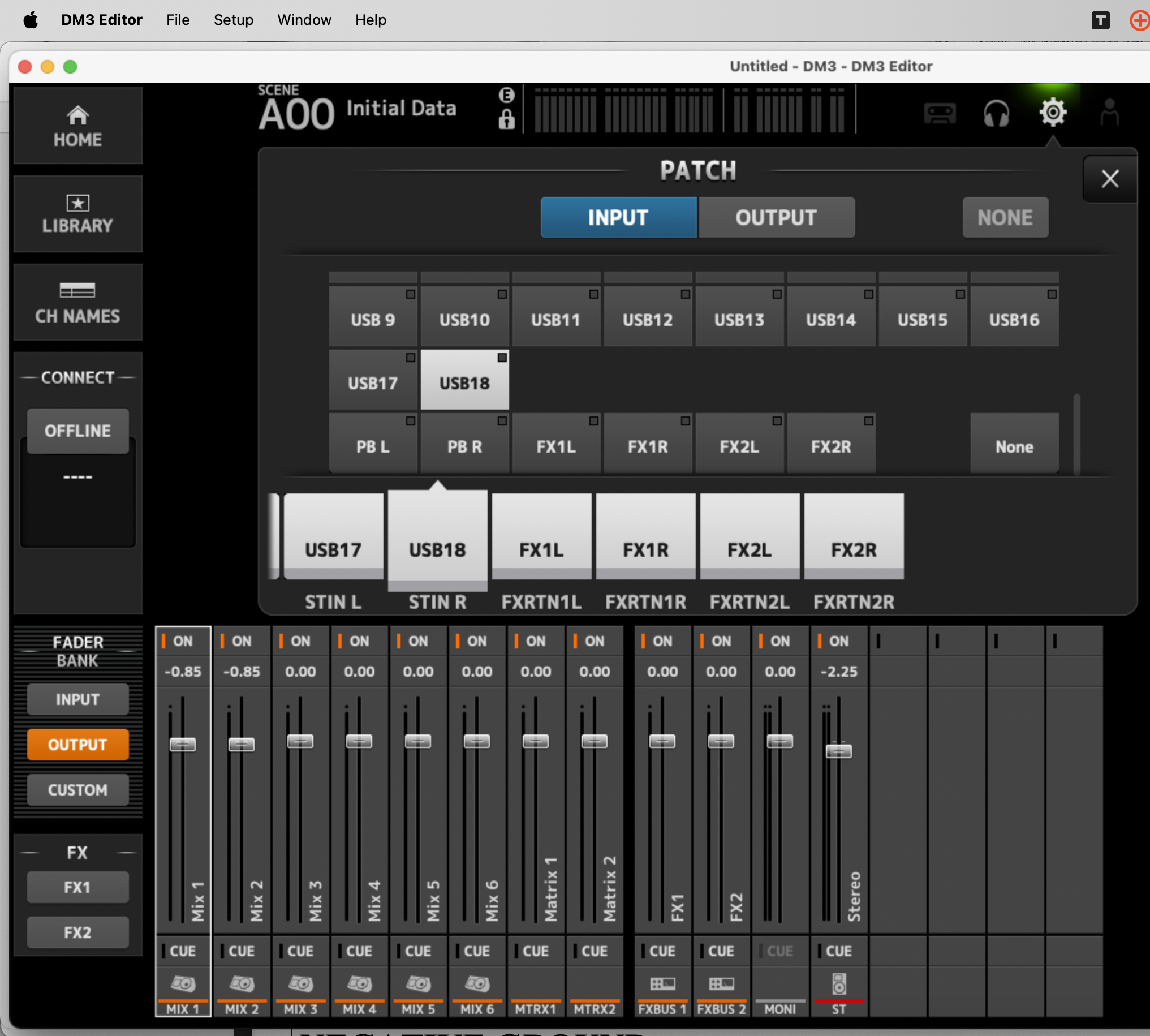

Philip Perkins Posted October 18, 2024 Report Posted October 18, 2024 DM7: what they have instead of CL and QL. Venues I work at with those are looking harder at DM7 than Rivage right now. Those working with DM3 dante or no--are you able to use USB (or Dante) to get input into channels 17-18? Like via a USB interface box? Have you tried making a Mac aggregate device with the DM3 and an interface to ProTools or Boom Recorder or etc? Quote
ramallo Posted October 25, 2024 Report Posted October 25, 2024 On 9/25/2024 at 5:10 AM, LoganSound said: Update: CL and QL were discontinued last week. https://fohonline.com/featured/yamaha-to-discontinue-cl-and-ql-series-consoles/ I'm feel like Cassandra 😅 On 10/18/2023 at 2:39 PM, ramallo said: My complain of this desk is the lack of insertion points (Channel or Bus) or the lack of Dugan automix Update, have insertion points with the last firmware On 10/18/2024 at 9:42 PM, Philip Perkins said: Those working with DM3 dante or no--are you able to use USB (or Dante) to get input into channels 17-18? Like via a USB interface box? Have you tried making a Mac aggregate device with the DM3 and an interface to ProTools or Boom Recorder or etc? You can download the editor for try, also you can use a device such as an AVIO for get these inputs (Dante). I haven't tried aggregated device, why would you want to do that? Quote
ramallo Posted October 25, 2024 Report Posted October 25, 2024 5 hours ago, Philip Perkins said: I'm using a DM3D in an aggregation with other USB interfaces to up the track count into a DAW when I need more than 16 mic channels at once. It is working very well. The DM3D's stereo mix goes to the DAW on USB 17/18 and returns to the DM3D on USB inputs 17/18. I can also do the same USB connections with the DM3D audio connected via Dante and an aggregation with DVS and USB. The editor app works ok but doesn't cover quite all of the functions of the mixer. Note that my use of this system is for location music etc type recording, not regular on-set movie dialog work (so far). I think it's better to keep everything on Dante instead of mixing USB and Dante using add-on devices. I bought the DM3 for the same purpose as you, but I'm using the DM3 for monitoring and I have a Dante sound card as an interface. IMMO with a Yamaha Tio, using its 16 channels direct to the computer, plus the 16ch from the mixer, and inputting both via DVS to the computer would give you 32ch, and you could monitor the Tio's from the DAW you use to the stereo return. By the way, you would still have the Tio in case you want to use it as a snake of the mixer. Quote

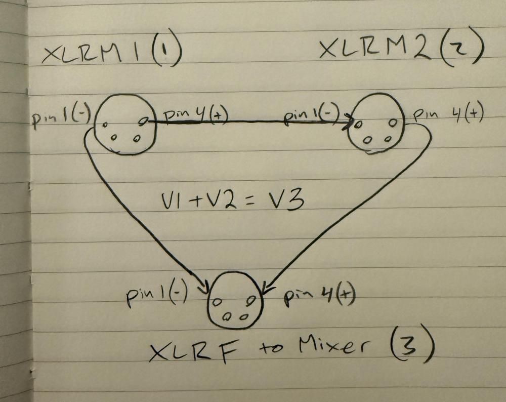

Trey LaCroix CAS Posted December 25, 2024 Report Posted December 25, 2024 I just got one these and love it! It's a rad little mixer. I'm now trying to figure out how to power in my cart. Has anyone built a 12v to 24v step up converter for one these yet? Would love to know a model and wire gauge that works before I start soldering. My electronics knowledge is pretty basic. Quote
Philip Perkins Posted December 26, 2024 Report Posted December 26, 2024 So far DM3D+external 16 chan ADAC+Audinate AVIO (w/ a switch) aggregated on a Mac into Reaper is working quite well. DM3 mix goes to reaper on USB output 17/18, return of Reaper full mix (DM3 + external ADAC channels) on input 17/18. (Thus 32 record channels+mixes.) With Avio as Dante clock leader the sync has been very tight, and Reaper correctly timestamps its files to the incoming TC. I'm quite happy with the sound + headroom of the DM3 (96k!), and even happier with the small size and light weight. Many of our non-video gigs can be managed in 16 channels or less, so then the rig is just the DM3 and a laptop. Quote
Izen Ears Posted December 28, 2024 Report Posted December 28, 2024 On 12/25/2024 at 2:19 PM, Trey LaCroix said: I just got one these and love it! It's a rad little mixer. I'm now trying to figure out how to power in my cart. Has anyone built a 12v to 24v step up converter for one these yet? Would love to know a model and wire gauge that works before I start soldering. My electronics knowledge is pretty basic. Make an adaptor cable - 2x XLR4M to 1x XLR4F. Join them hot to hot and ground to ground. Then plug into two 12 volt outputs and voila, the output is 24 volts! EDIT - oops I got that backwards sorry! Thanks for the corrections! Quote
Matthias Richter Posted December 28, 2024 Report Posted December 28, 2024 that would be 2x 12V parallel - still 12V. You want 2x12V seriell. Quote
Jim Rillie Posted December 28, 2024 Report Posted December 28, 2024 Sounds like 12v parallel. For 24v they would need to be in series. Quote

Wyatt Tuzo Posted December 28, 2024 Report Posted December 28, 2024 Sorry to pile on, but yeah Trey, you actually want series wiring. See diagram below. I would double check the DC powering range of the Yamaha, as, if your cart psu is actually outputting 14.5v (for example), you're now looking at 29v at the board. This is probably well within spec, but it doesn't hurt to look into it first Quote

Izen Ears Posted December 29, 2024 Report Posted December 29, 2024 Thank you all for the correction, der! Quote
