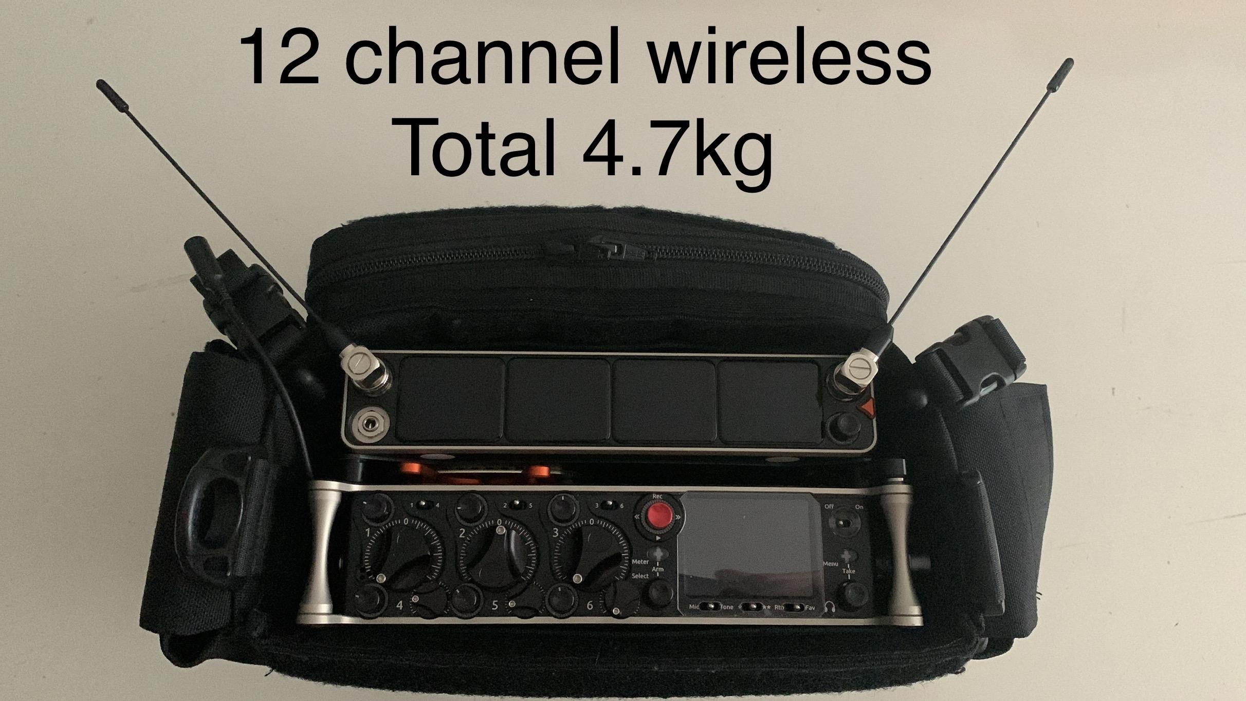

Lachlan Coles Posted July 28, 2023 Report Posted July 28, 2023 20 hours ago, Shane Munro said: I’m very impressed with the range I get with the Nexus. What antennas are you using for your Nexus system Shane? Powered or unpowered and are you using the standard or long-range modulation mode? Quote
Shane Munro Posted July 28, 2023 Author Report Posted July 28, 2023 Hi Lachlan I'm using 2 x Wisycom ADFA's At the moment I'm running them at Long Range. I have attached a photo to show the support Sound Devices gives Wisycom. Hope that helps. Quote
