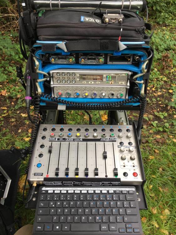

Sebi Posted November 1 Report Share Posted November 1 Hey everybody, I was just thinking about a small issue I come across almost everyday while shooting with my 788/CL-9 Setup. Every now and then, let's say 2 out of 5 times, the CL-9 doesn't power up when I turn on the recorder. So no LEDs, faders and knobs don't do anything. It is connected though because when I unplug the USB cable, it says that the CL-9 got disconnected. When I plug the USB in again, it usually works fine. Sometimes I have to do it twice and sometimes the CL-9 mutes all the outputs after booting. I don't think it's a flaw that only my setup has because I had the same issue last year on a different 788 with a different CL-9. Since I'm pretty sure many of you have used this same setup over the past years I thought I might reach out and ask if some of you have made this experience. Best wishes Quote Link to comment Share on other sites More sharing options...

Sebi Posted November 6 Author Report Share Posted November 6 Thanks for the replies. Yes, I've tested several USB-Cables. But actually I think I found the culprit which seems to be the USB-Keyboard. On friday, when I came across the issue again I unplugged the keyboard and the CL-9 came to live. Plugging in the keyboard again didn't cause any problem. I started the setup several times without the keyboard and everything seems to work fine. Didn't have the time to check other keyboards and since the one I have is the smallest cable-version I could find, I think I will stick with it and work around the problem. Quote Link to comment Share on other sites More sharing options...

Sebi Posted November 7 Author Report Share Posted November 7 It's a pretty cheap one from a brand called mediarange. Pretty simple keyboard without the num-pad extension. But it doesn't live in a bag, I use it on my cart. Since the shelf of the Mini-Cart isn't big enough for the CL-9 plus keyboard I actually used velcro and have a "transport position" and a "work position". What seemed to be a quick and dirty solution works pretty well actually. Quote Link to comment Share on other sites More sharing options...
The Documentary Sound Guy Posted November 7 Report Share Posted November 7 Thanks! Still too big for a bag I think ... I've been looking at thumb keyboard intended for gaming, but they are all bluetooth-based... Nice setup though! If I was on a cart, I'd give it a look. Quote Link to comment Share on other sites More sharing options...
Ontariosound Posted November 10 Report Share Posted November 10 Sebi, I see that your receivers are resting right on top of the 788T. Do you have any RF spray issues ? Do you have metal shielding fabric under the receivers ? I run my bag with the 788T on bottom and CL8 on top, then the receivers on top of the CL8 to provide space. We know that the 788T had less RF spray than the 744T, but there is still some spray. Quote Link to comment Share on other sites More sharing options...

Sebi Posted November 12 Author Report Share Posted November 12 On 11/10/2023 at 7:20 PM, Ontariosound said: Sebi, I see that your receivers are resting right on top of the 788T. Do you have any RF spray issues ? Do you have metal shielding fabric under the receivers ? I run my bag with the 788T on bottom and CL8 on top, then the receivers on top of the CL8 to provide space. We know that the 788T had less RF spray than the 744T, but there is still some spray. Yeah I'm aware but it works fine for me in this setup. I decided to put the 788 on top so I can hide the battery for the recorder and sixpack under the CL-8 and make it accessible from the front of the bag. When using sharkfin antennas mounted on the antenna riser of the cart, which is what I do in this setup, I didn't get any RF hits from the recorder when testing it so I stuck with it. Might be a problem though when running the receivers on the whip antennas. Had to go for bag work once every few weeks and as far as I remember I didn't have to deal with unexpected RF noise. Range was way shorter ofc with the Shure UA8 antennas compared to the shark fins on the antenna riser. Does anybody know if the harddrive makes a difference in RF spray? My 788 has been upgraded to an SSD and I could imagine that and HDD might emit some more electro-magnetic spray. But I'm just guessing. On 11/11/2023 at 4:47 AM, noises1 said: SD only recommend 2 keyboards - an A4tech & something else. I've found 788 is very particular about keyboards - my guess is that the 788 is fussy about the keyboard encoder. Remember that the 788 firmware is now 11+ years old & was always "buggy". I did find an A4tech keyboard in UK on ebay Might be. I didn't bother to find the recommended one tbh. Except for the issue that led me to open up this thread the keyboard is working just fine and I'm using it extensively with shortcuts programmed for almost every function. Quote Link to comment Share on other sites More sharing options...
