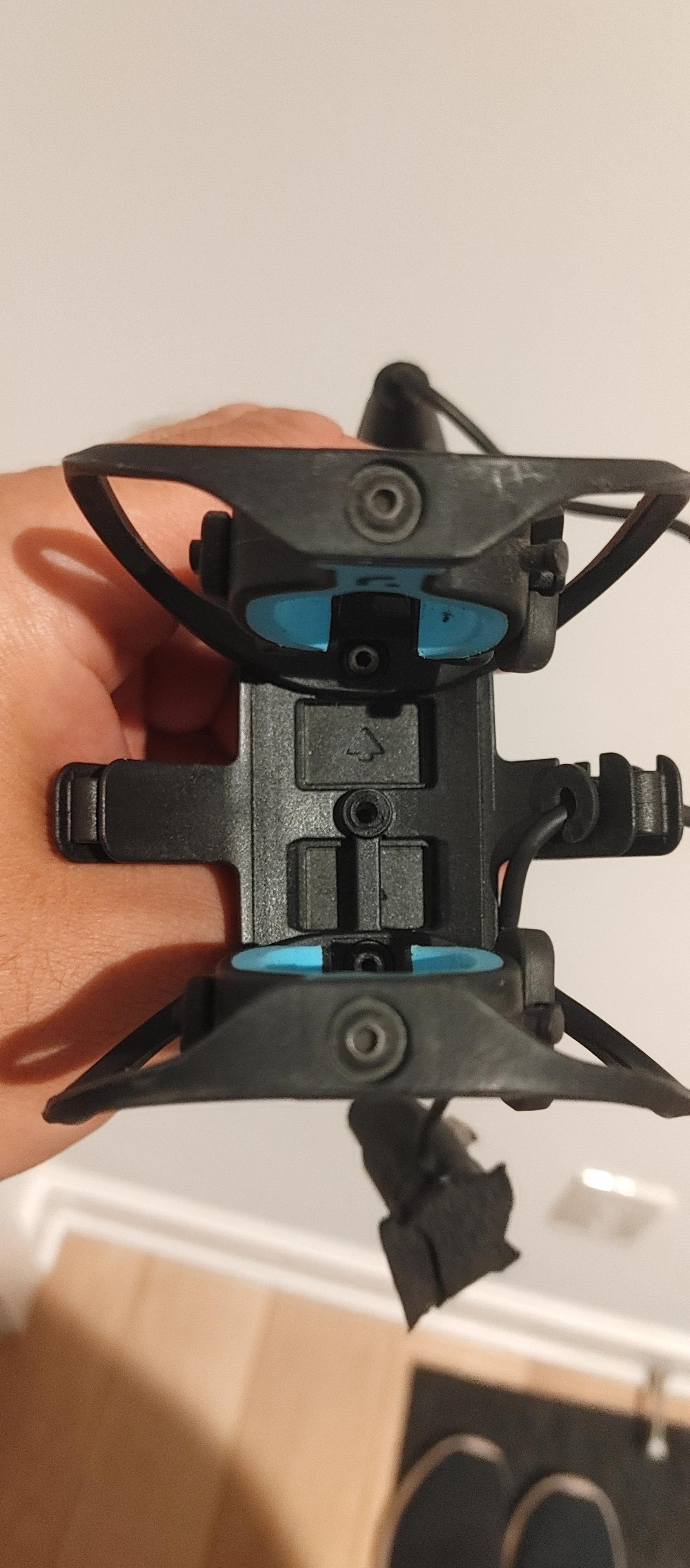

r.paterson Posted January 21, 2024 Report Posted January 21, 2024 3 hours ago, Derek H said: Thanks Roland, I remember your article now. I think your assessment is fair that it comes down to the more boom centric features such as the XLR clamp and ratcheting adjustments. Both are features I really like about the Cinela mounts. Myself and most other boom ops I work with are mounting a plug on transmitter at the shock mount end of the pole so to use a standard Invision 7 mount I need to first add an XLR holder (I like the simple aluminum one from Ambient) and a short XLR so the cost difference between Rycote and the RAD-1 becomes a moot point. I wonder if using an MKH50 in one of these deforms the cable clips? I’ve found that once I’ve used a 50 in a Rycote mount for a while the clips get stretched and it’s no longer useable for smaller diameter mics. Hi Derek, the Radius mounts work very well as interior, I've an issue when adding a bubblebee Windkiller on some mics the "Droop" that being said it's longer mics like cs3e, I don't use the radius for my mkh50 as the clip not perfect. However Radius are in the process of making an mkh50 specific clip mount. The new proto type windshield lt looks very good. So does the quick release boom mount look great.. Both being released soonish ie spring time, if you use FB Radius have their own private page with videos of the prototypes etc.. I wouldn't go back to rycote now radius are definetly on the right track.. Quote

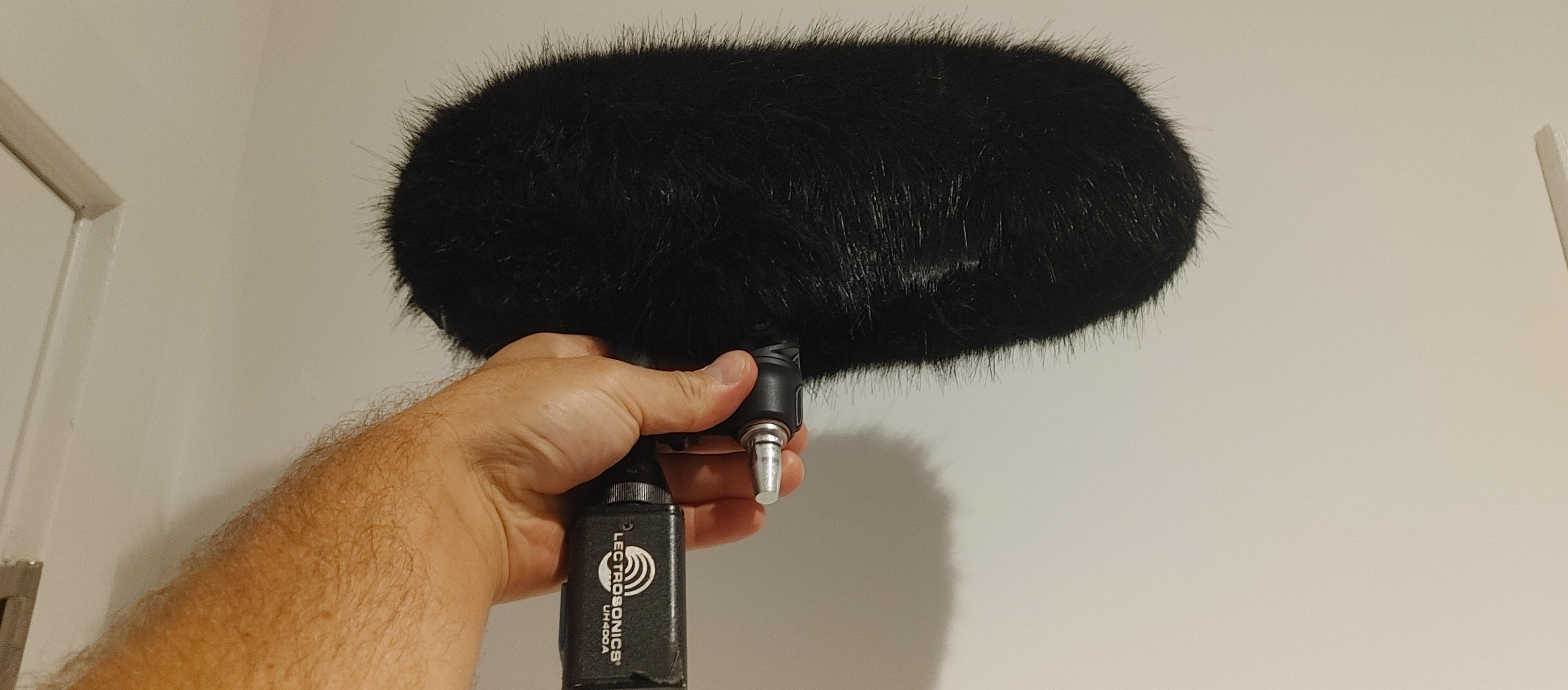

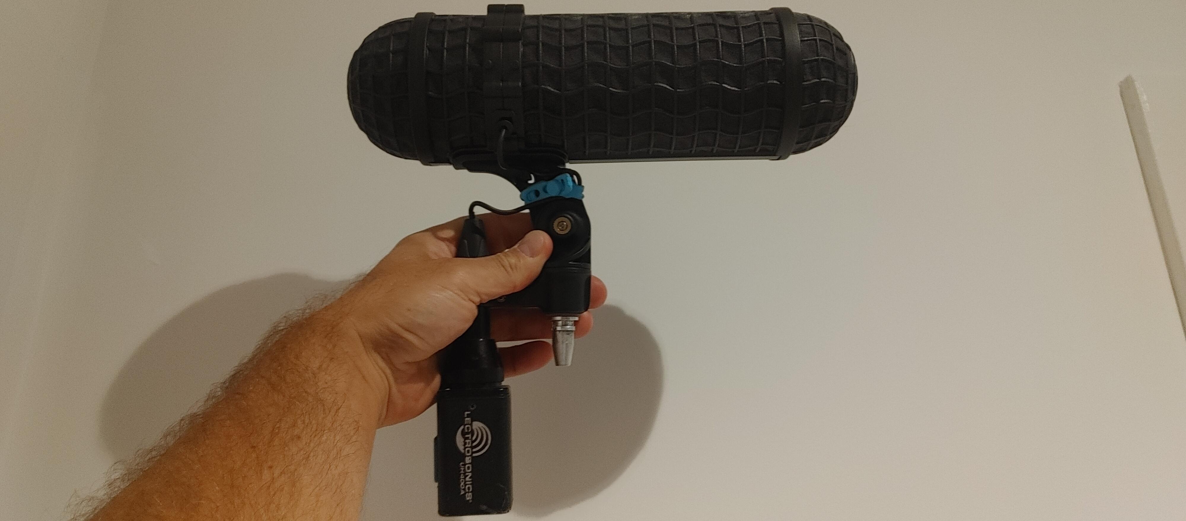

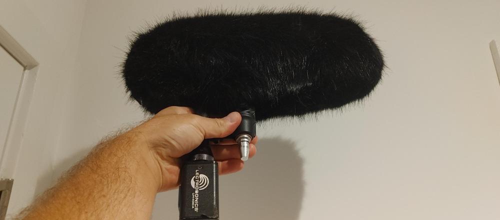

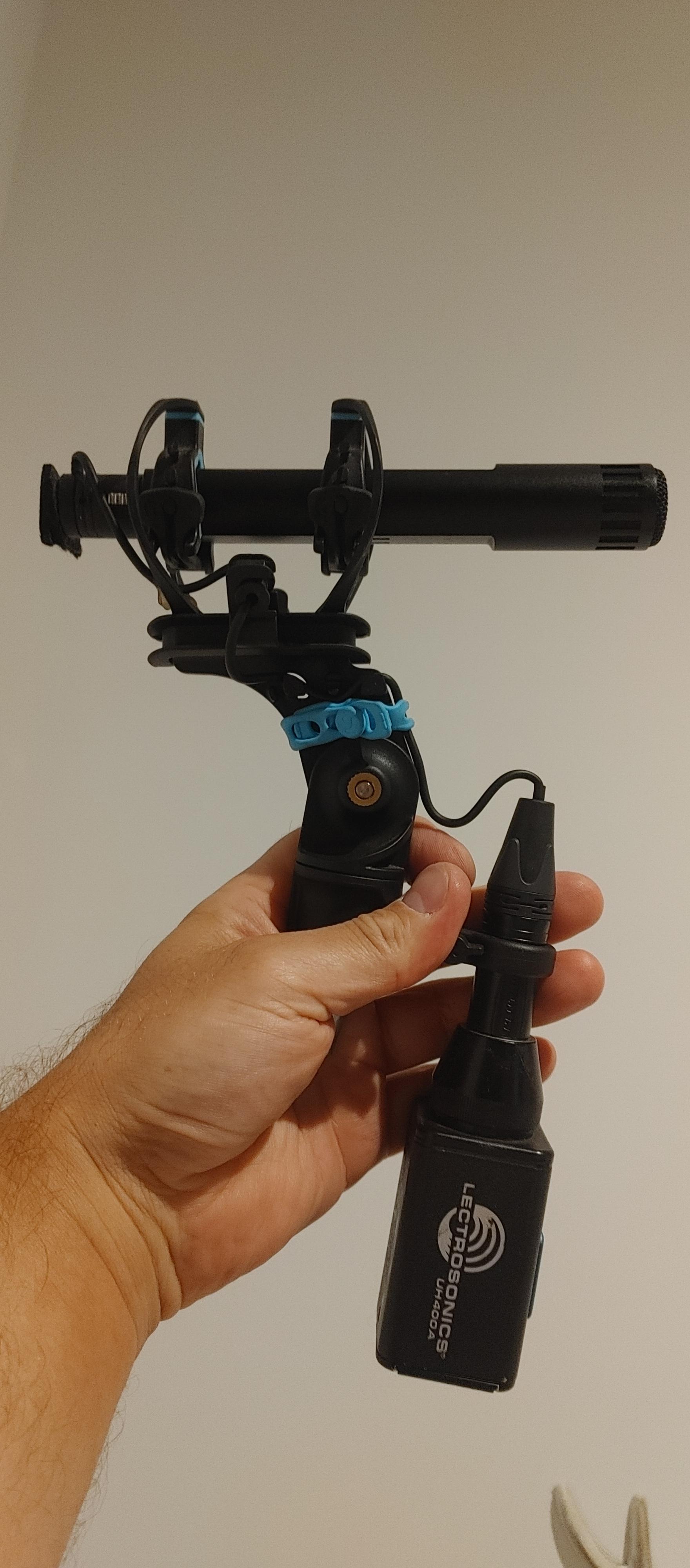

Kirill Belousov Posted July 25, 2025 Report Posted July 25, 2025 I've been using Radius for the past 2 TV shows. And personally I really love the quality and well thought design. Only thing I'll ask mixer to upgrade default lyres work the MKH50 specific ones, sonce they are available now. We are currently using an outdoor blimp as well for the past 4 weeks of the first block. Personally I love the way the magnets are holding two halves of the blimp together. There is very good design for the XLR cable outlet from the blimp. I love the way sock is designed and clicks tightly together over the blimp. Make sure you connect all parts together properly, not backward. Otherwise sock is a bit harder to put on. So far I really love this mount. Also I love that I can strip the mic literally in moments from outdoor mode to indoor mode. Only thing we need to get is a MKH50 lyres to make it even more better. I didn't like how the default lyres handle a "speed ball" with the fir on it. It seem to tilt fron of the mic left and right under the combined weight. Hopefully MKH50 lyres are tougher and won't tilt after the change. Otherwise great company making great tools for pro boom ops. I'm looking forward to what else they'll come up with in the future. Quote

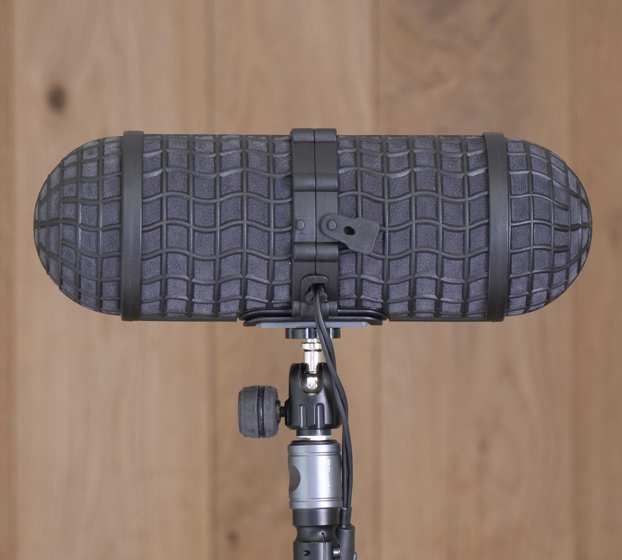

Derek H Posted July 25, 2025 Author Report Posted July 25, 2025 I agree. They are very solid and well thought out. Not perfect of course and there’s a few things I’d like to see addressed. For example, I don’t like the backward ‘sweep’ of the central column. In my opinion this throws the balance off when operating and the mic wants to flop left or right. Some have suggested to flip the whole thing around but then you have the opposite problem and it’s very forward heavy. In my opinion there shouldn’t be a sweep-back at all and the central column should just attach to the shock mount straight-on like a PSC universal mount does. I’m also eager to see what they do for a full-sized windshield. Hopefully their design will allow for more adjustment of mic position to allow for a more tuned balance. It’s a tough problem to tackle and it’s easy to understand why Cinela’s solution is to dedicate every model to a single microphone. I think a more universal design can be done but it’s obviously challenging. Quote
Roland Harris Posted July 25, 2025 Report Posted July 25, 2025 33 minutes ago, Derek H said: In my opinion there shouldn’t be a sweep-back at all and the central column should just attach to the shock mount straight-on like a PSC universal mount does. Like this?! Cheers, Roland Quote
Derek H Posted July 25, 2025 Author Report Posted July 25, 2025 Yes!!! Ok I’m copying your homework from now on. Thanks Roland Quote
Derek H Posted July 25, 2025 Author Report Posted July 25, 2025 Roland, what exactly am I looking at here? Custom made base plate? Quote
Roland Harris Posted July 25, 2025 Report Posted July 25, 2025 3 hours ago, Derek H said: Roland, what exactly am I looking at here? Custom made base plate? Yes. It was very simple to make, and the impetus came from fitting an ORTF pair into a Mini-ALTO: the normal base was oriented 90 degrees out of course - tilting ORTF side to side isn't much use! There's a link to the (freely available) model for the base adapter at the end of this blog-post (itself the third part on the subject of ORTF in a Mini-ALTO): https://drbadphil.com/ortf-in-a-mini-alto-part-3-which-mics-fit Cheers, Roland Quote
