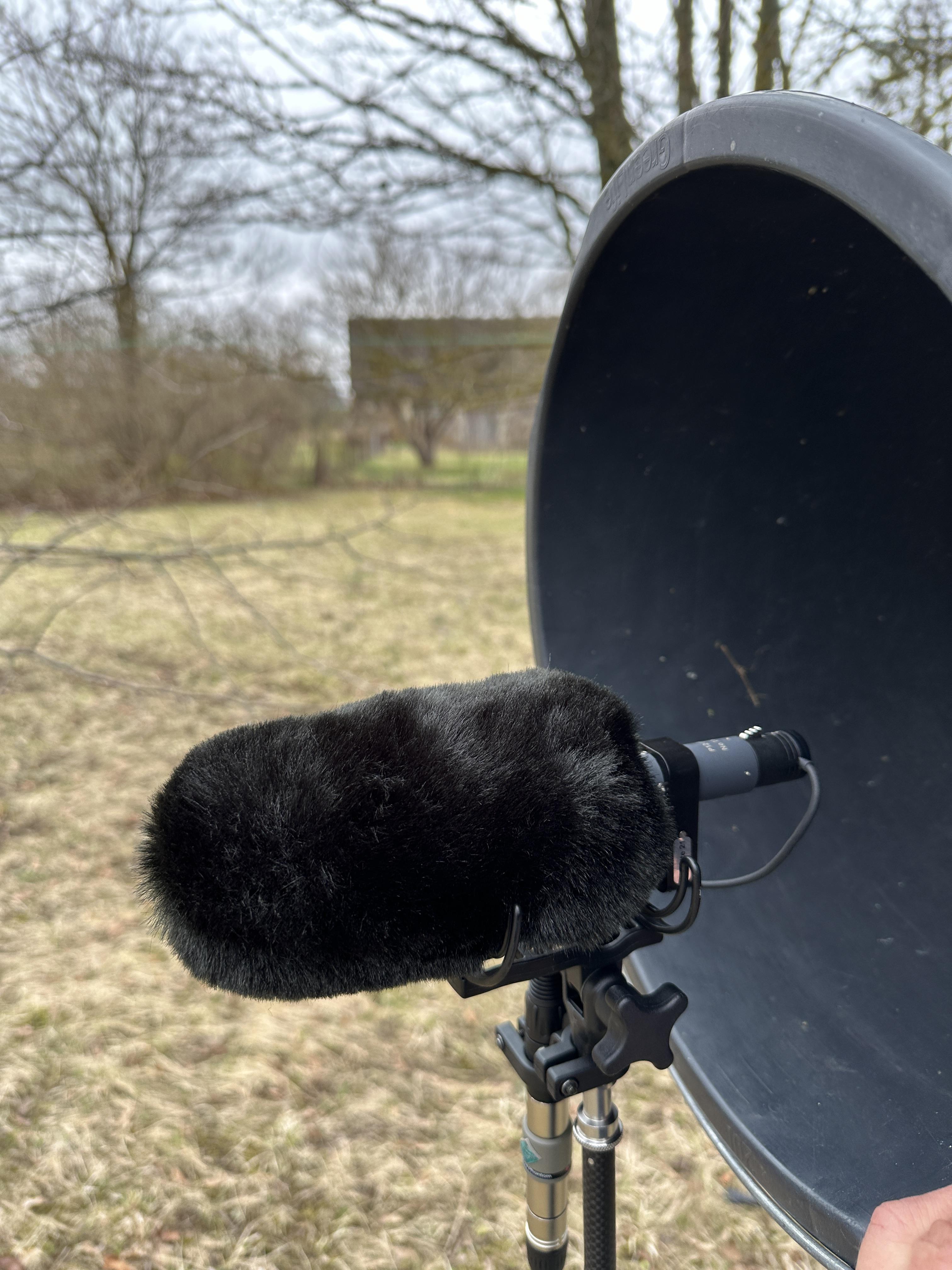

inspire Posted April 15, 2024 Author Report Posted April 15, 2024 (edited) I got some experience and the biggest problem seems now wind. Also I specified what I had never before looked that with Portacapture X8: LOW INPUT GAIN +0.0dB...+35.0 dB HIGH INPUT GAIN +22.0dB...+57.0dB And with FetHead I can deliver now on Low input gain. Bees, when I put microphone in the hive, I get a pretty good result. I also got a few flies in the room nicely (bluebottles - so in English?). Over me, a geese raft flew, which otherwise was promisingly received, but because the wind was enough strong, the result was bad. PIANISSIMO PIANI-1 needed, I don't know if this would help? Edited April 15, 2024 by inspire Additional information added Quote
DHB Posted April 16, 2024 Report Posted April 16, 2024 If that 2nd picture is your mic in front of a parabolic dish, then your mic is the wrong way round! (The mic should point INTO the dish, at the 'focal point' of the dish ..where the dish focuses the sound. Put your head in front of the dish, with one ear pointing into the dish, then move your head towards, into, and away from the dish until you hear the LOUDEST sound, then put the mic inside the dish (using an arm on your mic stand) until the HEAD of the mic is at the exact same point where your own ear was, then slide the mic in and out of the dish slightly until you hear in your cans the strongest, loudest sound. That's the 'focal point' of the dish, and that's where your mic should be, pointing ..INTO the dish. Quote
DHB Posted April 16, 2024 Report Posted April 16, 2024 Here's a picture - courtesy of B&H - showing a mic pointing INTO the centre of a parabolic dish, where the dish focuses the audio.. That's how the mic catches the focused audio ..pointing INTO the dish. Quote
inspire Posted April 16, 2024 Author Report Posted April 16, 2024 Thank you for the teaching that was good, but it was a common bucket with which I tried to prevent the wind from blowing behind. I have also a plan for parabolic dish since I have several SAT-TV dishes, I can try with some. But it is rather a test and not a serious thing. But yes, the wind is a big problem especially if I want to use a higher stative and height. Parabolic Microphones and Specialized Equipment: https://www.wildtronics.com https://www.telinga.com Quote
DHB Posted April 16, 2024 Report Posted April 16, 2024 Try a proper Rycote 'zeppelin' with a full size 'dead cat' furry cover over it. Your mic needs to be properly isolated within an area of still air, then it shouldn't be affected. Quote
Werner Althaus Posted April 16, 2024 Report Posted April 16, 2024 2 hours ago, inspire said: Thank you for the teaching that was good, but it was a common bucket with which I tried to prevent the wind from blowing behind. I'd advise against putting anything at the 180 degree spot/ back of the microphone, especially a bucket which is a very non-linear sound collector of sorts, especially when agitated with wind. The common misconception is that directional mics have a null at 180 degrees or various other angles , depending on the polar pattern. In practice microphones, especially shotgun microphones hardly ever have textbook patterns across the entire frequency range. Schoeps is probably the best at achieving as close as possible a textbook pattern but one quick look at the graph of the MiniCmit shows that at lower frequencies you have a significant rear lobe, meaning that this mic hears a lot of what's going on in the lower mids and bass behind the mic . 500 Hz is only down 8 dB and 250 Hz is only down 7 dB from its on-axis response. It is very important to consider what is happening "behind" the mic. Quote
inspire Posted April 17, 2024 Author Report Posted April 17, 2024 It wasn't a good solution this time and I didn't have a better one available, so I tried with the tools at hand. Your explanations are certainly very informative, thank you! I also tried it as shown in the attached picture, but there were reverberations and unnatural distortions. We had significant wind those days! By the way, I now understand why Rycote 'zeppelin' is such a shape, consisting of a cylinder whose ends are hemisphere. Quote

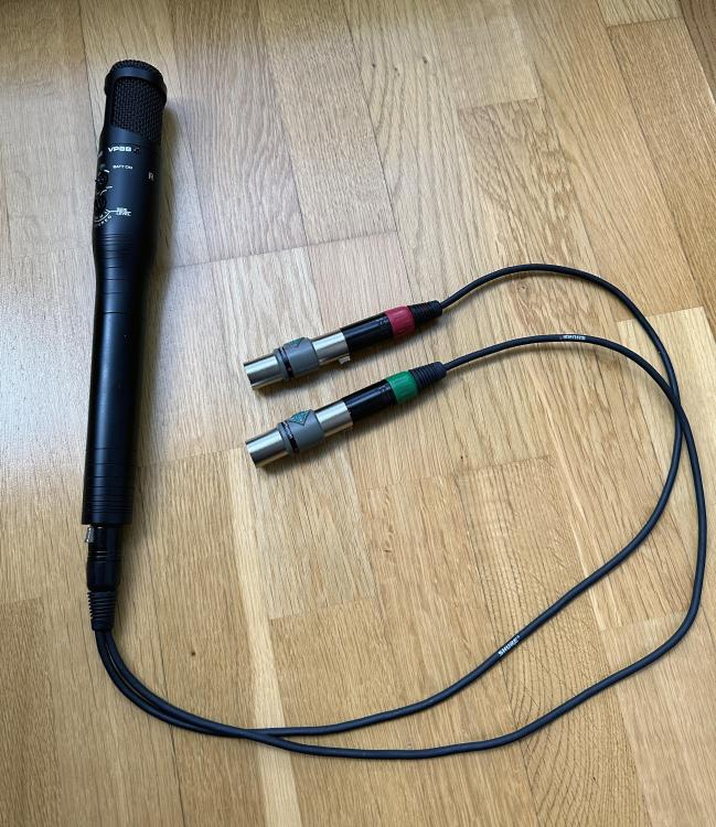

inspire Posted April 20, 2024 Author Report Posted April 20, 2024 Yesterday the second Fethead arrived as well, and I will be able to test them soon. I'll add a picture with the VP88 microphone. I asked just in case from Triton Audio, if it is OK using two Fetheads in the same chain? (for the future tests with shotgun) Max answered me: "We haven’t tested this, but it will probably work. You can’t break anything. The impedances are not optimal when stacking FetHead Phantoms, so you will likely not get a double amount of gain." Quote
DHB Posted April 20, 2024 Report Posted April 20, 2024 Looks good ..do tell us if it achieved what you wanted. Quote

tourtelot Posted April 27, 2024 Report Posted April 27, 2024 Are the FETHeads adding any electronic noise to your recordings? I found them un-usable for recording acoustic music with ribbons because of the high levels of self-noise. D. Quote
inspire Posted April 27, 2024 Author Report Posted April 27, 2024 The only thing I wasn't satisfied with is the wind and its effects. I wonder if PIANISSIMO PIANI-1 would help with that? Two pieces in one chain are working, but I don't see the point in that - I tried it already and I can assure you that at least I can't get any effect on that. Quote

inspire Posted April 28, 2024 Author Report Posted April 28, 2024 Here are more examples, made with the FetHeads at my home window. I'll answer the question about electronic noise: no, I didn't notice any. Here, you can hear the street noise and everything else. Perhaps the VP88 itself is humming when you listen to it for comparison. I'm actually very grateful for the recommendation to use the FetHead, and I intend to use it in various situations. I was interested in long-distance recording, but close objects also seem interesting with it. It adds new possibilities for me to discover. They are easy to add or remove from the chain. They don't ask for much, are lightweight, and not too expensive either. I'm quite happy with them. The next major test will be in Matsalu National Park, and I really hope there won't be any wind that day because I currently don't have good equipment for wind. Edit: I deleted the files, as this is an old matter by now, and I do not keep them on my server any longer! 240426_0110_3.wav 2024-04-26 15:41 Schoeps MiniCMIT GR, two FetHeads in a chain 240426_0111_3.wav 2024-04-26 15:43 Schoeps MiniCMIT GR, two FetHeads in a chain but with more gain 240426_0112_3.wav 2024-04-26 15:44 The same, but the microphone is pointed towards the sky! At the same time, there were some pedestrians passing by and children's voices could be heard. They were about 50 to 60 meters away, completely in the periphery. Additionally, the neighbor boy's moped can be heard behind the house. 240426_0113_3.wav 2024-04-26 15:46 The same, but the microphone is pointed downwards. 240426_0114_3-4.wav 2024-04-26 16:00 With the VP88 stereo microphone, more gain. 240426_0115_3-4.wav 2024-04-26 16:01 With the VP88 stereo microphone, less gain. 240426_0116_3-4.wav 2024-04-26 16:03 With the VP88 stereo microphone, I myself just a stupid text intro in the window in front of the microphone. Quote
inspire Posted April 28, 2024 Author Report Posted April 28, 2024 DHB, you are correct that the first recordings were made using only the Schoeps MiniCMIT because the second FetHead arrived to me later. There is no processing applied to any of the recordings to enhance them in any way. This is to ensure a fair comparison. In the first batch, I have only made cuts. Of course, I could mitigate the shortcomings using various plugins in post-processing, but I did not do so. Quote
DHB Posted April 28, 2024 Report Posted April 28, 2024 The last one - your speaking at the window - sounds great; really shows what you get with the VP-88. The birdsong (..2nd file: 240426_0111_3.wav..) would be really great if you pointed that MiniCMIT into a dish! ..that's if you particularly wanted to capture the birdsong. A dish would get rid of all the general background street noise 'mush'. Similarly, if you want to capture animals at a distance, a dish would remove general background mush, and would bring the distant sounds - which you aim the dish at - 'closer' and louder without introducing electronic amplification 'noise'. But those Fetheads don't seem to bring in any additional electronic noise ..none that I can hear, and can't detect without an oscilloscope, or without examining the waveforms. I'd say they're a great success! Quote
