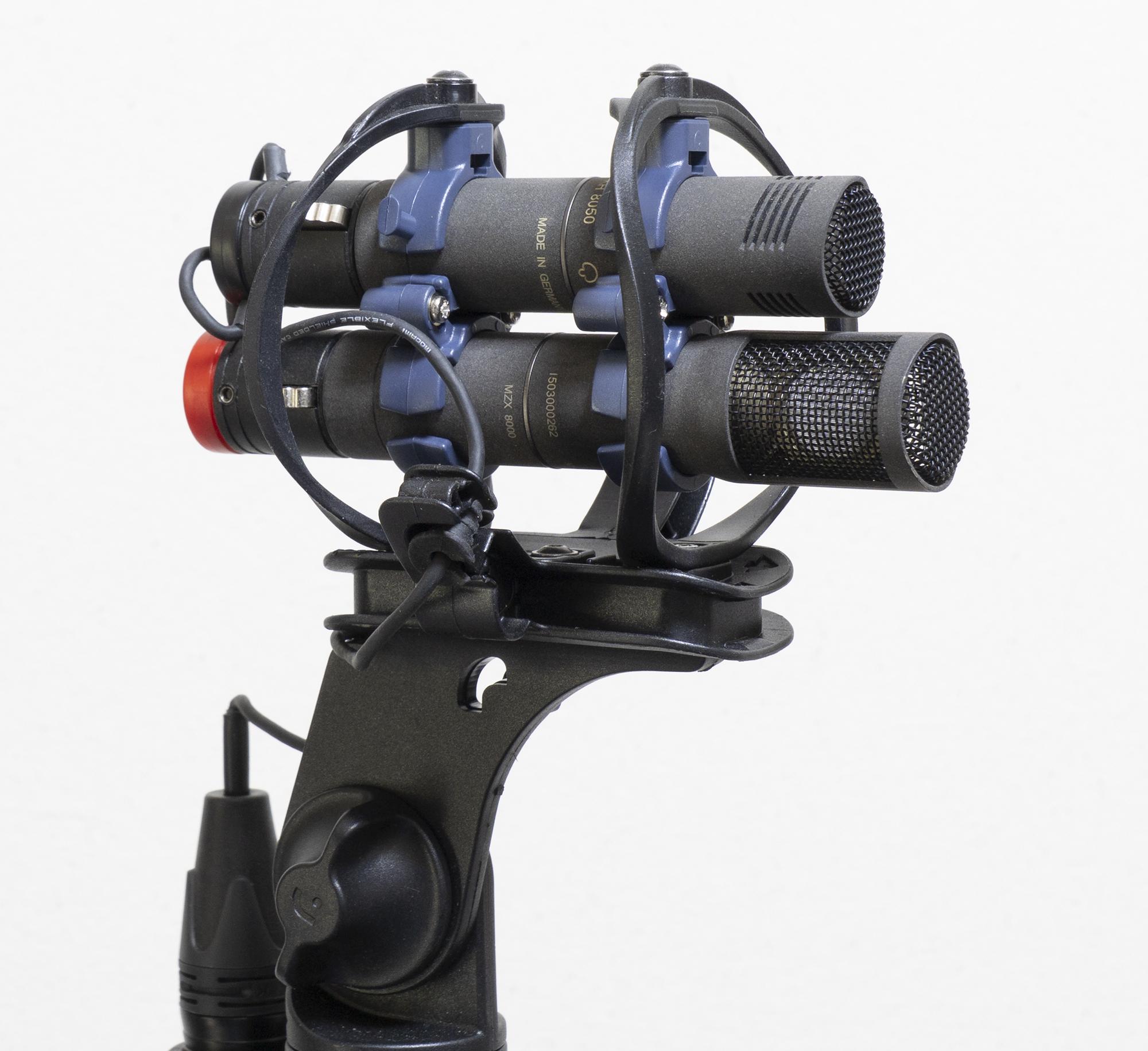

Roland Harris Posted June 29, 2025 Report Posted June 29, 2025 And just to add that Radius have now got their injection-moulded clips (19mm and 20mm versions) into production. I received a pair of the 19mm ones the other day (photos below showing with and without the rubber straps): happy to make my 3d-printed ones redundant! Cheers, Roland Quote
The Documentary Sound Guy Posted June 30, 2025 Report Posted June 30, 2025 Very nice. Looks like a very full zeppelin. My MS setup is the original diameter MKH series, and I suspect they'd be too big to fit. Have they also created a DMS clip? Quote

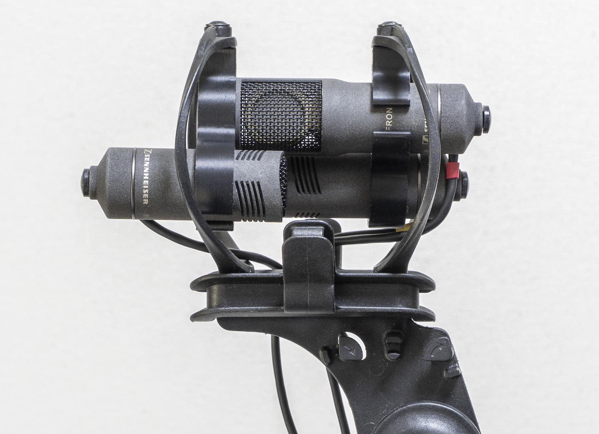

Roland Harris Posted June 30, 2025 Report Posted June 30, 2025 1 hour ago, The Documentary Sound Guy said: Very nice. Looks like a very full zeppelin. My MS setup is the original diameter MKH series, and I suspect they'd be too big to fit. Have they also created a DMS clip? Yes, the MKH 30 + MKH20/40/50 etc. MS pairs are too large for the RAD-2 hoops and Mini-ALTO: though the upcoming ALTO should work for them. No DMS clip for the Mini-ALTO yet. I have designed and 3d-printed a couple of DMS options for the RAD-2 hoops (photo of one below), which work fine, but, to be honest, aren't ideal in a Mini-ALTO: unlike with MS, with DMS the fig 8 needs to be between the pair of hoops and, consequently, its sideways facing lobes face the chunky pair of plastic rings where the two windshield halves (pods) join - not good. Cheers, Roland Quote
