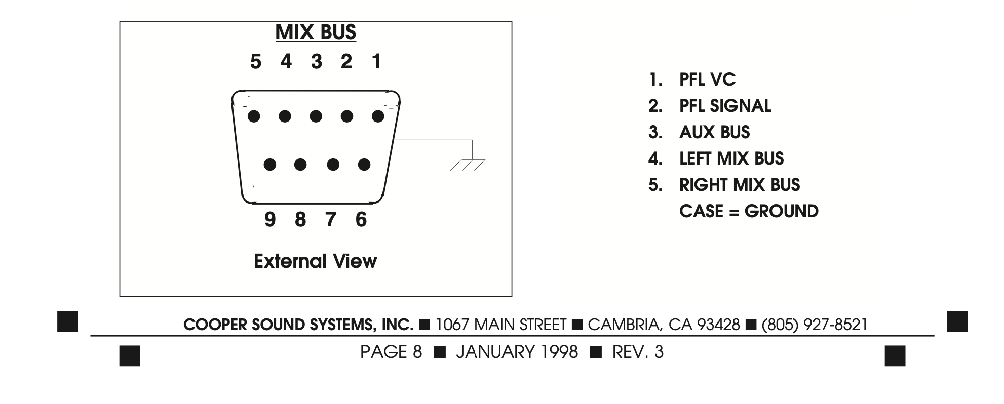

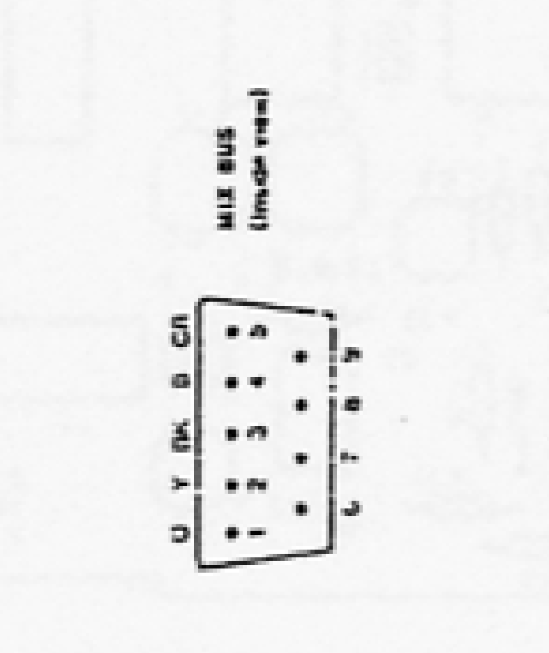

jawharp Posted February 7, 2025 Report Posted February 7, 2025 Hey guys, I have a 106+1 I want to connect to my 108+1 to increase the channel count. The manual says this can be done via the D-Sub mix bus connector on the side panel. I went to the manual to look at the wiring diagram but the images in the manual are so low res I can't make out the labels. Anyone know what the pinouts are, or have a hard copy of that manual page you are willing to upload a picture of? Thanks Quote
jawharp Posted February 7, 2025 Author Report Posted February 7, 2025 Christ not sure how I missed that. Thanks Quote
