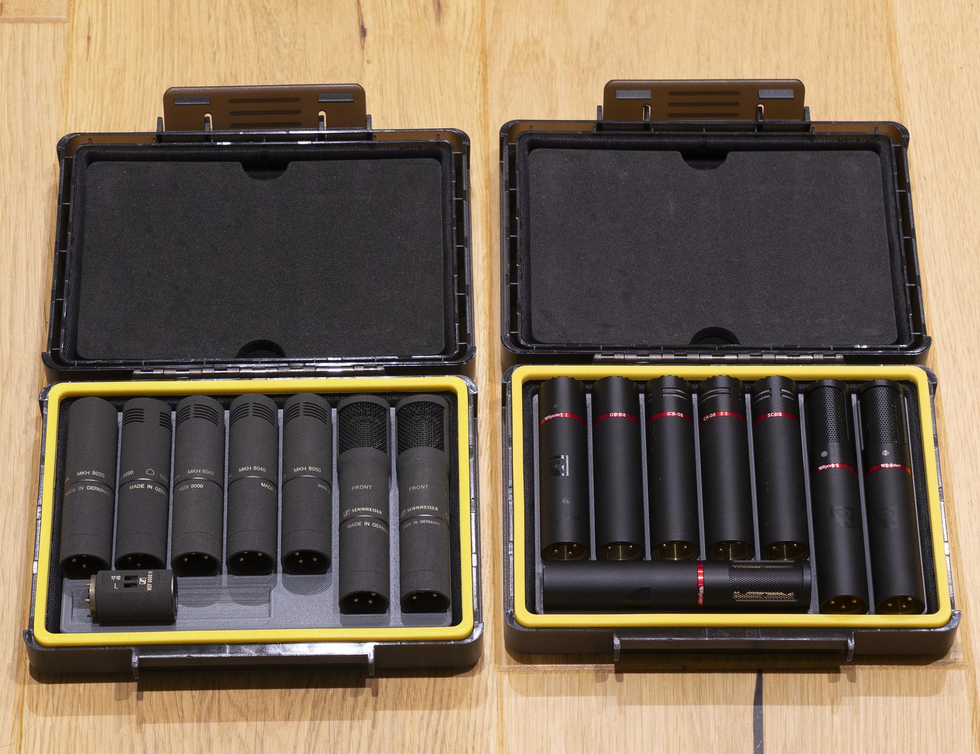

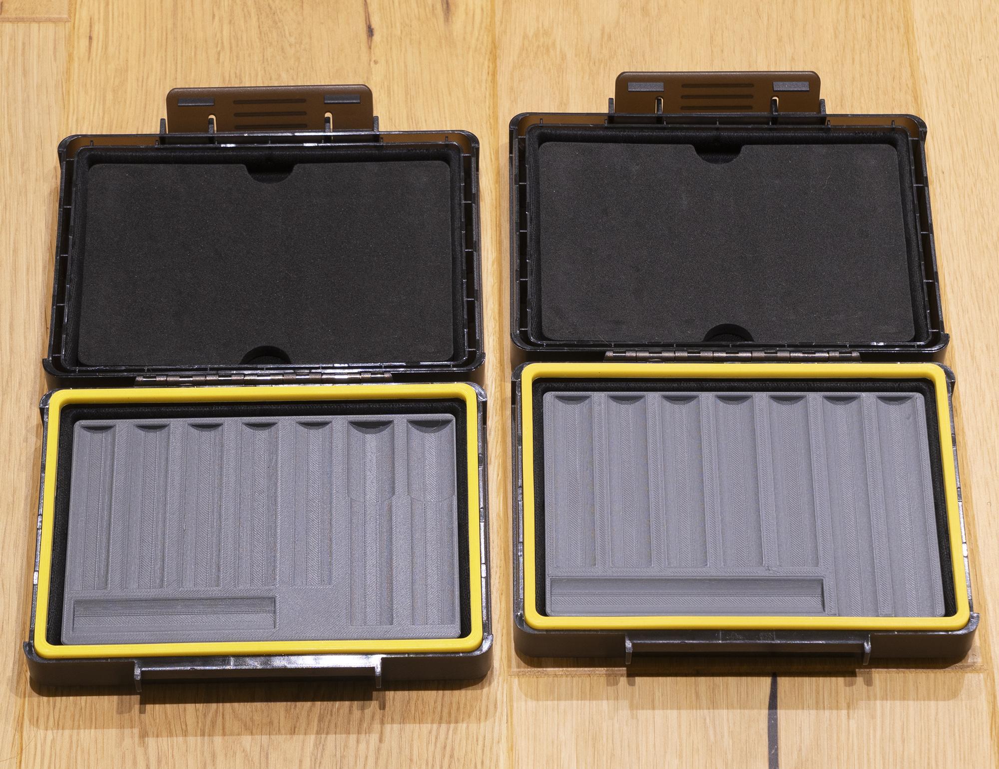

Roland Harris Posted February 10 Report Posted February 10 On 2/9/2025 at 5:20 AM, Larry Sanbourne said: 3. I also travel with 6 more Schoeps mics that I use for proper recordings, and I already damaged one Schoeps mic by just carrying these in a mini pelican case with some packing material to immobilize. It's also hard to keep the matched pairs straight. I'm thinking I could find some small case that fits 8 mics on two layers with custom-cut foam…? When I travel, these are in my backpack, so I also need room for noise-cancelling headphones and whatever else I'm traveling with. Well the most compact yet still reasonably shock-absorbing case I have found for eight SDC mics is a 3.5" hard-disc case, fitted with a tray to exactly match the mics I use. These 3.5" cases are much less common than the smaller cases for 2.5" external hard drives. Here's a couple of photos. Cheers, Roland Quote

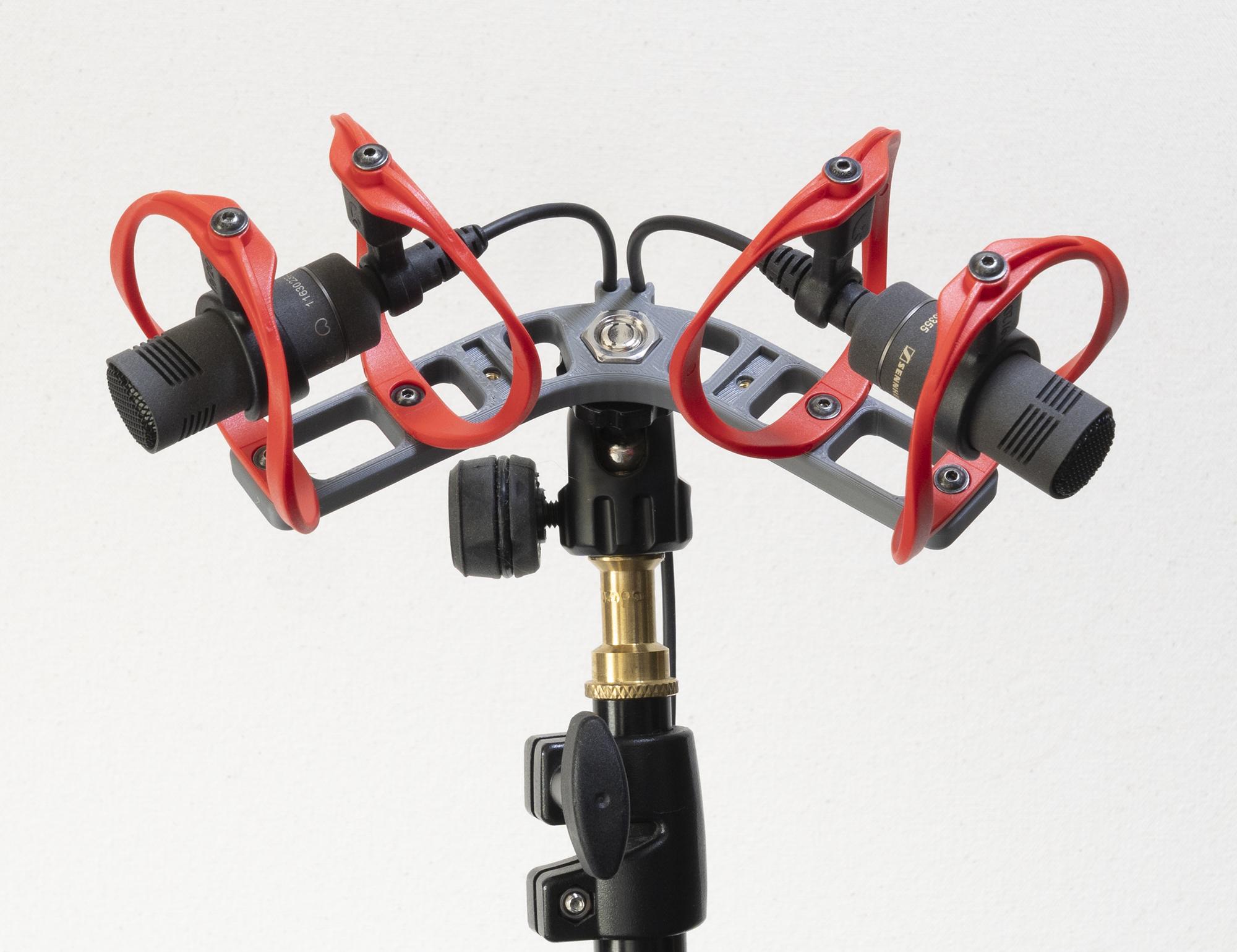

Roland Harris Posted February 11 Report Posted February 11 Or just get a 3d printer! The technology has matured so much, there is no complex fiddling around/setting up required these days. I got a very affordable (£170) printer in the autumn, very much with mic mounts and clips in mind, and it has saved me a fortune on the one hand, and on the other has meant I can make, test and refine designs so quickly. I've not been convinced about the shock-mount options for the commercially available ORTF mounts etc., so here is one of my takes that seems - vaguely - along the lines you could use (OK this one is designed for stand-mounted use): it can use Radius hoops (as shown here) or Rycote lyres. Cheers, Roland Quote
