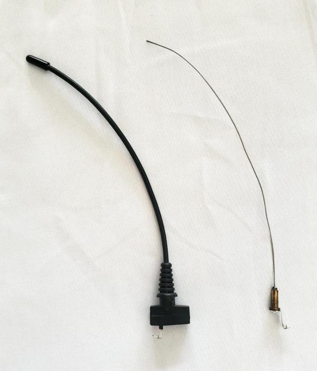

Mida Posted February 25, 2025 Report Posted February 25, 2025 I'm trying to make an SMA antenna perform as well as the stock Sennheiser G3/G4 antenna. Does anyone know the specific type or name of this wire? Is it steel, copper, or something else? Also, where can I buy a good replacement? Any help would be much appreciated! Quote
Paul F Posted February 26, 2025 Report Posted February 26, 2025 7-strand stainless steel wire - I can't recall the diameter. It doesn't take to soldering. Don't try to make it. Buy it. They are cheap. $5 each on AliExpress. Use this item and cut to length (depending on frequency range) and then put a cable cap on top. https://www.aliexpress.us/item/2251832775028613.html?spm=a2g0o.detail.1000014.3.460b56d5Vft2UF&gps-id=pcDetailBottomMoreOtherSeller&scm=1007.33416.213724.0&scm_id=1007.33416.213724.0&scm-url=1007.33416.213724.0&pvid=68c672a6-ea00-4656-94fb-22c1d2b44137&_t=gps-id%3ApcDetailBottomMoreOtherSeller%2Cscm-url%3A1007.33416.213724.0%2Cpvid%3A68c672a6-ea00-4656-94fb-22c1d2b44137%2Ctpp_buckets%3A668%230%23131923%2318_668%23888%233325%2320_23416%230%23213724%230_23416%234721%2321967%23312_23416%234722%2321970%231_668%232846%238109%231935_668%232717%237567%23965_668%231000022185%231000066059%230_668%233422%2315392%23609_4452%230%23214000%230_4452%233474%2316498%23535_4452%234862%2324463%23899_4452%233098%239624%23992_4452%235108%2323442%23433_4452%233564%2316062%23526&gatewayAdapt=glo2usa4itemAdapt End caps https://www.aliexpress.us/item/3256804718989096.html?spm=a2g0o.productlist.main.13.46147714zaZNgd&algo_pvid=307ce6bb-fd4d-4f11-9c10-b6b953682235&algo_exp_id=307ce6bb-fd4d-4f11-9c10-b6b953682235-12&pdp_ext_f={"order"%3A"3"%2C"eval"%3A"1"}&pdp_npi=4%40dis!USD!2.69!1.80!!!2.69!1.80!%40!12000030978914453!sea!US!738145724!X&curPageLogUid=5Zu2ReFhrAlw&utparam-url=scene%3Asearch|query_from%3A Quote

Paul F Posted July 4, 2025 Report Posted July 4, 2025 That leaves finding the SMA connector and some 7-strand stainless wire that fits into the SMA connector. You can use the SMA connectors that are meant to be soldered. You can put the wire in the pin and then crimp it by hand with pliers or a vice or even a hammer and a blunt pointed bit of metal. I've done that in the past. It's not as good as doing it with a crimping tool, but it works. Once you have it crimped, you can cover the wire with heat shrink tubing or several coats of something like this - https://www.amazon.com/Grip-Rubberized-Plastic-Coating-Green/dp/B016J1ND9I/ref=sr_1_5?crid=2ERI5CXSUL3QD&dib=eyJ2IjoiMSJ9.paTNBjYHnaDjmz8YyM4S-jepXhUZgZfa8JD9tsdeQ66cL0njvEB1IVCgWrh0ydCebfo9Vub7WFj-Du7I__1Mq6fbmPYxsMsEOKP5BbJbRPxkWDmellvG8MlW0-qcZTYG2SMIyoha4eZyAMPBXFGMVUn4t8GSun-cZGayyLWIocbOoclg_DWer-FxjgIPLqBJ8FuGUhDl3djd_fC7nM7koi_GGP6vWLQjfShl-kuEjpWc0n6p0o5QEy9hr8cW1DotU3yGK8QzS3OnAWgBZTw97A.1r_WkyNV_3ZPhKW3iiFRnyqIJlej-us1ePlbL8qcof0&dib_tag=se&keywords=tool+handle+dipping+coating&qid=1751592631&sprefix=tool+handle+dipping+%2Caps%2C183&sr=8-5 Quote
LoganSound Posted July 5, 2025 Report Posted July 5, 2025 There is something hams use called “the signal stick” and it was actually homebrewed by the same guy who created HAMStudy.com - they are really awesome antennae that are flexible but always return to straight position and he revealed in a podcast he used PIANO WIRE to make it. Throw some heat shrink over the top and it should perform really well when cut to the proper length. Quote
W72BX Posted August 16, 2025 Report Posted August 16, 2025 Hi Mida, Bit late to the party..... I've been using stuff I found on Ebay called "Memory Wire". Cheap, easy to find, very flexible but always (well, so far..) returns to straight. Think I used 0.6mm. Fits nicely into the SMA pin and solders easily. I tend to cover with a layer of heat shrink plus an outer jacket of braided sleeving. Have been experimenting with epoxy to permanently fix antenna and pin into plug body... Very promising, but a little bit fiddly... Quote

Conor Posted September 30, 2025 Report Posted September 30, 2025 18 hours ago, berniebeaudry said: Do you have a link? I did a search and saw many options. Are you using stainless steel? Memory wire is made from nitinol - nickel-titanium alloy Quote
W72BX Posted October 10, 2025 Report Posted October 10, 2025 Hi, can't find original listing, but this looks like the same Nitinol memory wire. Worth checking its properties with supplier. just to make sure it does stay straight and can easily be soldered. https://www.ebay.co.uk/itm/276768379767?_skw=nitinol+memory+wire&itmmeta=01K76APF583PNVVA0GZGN1G2ST&hash=item4070ae5377%3Ag%3ANkUAAOSwa3BgKV5Y&itmprp=enc%3AAQAKAAAA8FkggFvd1GGDu0w3yXCmi1dPBmj9%2BmpT39%2BnP8iB4yXk3jgNa%2Ftx7Nzn2iRDebQv4DD9ez6tmpZQnDVT7SWQK5lG%2FAGvtKrV3QLDVXq9jm9SDXPld1uhyTuUHJrvqV9Et7YPR3XrYrIK4L%2FcCAps7k7o7JKxBEisRPuMzqrVXH3jhDUSQjBoNy70vcsLnl9AHjMqwFURE6vfcJl4q1aRf4GDRGXpaFaqICkwL9PxSc5G%2BRMHwvZ3VRO69aXcbc77s9ymkOUWQ%2Fb0dn241tAK5R2u5uztidwcLYIag%2Bc8aU21GV9MFHuG%2Bpnn%2BZxzoapJkQ%3D%3D|tkp%3ABk9SR-Ty2cq5Zg&var=2560199162867 Quote
mark kirchner Posted December 19, 2025 Report Posted December 19, 2025 Antennas made with Nitinol wire are not a great choice for transmitters that will be used for talent. You will want to use a braided cable wire. When I started making antennas and had difficulty sourcing wire, I went to my local bicycle shop and bought a meter long derailleur cable. Then I bought an SMA connector for that diameter. Quote
Conor Posted December 19, 2025 Report Posted December 19, 2025 1 hour ago, mark kirchner said: Antennas made with Nitinol wire are not a great choice for transmitters that will be used for talent. You will want to use a braided cable wire. When I started making antennas and had difficulty sourcing wire, I went to my local bicycle shop and bought a meter long derailleur cable. Then I bought an SMA connector for that diameter. How are you attaching the wire to the SMA center pin? I can only find galvanized steel stranded wire that is impossible to solder to. Quote
