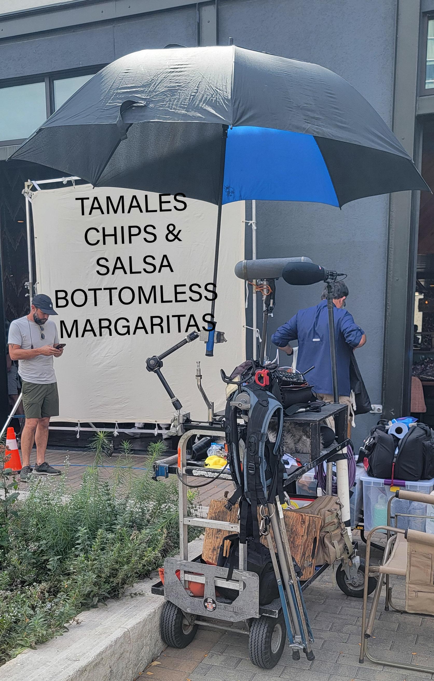

PMC Posted April 6, 2025 Report Posted April 6, 2025 My simple griptastic umbrella. Works up to 15 mile an hour winds. Quote

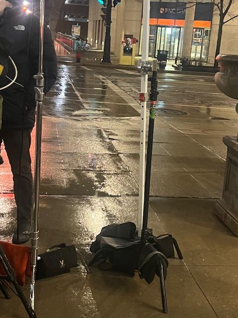

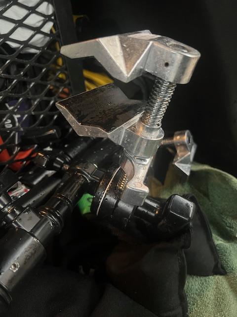

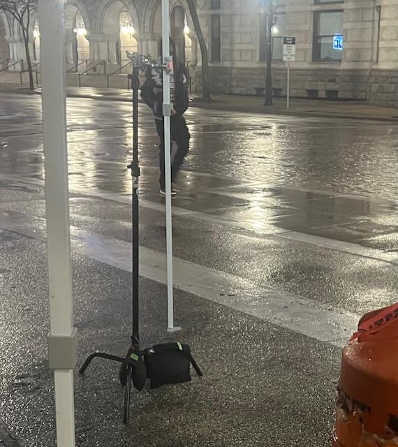

Tim Norris Posted April 15, 2025 Report Posted April 15, 2025 On 3/2/2025 at 10:25 AM, johngooch said: "C-Stands and Cardellini clamps to secure the tent, weighing each stand down with plenty of shot bags" Very curious to see how this works-- do you have pics? We had to deploy my tent during a windy rainstorm in downtown Milwaukee on April 3. It was cold, windy, and very wet. Three of us had it in place in less than ten minutes. The other two held it down while I assembled the stands and pulled out the shot bags. I remembered to collect these images for you! It took several days for the tent and shot bags to dry out in my garage. Clamp Clamp on stand connected to tent leg. Must take care to attach clamp to tent leg to avoid crushing/crimping the leg. It is sometimes easiest to attach clamp to leg properly and raise stand into place below it. Once attached, the lower sections of the tent legs can be retracted if they are in the way. You can adjust the height of the tent with the C-Stands. Cheers, Tim Quote
