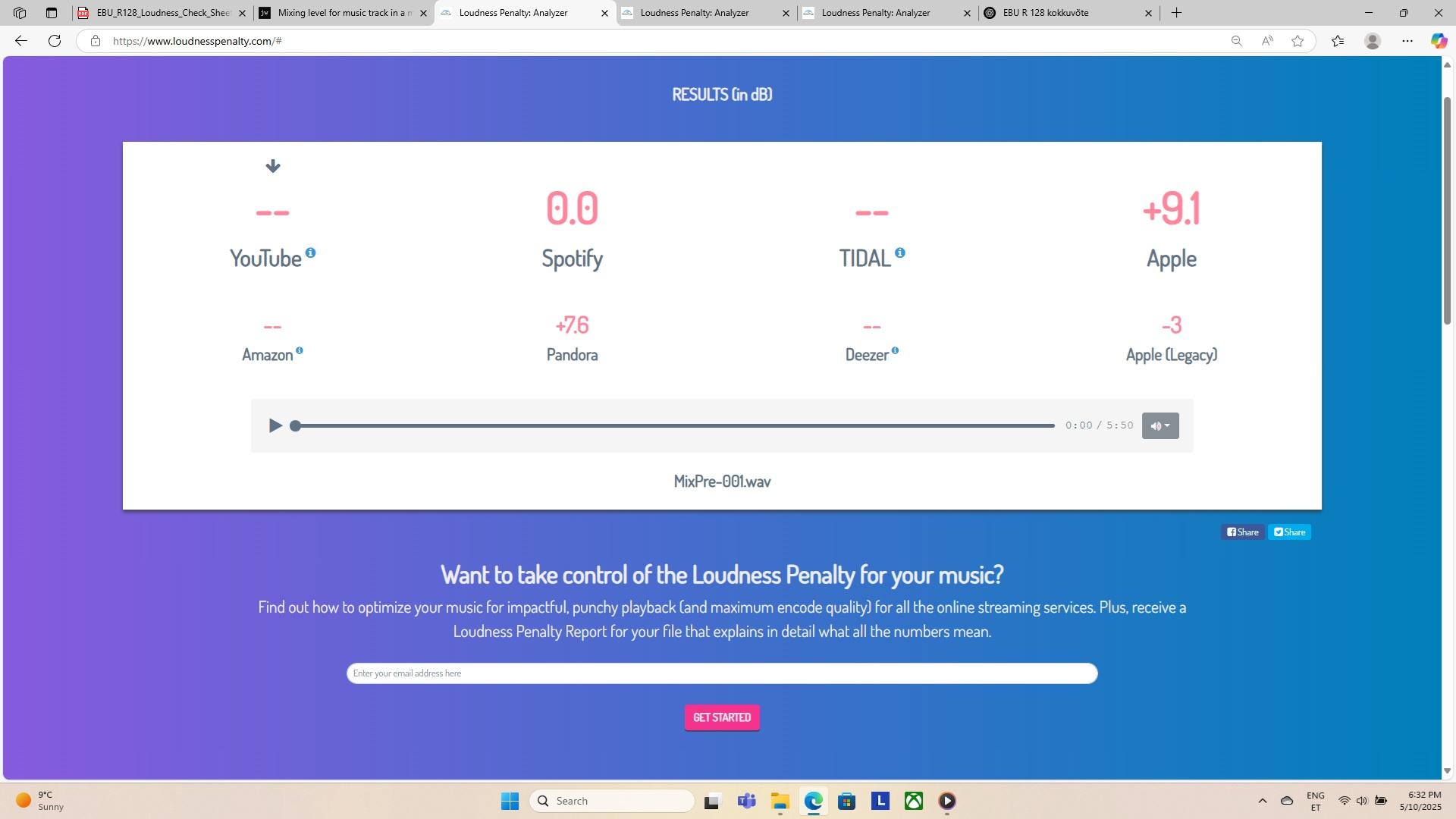

inspire Posted May 10 Report Posted May 10 So what would you do blindly in this case? (This is a recording of birds in nature) Quote

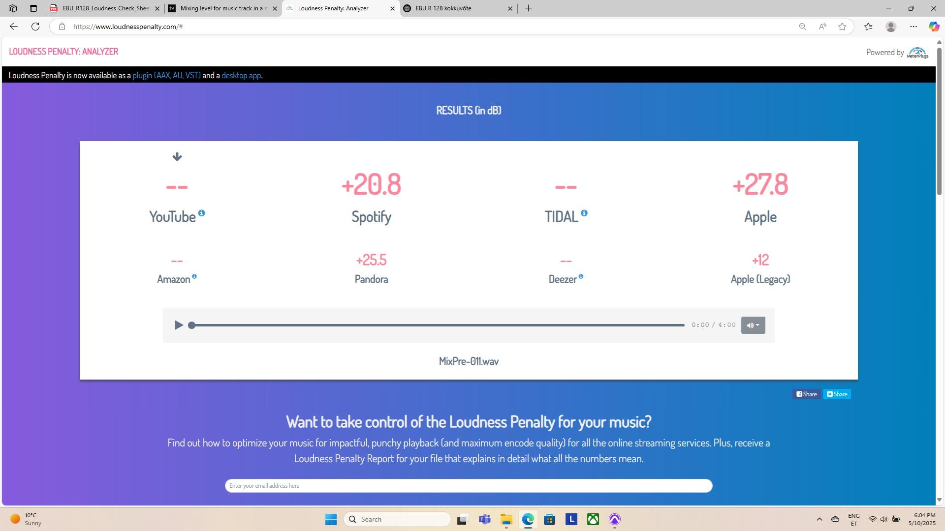

inspire Posted May 10 Report Posted May 10 And this pobably all right, at least IMHO. (Four people's conversation) Quote
Bouke Posted May 10 Report Posted May 10 I have no clue what I'm looking at. But, a positive dB value can only be a True Peak, as (afaik) 0 dB is the max value a sample can hold. A TP of 27,8 is created by a Gotham Thunderbird. Can you share the files? Quote

Bouke Posted May 10 Report Posted May 10 33 minutes ago, inspire said: (This is a recording of birds in nature) My gutfeeling tells me that this will be close to impossible to mix to a broadcast standard, the songs will be to 'peaky' to make any volume. (Let a VU meter come up.) The noise of wind in leaves will be concidered either silence (no part of the measurment) or way too low to get to the desired level. A doc explaining the content, or in European commercials, flag intentionally low level as True results from my work (Set to YouTube specs): (Test took just a few seconds.) Current specifications: YouTube Target Integrated Loudness (I): -14.0 Allowed difference +/-: 0.5 Max Momentary Loudness (M): 1.0 Max Short Term Loudness (S): 1.0 Max Loudness Range (LRA): NA Max True Peak: 0.0 Max allowed correction: 20 Check for mono: No /Users/bouke/Downloads/birds.wav. # NOTE, I renamed your file, this are the found values: Integrated Loudness (I): -31.8 LUFS True Peak (TP): -9.8 dBFS Loudness Range (LRA): 8.0 LUFS WARNING, Integrated loudness is 17.8 LU to low WARNING, peaks out of spec found, fix these before overall volume change! Note that the suggested value INCLUDES the needed volume change! 00:00:03:20 Momentary peak of 2.8 LU, action: lower this peak by 1.8 dB 00:00:04:05 Momentary peak of 2.4 LU, action: lower this peak by 1.4 dB 00:00:04:18 Momentary peak of 4.5 LU, action: lower this peak by 3.5 dB 00:00:05:05 Momentary peak of 4.8 LU, action: lower this peak by 3.8 dB 00:00:05:18 Momentary peak of 2.2 LU, action: lower this peak by 1.2 dB 00:00:06:03 Short peak of 2.2 LU, action: lower volume a couple of seconds here by 1.2 dB 00:00:07:00 Momentary peak of 2.8 LU, action: lower this peak by 1.8 dB 00:00:07:13 Momentary peak of 2.4 LU, action: lower this peak by 1.4 dB 00:00:07:23 Short peak of 1.8 LU, action: lower volume a couple of seconds here by 0.8 dB 00:00:25:08 Momentary peak of 3.5 LU, action: lower this peak by 2.5 dB 00:00:25:18 Momentary peak of 4.6 LU, action: lower this peak by 3.6 dB 00:00:26:05 Momentary peak of 4.1 LU, action: lower this peak by 3.1 dB 00:00:26:18 Momentary peak of 4.9 LU, action: lower this peak by 3.9 dB 00:00:27:03 Short peak of 2.3 LU, action: lower volume a couple of seconds here by 1.3 dB 00:00:28:13 Momentary peak of 2.8 LU, action: lower this peak by 1.8 dB 00:00:29:00 Momentary peak of 3.3 LU, action: lower this peak by 2.3 dB 00:00:29:10 Short peak of 1.5 LU, action: lower volume a couple of seconds here by 0.5 dB 00:00:34:15 Momentary peak of 3.5 LU, action: lower this peak by 2.5 dB 00:00:35:03 True peak of -14.6 dBTP, action: Lower this peak here by 3.2 dB 00:00:35:08 True peak of -14.9 dBTP, action: Lower this peak here by 2.9 dB 00:00:35:10 Momentary peak of 7.7 LU, action: lower this peak by 6.7 dB 00:00:35:18 True peak of -16.4 dBTP, action: Lower this peak here by 1.4 dB 00:00:35:20 Momentary peak of 6.6 LU, action: lower this peak by 5.6 dB 00:00:35:23 True peak of -15.4 dBTP, action: Lower this peak here by 2.4 dB 00:00:36:05 Momentary peak of 7.1 LU, action: lower this peak by 6.1 dB 00:00:36:08 True peak of -17.1 dBTP, action: Lower this peak here by 0.7 dB 00:00:36:10 Momentary peak of 5.8 LU, action: lower this peak by 4.8 dB 00:00:36:15 True peak of -14.9 dBTP, action: Lower this peak here by 2.9 dB 00:00:36:20 True peak of -13.7 dBTP, action: Lower this peak here by 4.1 dB 00:00:36:23 Momentary peak of 5.8 LU, action: lower this peak by 4.8 dB 00:00:37:05 True peak of -13.7 dBTP, action: Lower this peak here by 4.1 dB 00:00:37:10 Momentary peak of 3.4 LU, action: lower this peak by 2.4 dB 00:00:37:13 True peak of -13.0 dBTP, action: Lower this peak here by 4.8 dB 00:00:37:18 Momentary peak of 7.4 LU, action: lower this peak by 6.4 dB 00:00:37:23 True peak of -14.9 dBTP, action: Lower this peak here by 2.9 dB 00:00:38:05 Momentary peak of 7.5 LU, action: lower this peak by 6.5 dB 00:00:38:13 True peak of -10.2 dBTP, action: Lower this peak here by 7.6 dB 00:00:38:18 Momentary peak of 7.0 LU, action: lower this peak by 6.0 dB 00:00:39:00 Short peak of 5.7 LU, action: lower volume a couple of seconds here by 4.7 dB 00:00:39:03 True peak of -13.0 dBTP, action: Lower this peak here by 4.8 dB 00:00:39:08 Momentary peak of 4.4 LU, action: lower this peak by 3.4 dB 00:00:39:13 Short peak of 5.4 LU, action: lower volume a couple of seconds here by 4.4 dB 00:00:39:18 True peak of -14.7 dBTP, action: Lower this peak here by 3.1 dB 00:00:39:23 True peak of -12.2 dBTP, action: Lower this peak here by 5.6 dB 00:00:40:00 Momentary peak of 6.7 LU, action: lower this peak by 5.7 dB 00:00:40:03 True peak of -14.1 dBTP, action: Lower this peak here by 3.7 dB 00:00:40:05 Momentary peak of 6.5 LU, action: lower this peak by 5.5 dB 00:00:40:08 True peak of -14.0 dBTP, action: Lower this peak here by 3.8 dB 00:00:40:15 True peak of -14.7 dBTP, action: Lower this peak here by 3.1 dB 00:00:40:20 True peak of -15.7 dBTP, action: Lower this peak here by 2.1 dB 00:00:41:03 Momentary peak of 5.5 LU, action: lower this peak by 4.5 dB 00:00:41:13 Short peak of 4.5 LU, action: lower volume a couple of seconds here by 3.5 dB 00:00:44:15 Momentary peak of 3.8 LU, action: lower this peak by 2.8 dB 00:00:45:03 Momentary peak of 4.0 LU, action: lower this peak by 3.0 dB 00:00:45:15 Momentary peak of 1.6 LU, action: lower this peak by 0.6 dB 00:00:46:08 Momentary peak of 1.3 LU, action: lower this peak by 0.3 dB 00:00:46:15 Short peak of 1.2 LU, action: lower volume a couple of seconds here by 0.2 dB 00:00:47:20 Momentary peak of 2.5 LU, action: lower this peak by 1.5 dB 00:00:48:08 Momentary peak of 3.3 LU, action: lower this peak by 2.3 dB 00:00:53:08 True peak of -9.8 dBTP, action: Lower this peak here by 8.0 dB 00:00:53:13 Momentary peak of 6.4 LU, action: lower this peak by 5.4 dB 00:00:53:15 True peak of -15.3 dBTP, action: Lower this peak here by 2.5 dB 00:00:53:20 Momentary peak of 3.8 LU, action: lower this peak by 2.8 dB 00:00:55:23 Short peak of 1.2 LU, action: lower volume a couple of seconds here by 0.2 dB 00:00:56:00 Momentary peak of 4.0 LU, action: lower this peak by 3.0 dB 00:00:56:10 Momentary peak of 2.2 LU, action: lower this peak by 1.2 dB 00:00:56:23 Momentary peak of 2.2 LU, action: lower this peak by 1.2 dB 00:00:57:05 True peak of -15.8 dBTP, action: Lower this peak here by 2.0 dB 00:00:57:10 Momentary peak of 4.9 LU, action: lower this peak by 3.9 dB 00:00:57:13 True peak of -17.3 dBTP, action: Lower this peak here by 0.5 dB 00:00:57:15 Momentary peak of 4.6 LU, action: lower this peak by 3.6 dB 00:00:57:23 Short peak of 2.2 LU, action: lower volume a couple of seconds here by 1.2 dB 00:00:58:00 Momentary peak of 1.1 LU, action: lower this peak by 0.1 dB 00:00:58:03 Short peak of 2.3 LU, action: lower volume a couple of seconds here by 1.3 dB 00:00:58:23 Momentary peak of 4.0 LU, action: lower this peak by 3.0 dB 00:00:59:10 Momentary peak of 3.2 LU, action: lower this peak by 2.2 dB 00:00:59:23 Momentary peak of 1.8 LU, action: lower this peak by 0.8 dB 00:01:00:03 Short peak of 2.2 LU, action: lower volume a couple of seconds here by 1.2 dB 00:01:00:05 True peak of -15.1 dBTP, action: Lower this peak here by 2.7 dB 00:01:00:10 True peak of -15.5 dBTP, action: Lower this peak here by 2.3 dB 00:01:00:13 Momentary peak of 5.2 LU, action: lower this peak by 4.2 dB 00:01:00:20 Short peak of 2.0 LU, action: lower volume a couple of seconds here by 1.0 dB 00:01:01:10 True peak of -17.7 dBTP, action: Lower this peak here by 0.1 dB 00:01:01:15 Momentary peak of 5.3 LU, action: lower this peak by 4.3 dB 00:01:01:18 True peak of -13.0 dBTP, action: Lower this peak here by 4.8 dB 00:01:01:20 Momentary peak of 6.8 LU, action: lower this peak by 5.8 dB 00:01:02:03 Short peak of 2.7 LU, action: lower volume a couple of seconds here by 1.7 dB 00:01:07:18 Momentary peak of 1.6 LU, action: lower this peak by 0.6 dB 00:01:08:05 Momentary peak of 2.6 LU, action: lower this peak by 1.6 dB 00:01:08:15 Momentary peak of 4.9 LU, action: lower this peak by 3.9 dB 00:01:09:00 Momentary peak of 3.4 LU, action: lower this peak by 2.4 dB 00:01:09:10 Short peak of 1.1 LU, action: lower volume a couple of seconds here by 0.1 dB 00:01:09:13 Momentary peak of 3.2 LU, action: lower this peak by 2.2 dB 00:01:09:23 Short peak of 1.7 LU, action: lower volume a couple of seconds here by 0.7 dB 00:01:10:15 Momentary peak of 3.6 LU, action: lower this peak by 2.6 dB 00:01:11:00 Momentary peak of 2.6 LU, action: lower this peak by 1.6 dB 00:01:11:05 Short peak of 1.9 LU, action: lower volume a couple of seconds here by 0.9 dB 00:01:18:03 Momentary peak of 2.9 LU, action: lower this peak by 1.9 dB 00:01:19:23 True peak of -16.4 dBTP, action: Lower this peak here by 1.4 dB 00:01:20:03 Momentary peak of 7.3 LU, action: lower this peak by 6.3 dB 00:01:20:13 Short peak of 2.1 LU, action: lower volume a couple of seconds here by 1.1 dB 00:01:21:03 Momentary peak of 5.3 LU, action: lower this peak by 4.3 dB 00:01:21:13 Momentary peak of 5.5 LU, action: lower this peak by 4.5 dB 00:01:22:00 Momentary peak of 2.0 LU, action: lower this peak by 1.0 dB 00:01:22:03 Short peak of 3.1 LU, action: lower volume a couple of seconds here by 2.1 dB 00:01:29:15 Momentary peak of 2.5 LU, action: lower this peak by 1.5 dB 00:01:30:00 Momentary peak of 2.1 LU, action: lower this peak by 1.1 dB 00:01:30:15 Momentary peak of 4.4 LU, action: lower this peak by 3.4 dB 00:01:31:00 Momentary peak of 5.1 LU, action: lower this peak by 4.1 dB 00:01:31:10 Short peak of 1.5 LU, action: lower volume a couple of seconds here by 0.5 dB 00:01:32:15 Momentary peak of 3.0 LU, action: lower this peak by 2.0 dB 00:01:33:00 Momentary peak of 5.8 LU, action: lower this peak by 4.8 dB 00:01:33:13 Momentary peak of 3.5 LU, action: lower this peak by 2.5 dB 00:01:33:18 Short peak of 2.1 LU, action: lower volume a couple of seconds here by 1.1 dB 00:01:40:20 Momentary peak of 2.0 LU, action: lower this peak by 1.0 dB 00:01:42:20 Momentary peak of 2.2 LU, action: lower this peak by 1.2 dB 00:01:43:20 Momentary peak of 3.2 LU, action: lower this peak by 2.2 dB 00:01:44:08 Momentary peak of 1.9 LU, action: lower this peak by 0.9 dB 00:01:48:00 Momentary peak of 2.5 LU, action: lower this peak by 1.5 dB 00:01:48:05 True peak of -17.7 dBTP, action: Lower this peak here by 0.1 dB 00:01:48:08 Momentary peak of 3.5 LU, action: lower this peak by 2.5 dB 00:01:48:15 True peak of -16.6 dBTP, action: Lower this peak here by 1.2 dB 00:01:48:18 Momentary peak of 2.7 LU, action: lower this peak by 1.7 dB 00:01:48:23 True peak of -15.8 dBTP, action: Lower this peak here by 2.0 dB 00:01:49:03 Momentary peak of 3.6 LU, action: lower this peak by 2.6 dB 00:01:49:10 True peak of -12.9 dBTP, action: Lower this peak here by 4.9 dB 00:01:49:15 Momentary peak of 5.1 LU, action: lower this peak by 4.1 dB 00:01:49:20 True peak of -17.6 dBTP, action: Lower this peak here by 0.2 dB 00:01:50:00 True peak of -13.0 dBTP, action: Lower this peak here by 4.8 dB 00:01:50:05 Momentary peak of 5.3 LU, action: lower this peak by 4.3 dB 00:01:50:08 True peak of -17.0 dBTP, action: Lower this peak here by 0.8 dB 00:01:50:13 True peak of -14.1 dBTP, action: Lower this peak here by 3.7 dB 00:01:50:20 True peak of -16.3 dBTP, action: Lower this peak here by 1.5 dB 00:01:51:00 Momentary peak of 5.2 LU, action: lower this peak by 4.2 dB 00:01:51:10 True peak of -10.0 dBTP, action: Lower this peak here by 7.8 dB 00:01:51:15 True peak of -13.8 dBTP, action: Lower this peak here by 4.0 dB 00:01:51:20 True peak of -13.9 dBTP, action: Lower this peak here by 3.9 dB 00:01:51:23 Momentary peak of 7.6 LU, action: lower this peak by 6.6 dB 00:01:52:00 True peak of -15.7 dBTP, action: Lower this peak here by 2.1 dB 00:01:52:03 Momentary peak of 6.5 LU, action: lower this peak by 5.5 dB 00:01:52:05 True peak of -15.5 dBTP, action: Lower this peak here by 2.3 dB 00:01:52:10 Momentary peak of 6.3 LU, action: lower this peak by 5.3 dB 00:01:52:20 Short peak of 5.5 LU, action: lower volume a couple of seconds here by 4.5 dB 00:01:54:05 Momentary peak of 2.6 LU, action: lower this peak by 1.6 dB 00:01:54:15 Momentary peak of 2.0 LU, action: lower this peak by 1.0 dB 00:01:54:23 Short peak of 1.9 LU, action: lower volume a couple of seconds here by 0.9 dB 00:02:01:10 True peak of -14.4 dBTP, action: Lower this peak here by 3.4 dB 00:02:02:18 Momentary peak of 1.8 LU, action: lower this peak by 0.8 dB 00:02:02:20 True peak of -15.9 dBTP, action: Lower this peak here by 1.9 dB 00:02:02:23 Momentary peak of 3.4 LU, action: lower this peak by 2.4 dB 00:02:03:10 Momentary peak of 5.1 LU, action: lower this peak by 4.1 dB 00:02:03:20 Momentary peak of 5.8 LU, action: lower this peak by 4.8 dB 00:02:04:08 Short peak of 2.2 LU, action: lower volume a couple of seconds here by 1.2 dB 00:02:05:13 Momentary peak of 2.8 LU, action: lower this peak by 1.8 dB 00:02:06:00 Momentary peak of 3.0 LU, action: lower this peak by 2.0 dB 00:02:06:13 Momentary peak of 1.7 LU, action: lower this peak by 0.7 dB 00:02:06:15 Short peak of 1.9 LU, action: lower volume a couple of seconds here by 0.9 dB 00:02:07:15 True peak of -17.1 dBTP, action: Lower this peak here by 0.7 dB 00:02:07:20 Momentary peak of 5.4 LU, action: lower this peak by 4.4 dB 00:02:08:03 Short peak of 1.7 LU, action: lower volume a couple of seconds here by 0.7 dB 00:02:08:05 True peak of -13.9 dBTP, action: Lower this peak here by 3.9 dB 00:02:08:10 Momentary peak of 6.3 LU, action: lower this peak by 5.3 dB 00:02:08:18 Short peak of 2.5 LU, action: lower volume a couple of seconds here by 1.5 dB 00:02:08:23 True peak of -17.6 dBTP, action: Lower this peak here by 0.2 dB 00:02:09:00 Momentary peak of 4.0 LU, action: lower this peak by 3.0 dB 00:02:09:10 Short peak of 2.4 LU, action: lower volume a couple of seconds here by 1.4 dB 00:02:09:15 True peak of -17.7 dBTP, action: Lower this peak here by 0.1 dB 00:02:09:18 Short peak of 2.6 LU, action: lower volume a couple of seconds here by 1.6 dB 00:02:10:23 True peak of -17.7 dBTP, action: Lower this peak here by 0.1 dB 00:02:11:03 Short peak of 1.6 LU, action: lower volume a couple of seconds here by 0.6 dB 00:02:13:03 Momentary peak of 3.1 LU, action: lower this peak by 2.1 dB 00:02:13:15 Momentary peak of 1.4 LU, action: lower this peak by 0.4 dB 00:02:14:13 Momentary peak of 3.6 LU, action: lower this peak by 2.6 dB 00:02:14:23 Momentary peak of 3.2 LU, action: lower this peak by 2.2 dB 00:02:15:15 Short peak of 1.1 LU, action: lower volume a couple of seconds here by 0.1 dB 00:02:16:23 Momentary peak of 2.4 LU, action: lower this peak by 1.4 dB 00:02:17:08 Momentary peak of 2.3 LU, action: lower this peak by 1.3 dB 00:02:25:03 Momentary peak of 3.3 LU, action: lower this peak by 2.3 dB 00:02:25:15 Momentary peak of 1.7 LU, action: lower this peak by 0.7 dB 00:02:26:20 Momentary peak of 5.6 LU, action: lower this peak by 4.6 dB 00:02:27:05 Momentary peak of 6.0 LU, action: lower this peak by 5.0 dB 00:02:27:15 Momentary peak of 5.7 LU, action: lower this peak by 4.7 dB 00:02:28:03 Short peak of 2.8 LU, action: lower volume a couple of seconds here by 1.8 dB 00:02:35:20 Momentary peak of 2.5 LU, action: lower this peak by 1.5 dB 00:02:36:15 Momentary peak of 3.1 LU, action: lower this peak by 2.1 dB 00:02:37:03 Momentary peak of 4.1 LU, action: lower this peak by 3.1 dB 00:02:37:20 Short peak of 1.1 LU, action: lower volume a couple of seconds here by 0.1 dB 00:02:39:00 Momentary peak of 5.0 LU, action: lower this peak by 4.0 dB 00:02:39:10 Momentary peak of 4.1 LU, action: lower this peak by 3.1 dB 00:02:39:20 Momentary peak of 2.1 LU, action: lower this peak by 1.1 dB 00:02:40:00 Short peak of 1.6 LU, action: lower volume a couple of seconds here by 0.6 dB 00:02:47:00 Momentary peak of 1.5 LU, action: lower this peak by 0.5 dB 00:02:48:08 Momentary peak of 2.6 LU, action: lower this peak by 1.6 dB 00:02:48:18 Momentary peak of 2.9 LU, action: lower this peak by 1.9 dB 00:02:49:03 Momentary peak of 3.5 LU, action: lower this peak by 2.5 dB 00:02:49:08 True peak of -16.1 dBTP, action: Lower this peak here by 1.7 dB 00:02:49:10 Momentary peak of 3.4 LU, action: lower this peak by 2.4 dB 00:02:49:20 True peak of -14.5 dBTP, action: Lower this peak here by 3.3 dB 00:02:49:23 Momentary peak of 3.3 LU, action: lower this peak by 2.3 dB 00:02:50:03 True peak of -17.5 dBTP, action: Lower this peak here by 0.3 dB 00:02:50:08 Momentary peak of 5.5 LU, action: lower this peak by 4.5 dB 00:02:50:10 True peak of -17.6 dBTP, action: Lower this peak here by 0.2 dB 00:02:50:15 Momentary peak of 4.8 LU, action: lower this peak by 3.8 dB 00:02:50:18 True peak of -14.8 dBTP, action: Lower this peak here by 3.0 dB 00:02:50:23 Momentary peak of 4.7 LU, action: lower this peak by 3.7 dB 00:02:51:00 True peak of -16.5 dBTP, action: Lower this peak here by 1.3 dB 00:02:51:03 Momentary peak of 4.7 LU, action: lower this peak by 3.7 dB 00:02:51:10 Short peak of 3.5 LU, action: lower volume a couple of seconds here by 2.5 dB 00:02:57:18 Momentary peak of 2.9 LU, action: lower this peak by 1.9 dB 00:02:58:03 Momentary peak of 3.2 LU, action: lower this peak by 2.2 dB 00:02:58:10 True peak of -16.2 dBTP, action: Lower this peak here by 1.6 dB 00:02:58:13 Momentary peak of 5.2 LU, action: lower this peak by 4.2 dB 00:02:58:23 Momentary peak of 3.4 LU, action: lower this peak by 2.4 dB 00:02:59:08 Momentary peak of 1.9 LU, action: lower this peak by 0.9 dB 00:02:59:15 Short peak of 2.2 LU, action: lower volume a couple of seconds here by 1.2 dB 00:02:59:20 Momentary peak of 1.3 LU, action: lower this peak by 0.3 dB 00:03:00:03 Short peak of 2.3 LU, action: lower volume a couple of seconds here by 1.3 dB 00:03:01:05 Momentary peak of 2.4 LU, action: lower this peak by 1.4 dB 00:03:01:15 Momentary peak of 3.0 LU, action: lower this peak by 2.0 dB 00:03:09:08 Momentary peak of 4.1 LU, action: lower this peak by 3.1 dB 00:03:09:18 Momentary peak of 3.1 LU, action: lower this peak by 2.1 dB 00:03:11:05 Momentary peak of 2.7 LU, action: lower this peak by 1.7 dB 00:03:11:15 Momentary peak of 2.7 LU, action: lower this peak by 1.7 dB 00:03:12:03 Short peak of 1.2 LU, action: lower volume a couple of seconds here by 0.2 dB 00:03:19:23 Momentary peak of 4.9 LU, action: lower this peak by 3.9 dB 00:03:20:08 Momentary peak of 3.9 LU, action: lower this peak by 2.9 dB 00:03:20:18 Momentary peak of 2.9 LU, action: lower this peak by 1.9 dB 00:03:21:03 Momentary peak of 4.0 LU, action: lower this peak by 3.0 dB 00:03:21:15 Momentary peak of 1.4 LU, action: lower this peak by 0.4 dB 00:03:21:18 Short peak of 2.1 LU, action: lower volume a couple of seconds here by 1.1 dB 00:03:23:00 Momentary peak of 1.6 LU, action: lower this peak by 0.6 dB 00:03:23:05 Short peak of 1.5 LU, action: lower volume a couple of seconds here by 0.5 dB 00:03:23:10 Momentary peak of 1.2 LU, action: lower this peak by 0.2 dB 00:03:23:13 Short peak of 1.1 LU, action: lower volume a couple of seconds here by 0.1 dB 00:03:31:10 Momentary peak of 2.3 LU, action: lower this peak by 1.3 dB 00:03:31:20 Momentary peak of 1.9 LU, action: lower this peak by 0.9 dB 00:03:32:05 Momentary peak of 1.4 LU, action: lower this peak by 0.4 dB 00:03:33:05 Momentary peak of 4.4 LU, action: lower this peak by 3.4 dB 00:03:33:15 Momentary peak of 3.3 LU, action: lower this peak by 2.3 dB 00:03:34:00 Short peak of 1.3 LU, action: lower volume a couple of seconds here by 0.3 dB 00:03:43:03 Momentary peak of 3.1 LU, action: lower this peak by 2.1 dB 00:03:43:15 Momentary peak of 3.0 LU, action: lower this peak by 2.0 dB 00:03:44:05 Momentary peak of 1.1 LU, action: lower this peak by 0.1 dB 00:03:45:10 Momentary peak of 1.7 LU, action: lower this peak by 0.7 dB 00:03:45:20 Momentary peak of 1.7 LU, action: lower this peak by 0.7 dB 00:03:54:00 Momentary peak of 2.8 LU, action: lower this peak by 1.8 dB 00:03:54:10 Momentary peak of 4.9 LU, action: lower this peak by 3.9 dB 00:03:54:20 Momentary peak of 5.1 LU, action: lower this peak by 4.1 dB 00:03:55:05 Momentary peak of 2.3 LU, action: lower this peak by 1.3 dB 00:03:55:10 Short peak of 1.7 LU, action: lower volume a couple of seconds here by 0.7 dB 00:03:56:15 Momentary peak of 5.4 LU, action: lower this peak by 4.4 dB 00:03:57:03 Momentary peak of 5.9 LU, action: lower this peak by 4.9 dB 00:03:57:15 Short peak of 2.4 LU, action: lower volume a couple of seconds here by 1.4 dB ------------------------------------------------ Quote
