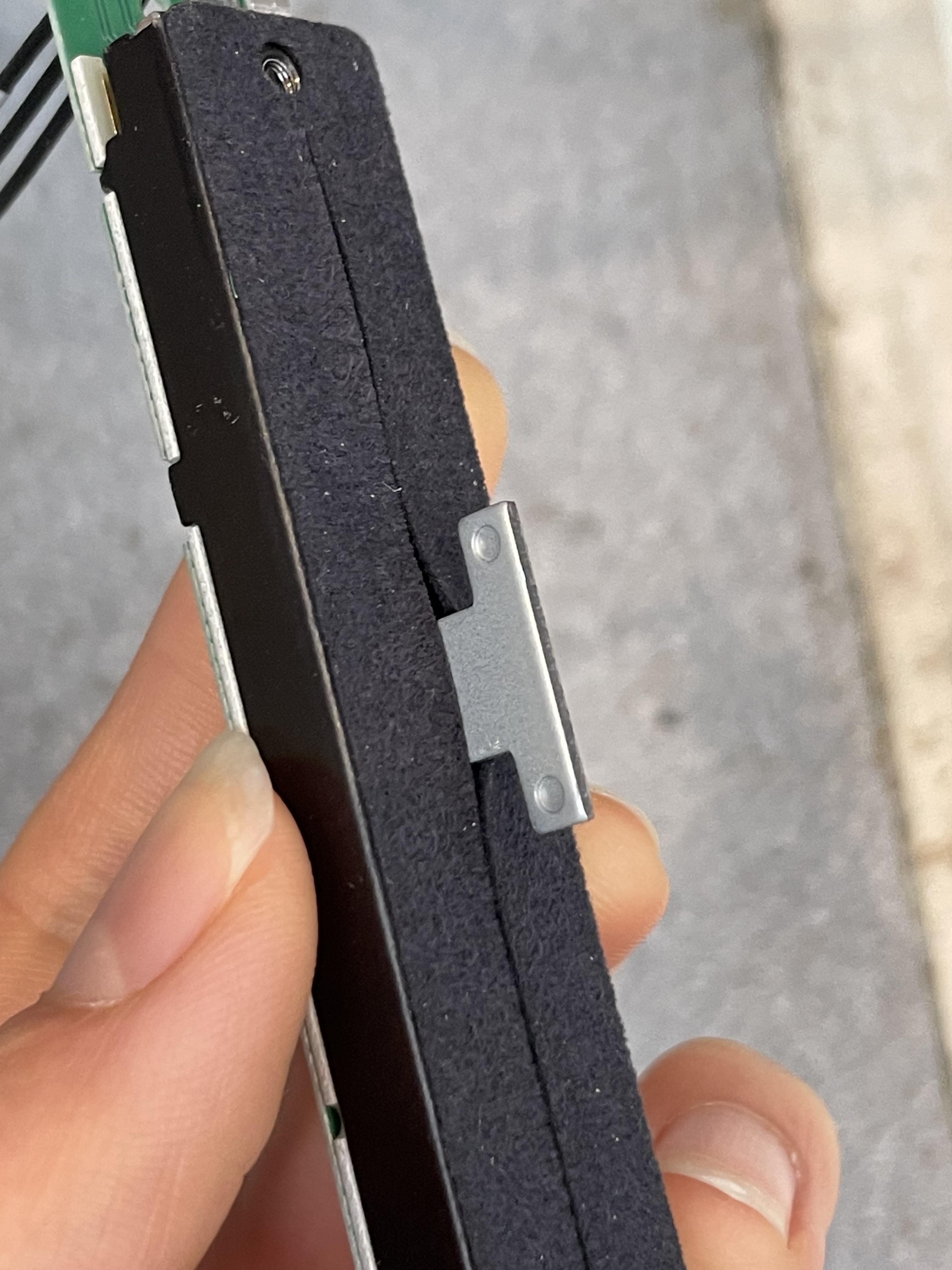

Csaba Major Posted May 31 Report Posted May 31 Hi! And what about the dust? CL16 after 2 days in a Castle, the faders are stucked. Just like the CL12 before. Thats why I sold it. I thought they are improoved this very expensive midi controller. But no. so if the VDB better I will change my CL16, because this is useless. Quote
Csaba Major Posted June 19 Report Posted June 19 I’ve written a letter to VDB and they sent ,me this photo. This convinced me, so I’ve ordered one. I have got it today. Next week I will test it in a dusty set. Quote

Csaba Major Posted July 16 Report Posted July 16 I spent two weeks in really dusty set. Nothing happened with it. Quote
