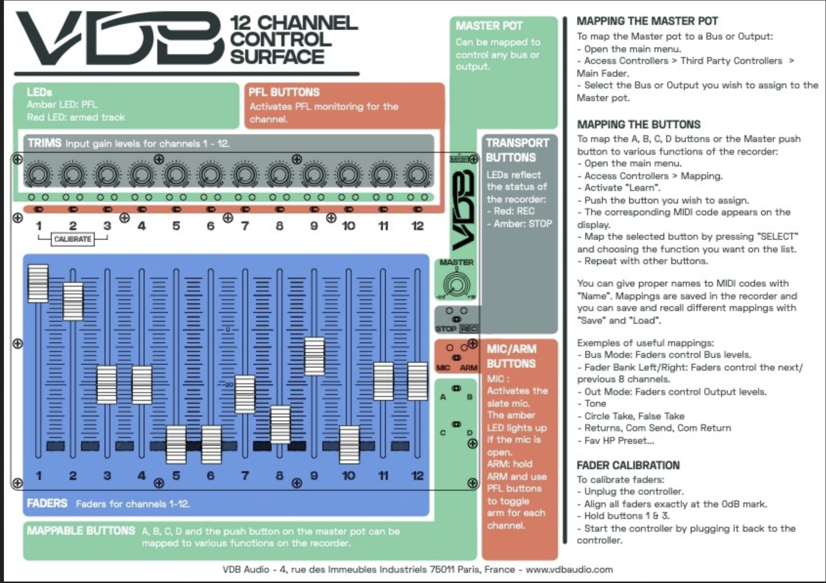

Thank you that is good to hear. I don't think I'll need to actively mix with more than 12 channels at a time but I need the control surface to be able to control the other channels. Presumably that goes for busses and ouput control as well?
Yes.
