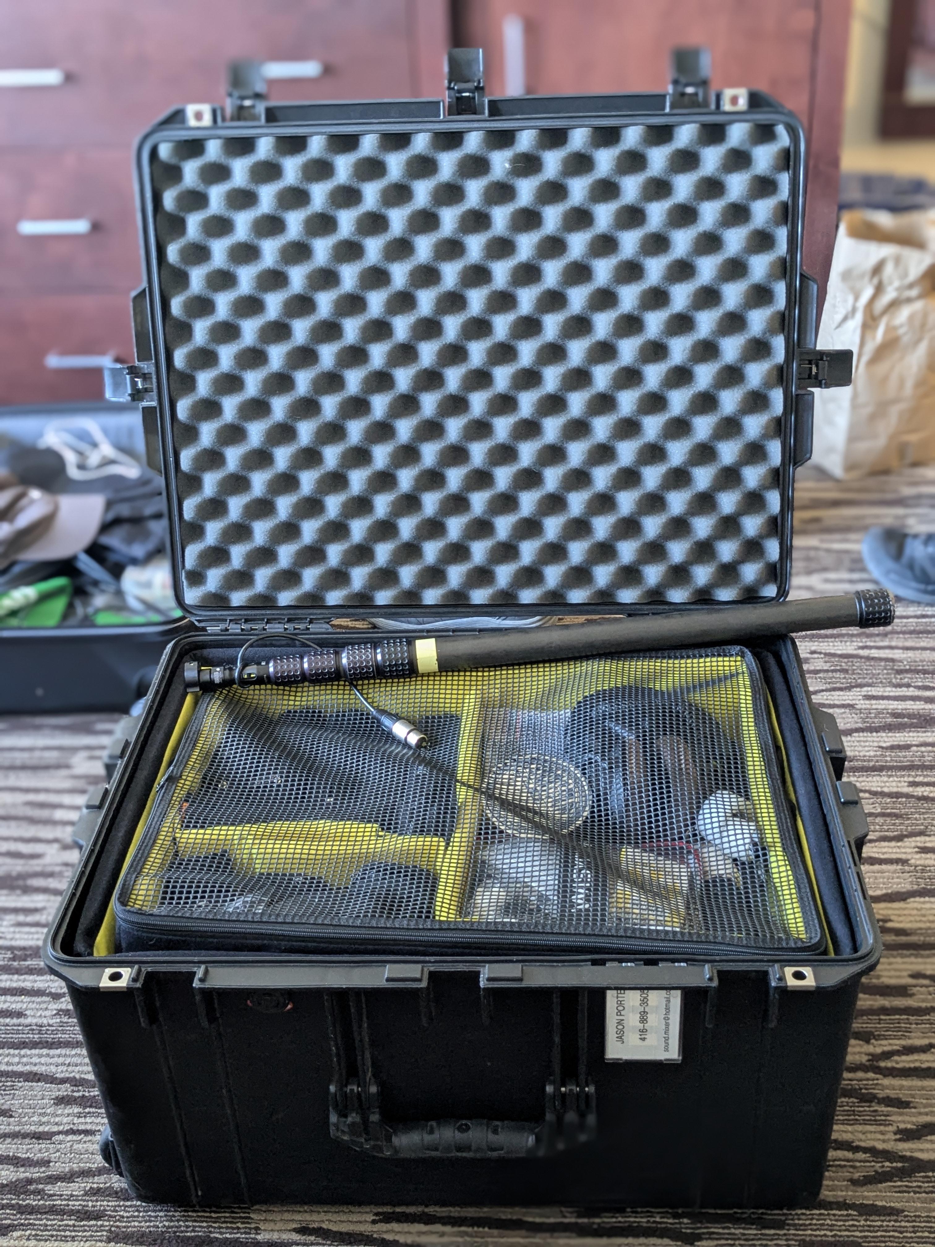

OB1 Posted June 27 Report Posted June 27 Does travel entail flying? The TSA bin is 25" diagonal and whatever fits in there doesn't need to go through special screening. I carry a 9ft KTek in the OR432 with the side exit dismounted within the case and have never been stopped. Yes the OR432 is 30" long but sitting diagonally the 5-6" depth of the bin allows it to fit-ish. Never has it been an issue. They're probably focusing more on the mixer bag in the KTek backpack. Quote
Eric Posted July 1 Report Posted July 1 I'm not sure they made them anymore, my PSC elite (medium) boom pole is brilliant for travel. Fits inside a pellican case (im2950) or even a large suitcase at 2'2" collapsed. 8'3" extended. Suits all the national/international travelling. The PSC elite large can even fit crossways in a pellican (im2950). Both internally cabled. Not sure they make them anymore, so this may be moot. Quote

jason porter Posted July 2 Report Posted July 2 I fly with a k-tek 102cc with a quick release tip, it's fits diagonally in a Pelican 1637. I also sometimes use a vdb-m, which is a bit smaller. Quote
