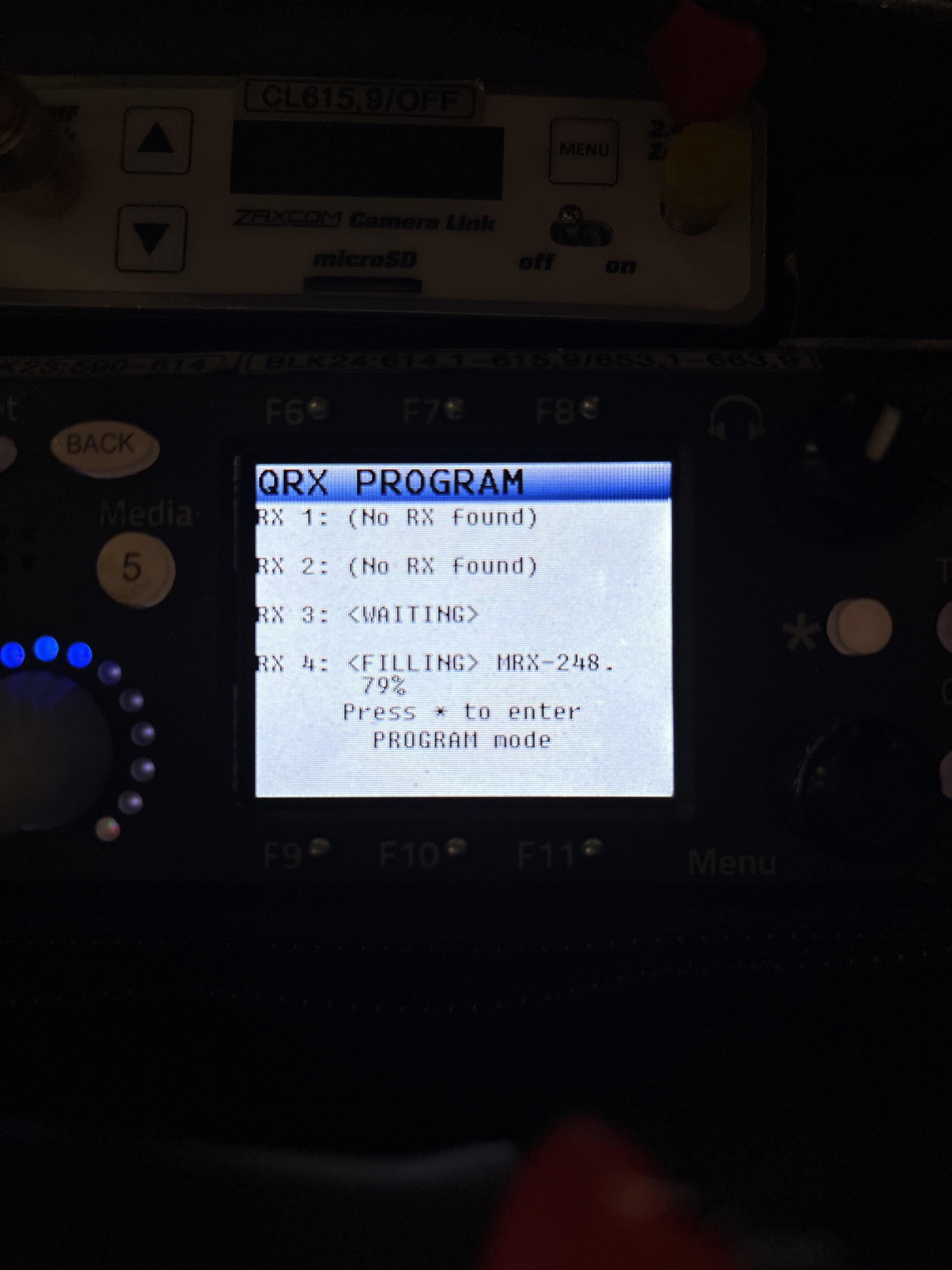

i cant call tech support until thursday. Has anyone here had experience? I tried following the instructions but no luck getting the nova side to grab the update for the mrx’s:
- zmt trx v4.xx set to mono
- mrx v2.48 loaded on zmt micro sd
- mrx set to same channel as zmt (although hd96 n stereo/xr only options?)
- qrx update under settings set to “waiting” but process stops there
Trx AND too close ! Thanks Rado it worked this time, updating now during downtime. Zmt might have worked? Trx is 25’ away and confirming for others - stereo/xr is the setting for mono tx

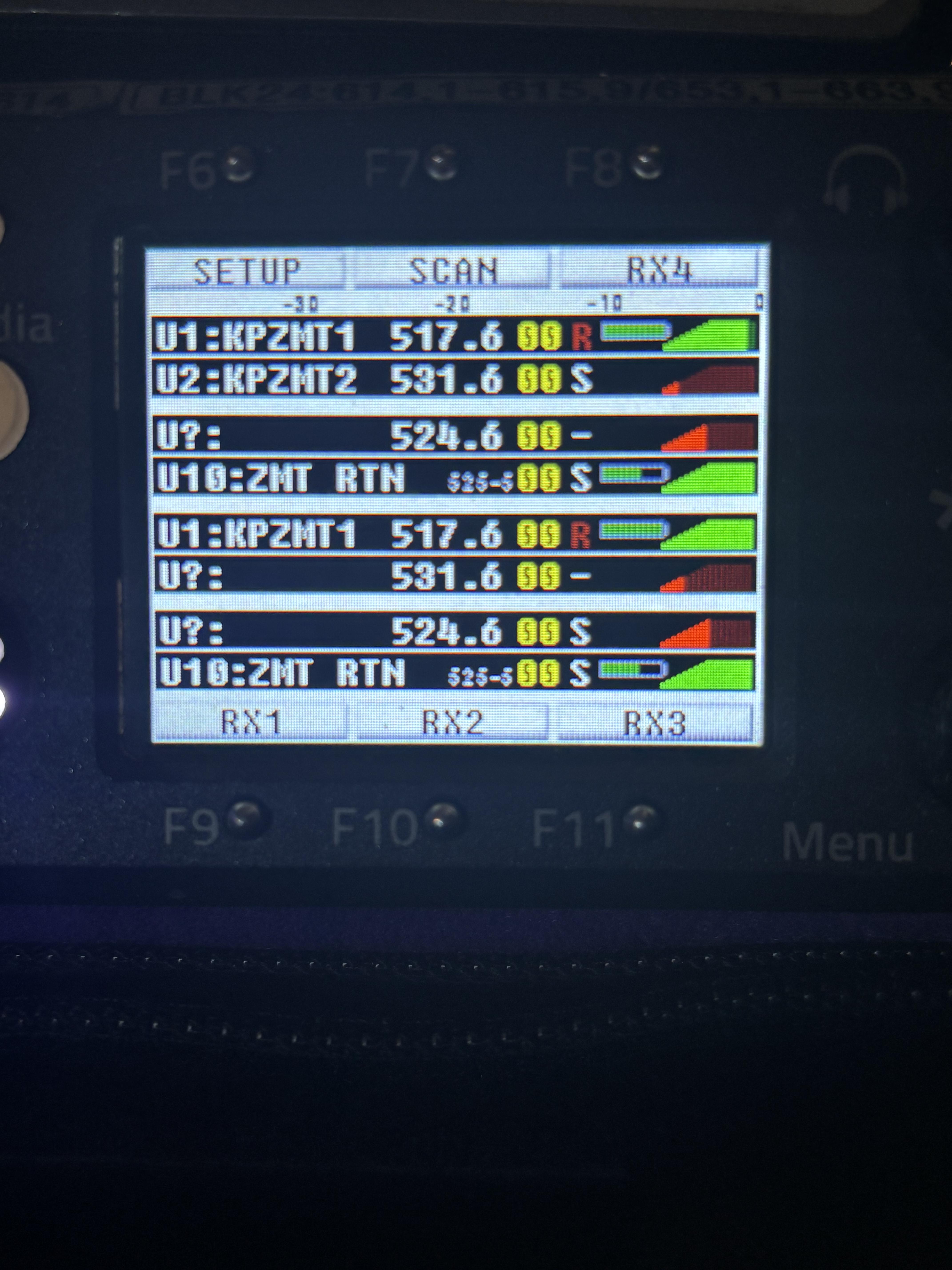

currently I have 2x MRX’s installed, 1st one left on old firmware and 2nd one updated to latest firmware - but both MRX’s set to same freqs I am currently working with to compare performance of both in real time. positive change in clean reception! Hard to tell by photo below exactly - but freq 517.6 on 1st MRX is dancing around 75%-100% pretty typical in previous experience in this location. Freq 517.6 on 2nd MRX is rock solid 100% not a peep below it.
I am anxious now to see how this new setup performs on the run or harsh rf environments or upside down zmt’s which have caused trouble in the past. Nick told me I would love this upgrade (plus a repair i needed and some other hardware updates) - it feels like a whole new “one unit”
