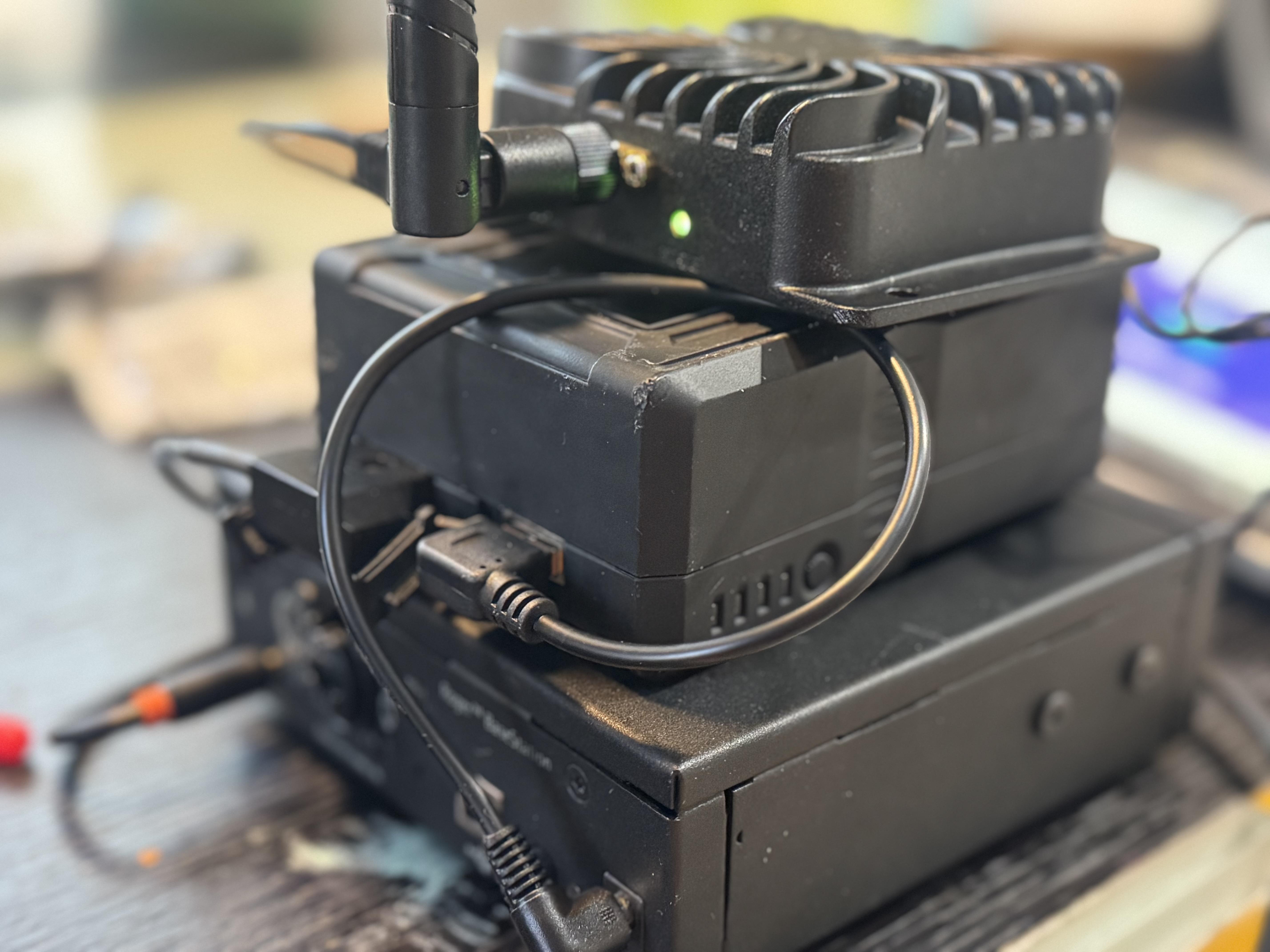

RadoStefanov Posted July 22, 2025 Report Posted July 22, 2025 I am making a self sustained box for Rogers transmitter wifi amp and Vlock Battery. Amp works on 12V and ROgers fed from USB. I will try to make a Vlock plate with 12 to 5V converter to keep everything clean Any ideas? I was thinking of making a 2020 aluminum cage. Quote
solowiej Posted July 22, 2025 Report Posted July 22, 2025 Cool! I'd try to keep the amp outside the box where it can cool off, or at least mount it in a way that uses the aluminum as a heat sink. I imagine you already want that antenna outside of an aluminum box anyways. Quote
RadoStefanov Posted July 22, 2025 Author Report Posted July 22, 2025 1 hour ago, solowiej said: Cool! I'd try to keep the amp outside the box where it can cool off, or at least mount it in a way that uses the aluminum as a heat sink. I imagine you already want that antenna outside of an aluminum box anyways. This is why i got the mounting type. I am thinking aluminum composite. Quote
solowiej Posted July 22, 2025 Report Posted July 22, 2025 1 hour ago, RadoStefanov said: This is why i got the mounting type. I am thinking aluminum composite. The alum composites I played with were surprisingly heavier than a suitable plate of just aluminum. Since all your pieces are already nicely cased I'd consider making a backplane, screw/rivet a V-mount to it with your 2 boxes and some nice cable management. You can always drop that unit into a bag or case as needed. Quote
Philip Perkins Posted July 22, 2025 Report Posted July 22, 2025 What will this rig mount to? A bag? A cart? A camera? Quote
RadoStefanov Posted July 22, 2025 Author Report Posted July 22, 2025 2 hours ago, Philip Perkins said: What will this rig mount to? A bag? A cart? A camera? Individual feather rig with a bag and handle. I can just drop somewhere close to set. 2 hours ago, solowiej said: The alum composites I played with were surprisingly heavier than a suitable plate of just aluminum. Since all your pieces are already nicely cased I'd consider making a backplane, screw/rivet a V-mount to it with your 2 boxes and some nice cable management. You can always drop that unit into a bag or case as needed. 3mm is pretty light and super strong. Way stronger and lighter than aluminum sheet. Quote
RadoStefanov Posted July 22, 2025 Author Report Posted July 22, 2025 2 hours ago, solowiej said: The alum composites I played with were surprisingly heavier than a suitable plate of just aluminum. Since all your pieces are already nicely cased I'd consider making a backplane, screw/rivet a V-mount to it with your 2 boxes and some nice cable management. You can always drop that unit into a bag or case as needed. can you elaborate on the backplane? as far as cables I will have what you see plus 3.5 to 3.5 right angle in the back of Roger's plus space for comtek/vRX/Urx Quote

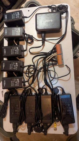

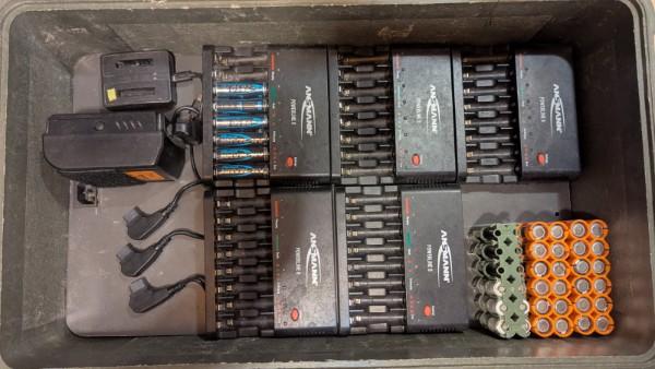

solowiej Posted July 22, 2025 Report Posted July 22, 2025 cut out a board and screw or velcro all those things to it in a nice tidy way. Maybe cut out a handle in the board. And/or give it a clamp. Or cut it to the inner dimensions of a case you like. A lot of folks do this for hotel charging cases: mine is below. My wires aren't so pretty but they're nicely contained underneath and inside the case. I haven't had any heat problems in there. I think I actually did use aluminum composite for this one. And you can use a powered or non-live v-mount just to hold the battery to your board. I use one on the outside of my bag and love it. Quote
