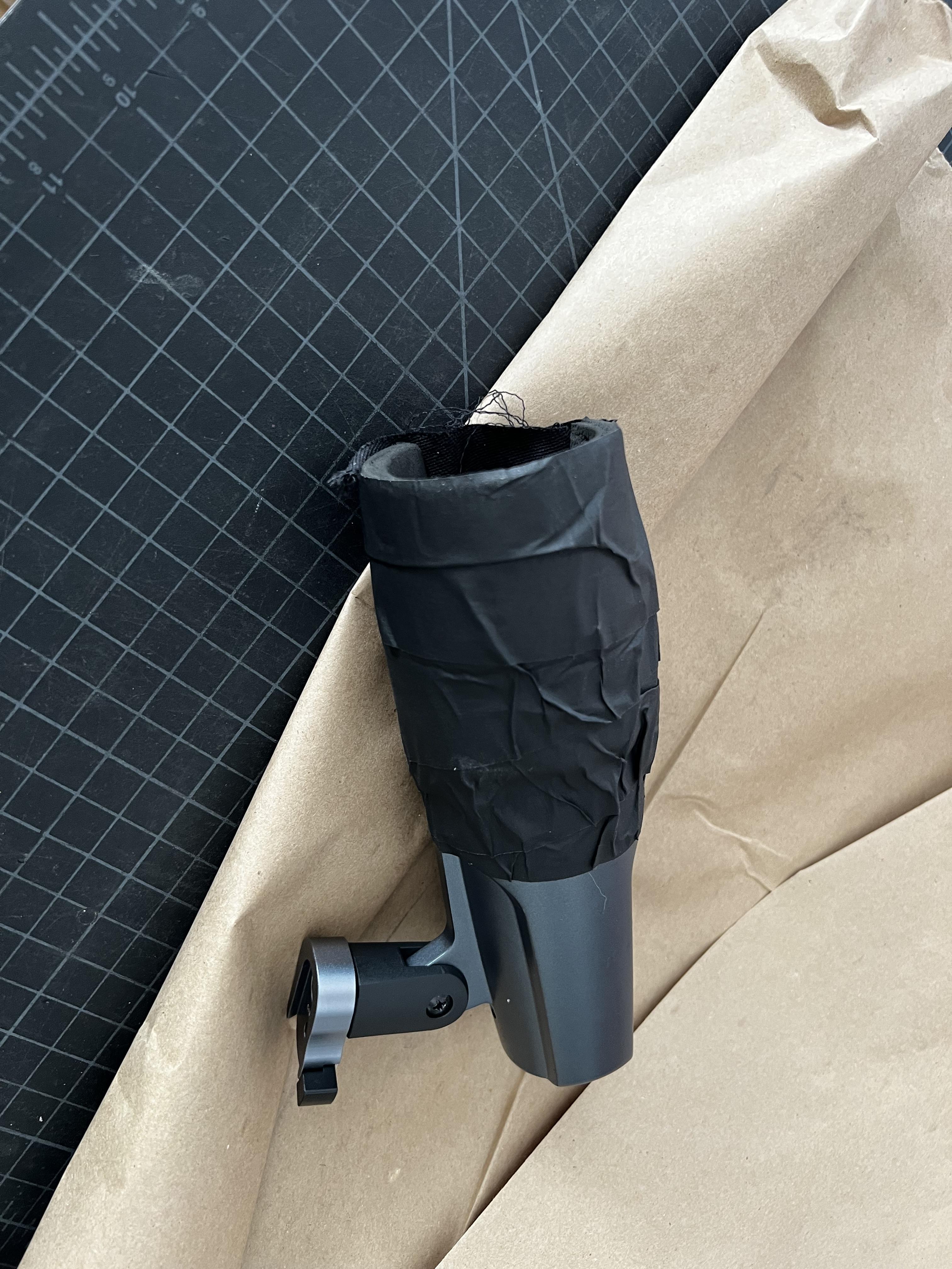

Wandering Ear Posted September 13, 2025 Report Posted September 13, 2025 Most of the time I get usable results with a lav for the exhaust on shoots with an arm car. I have done a few high performance vehicles who’s exhaust is way too loud to record on a lav/transmitter setup. For those my favorite mic is a large diaphram dynamic like a kick drum mic. If I can’t find a place to mount it while filming I ask for a sound only run that allows me to put mics outside the vehicle. I have had very little pushback with that request. i prefer a placement off to the side of the tailpipe and not directly behind it. It gets a deeper sound without any of the air turbulence noise. If the vehicle is travelling at speed I will sometimes create a wind tube using 1/4” neoprene stuffed with fur. Recently I used this technique on a group or Harley’s riding at freeway speeds with great results and no wind noise. Quote

Wandering Ear Posted October 27, 2025 Report Posted October 27, 2025 On 9/13/2025 at 6:40 PM, acdave said: Wandering Ear, Got any photos of the 1/4" neoprene wind tube rig or your other car audio rigs? Thanks! Ot looks terrible, but it works. Inside the neoprene is a piece of fur, and it’s held together with black paper tape. Quote
