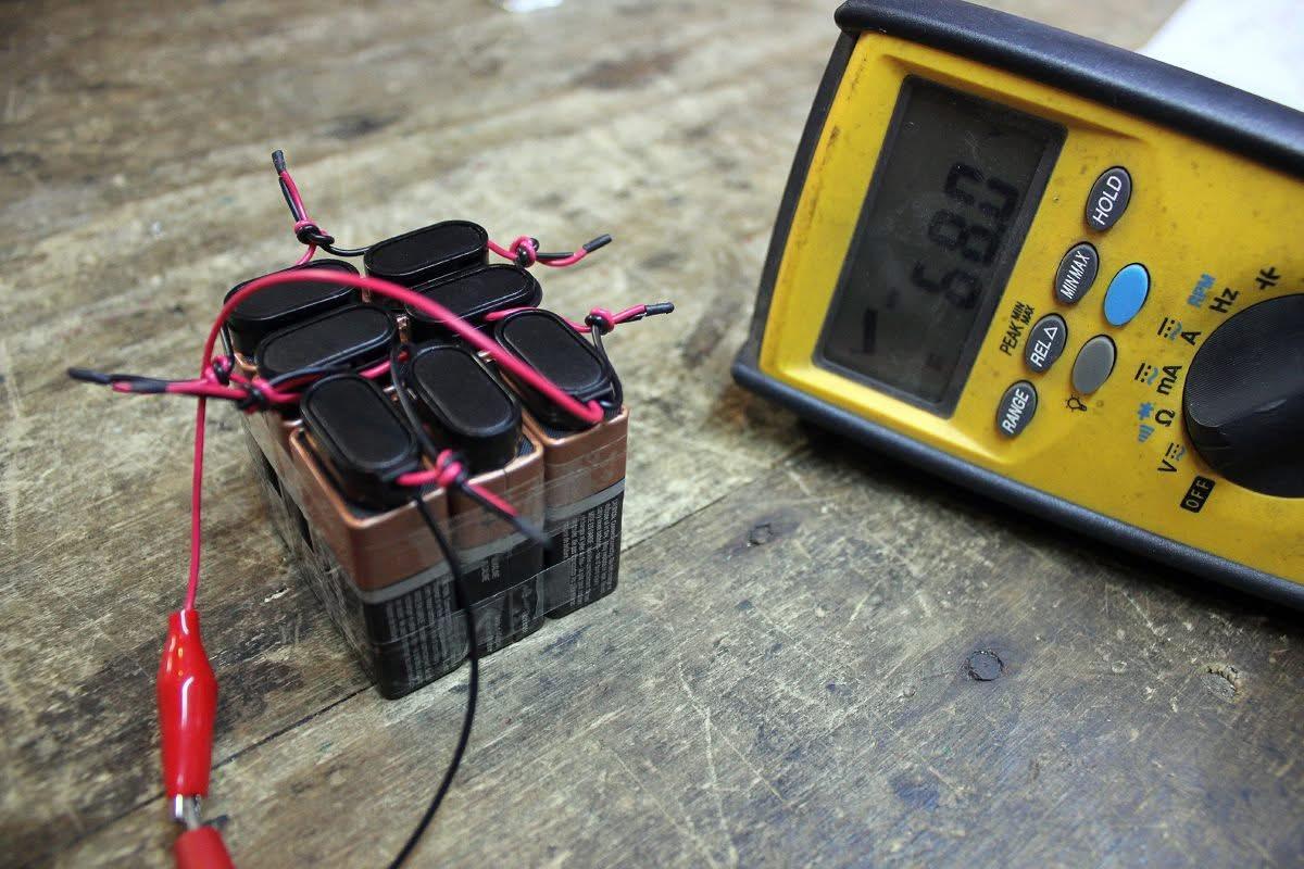

LDstudios Posted September 22, 2025 Report Posted September 22, 2025 Eh? Eh? Eh? I can’t remember the name of the specific battery (Duracell HT60?), but this was my garage mad-scientist wizardry (stupidity?) to get an old EMI tube ENG reel to reel machine up and running. Must have been from the late 50s or 60s. It certainly pre-dated the Nagra. It used a pair of 67.5v batteries to get the plate voltage up to ~130volts. Quote
