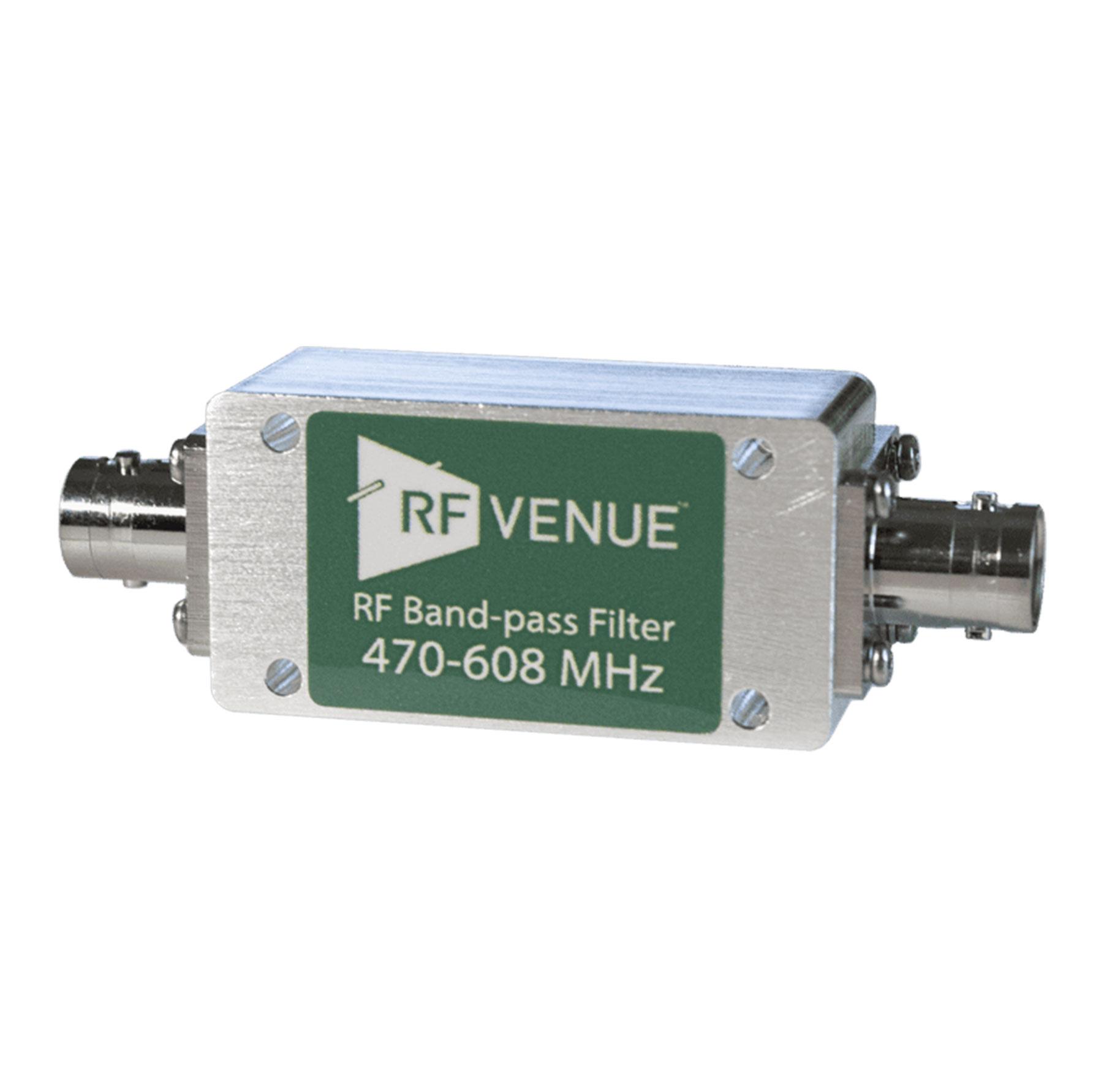

Conor Posted November 20, 2025 Report Posted November 20, 2025 Filters and attenuators exist for this reason and pair very well with the SNA600A. Quote

fieldsound Posted November 20, 2025 Report Posted November 20, 2025 I agree that here in Canada I would have no use for one of the newer dipoles with reception into the gigahertz territory because I never work above 663 mhz. Personally I like my Betsos a lot and they’re essential to my workflow. I use them with Wisycom wide-band, and I will sometimes go from working in 500 mhz to the duplex gap in the same day. I use a BSRF AS84 RF distribution and filter, and simply tune the narrowband filter to whatever area of the spectrum I’m working in. This system has proven to be extremely robust. Quote
