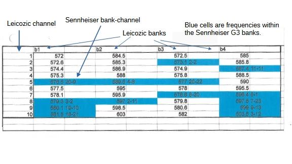

Paul F Posted December 17, 2025 Report Posted December 17, 2025 7 hours ago, foliver said: The Leicozic can be used with senns transmitters? Yes. The ones I have operate in the Sennheiser G band as you can see in the attached table. It has 40 frequencies of which, 14 (blue cells) operate within the Sennheiser pre-arranged 'safe for intermod' frequencies. But of course, if you have something like TXAdvance, then you can sort out the intermod spacings yourself. Quote
IronFilm Posted December 25, 2025 Report Posted December 25, 2025 On 12/18/2025 at 12:15 AM, foliver said: Thanks all for your replies. I've some G1 ( tankss) and G4's ( 10 total) along with some comteks that i don't use anymore. The Leicozic can be used with senns transmitters? Yes, it's not a perfectly exact match what they use vs the compander used by Sennheiser wireless systems but it close enough to "work". Just like when you mix and match Sennheiser and Lectrosonics wireless in the right compatibility mode. Then the other issue is having matching frequencies on both the Leicozie IEM receiver and the Sennheiser transmitter, and again they won't be a perfect 1 to 1 match up for all the frequencies that both the Leicozic and Sennheisers can do, but as @Paul F pointed out you can make it work and find enough that are the same on both that it is workable. So basically if you work a lot in densely RF-polluted environments on mission-critical shoots, then you could find Leicozic is not for you. But I'd say for most of us, if we're smart about it (i.e. planning ahead with common sense frequency coordination), then they're more than "good enough" to get the job done. Certainly I personally have no complaints after using them for many years. Quote
