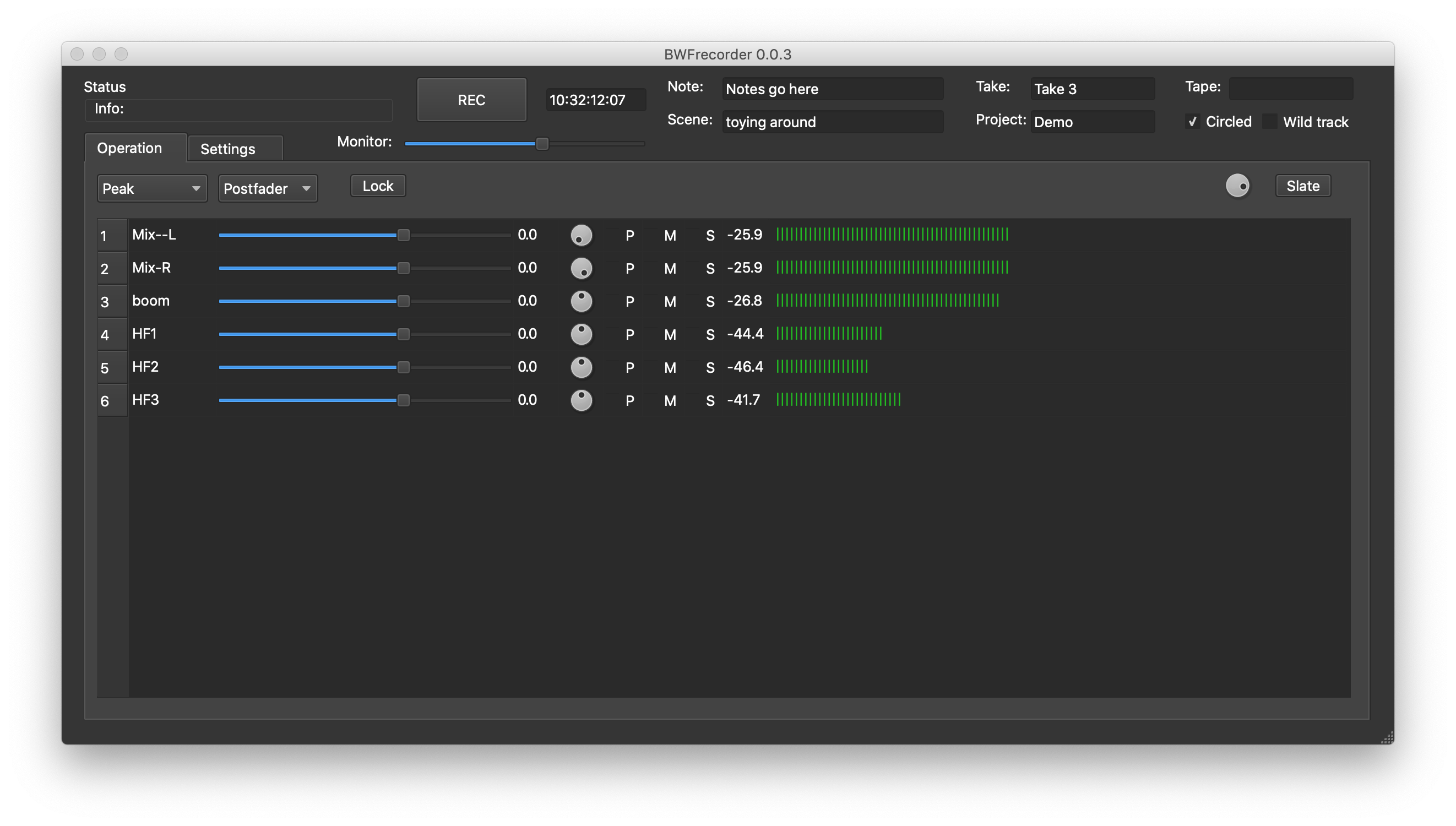

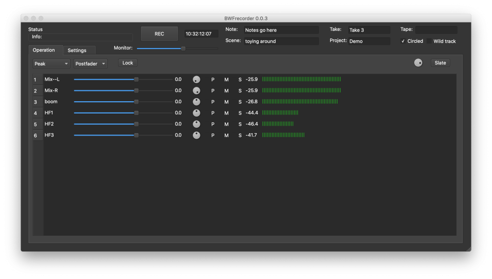

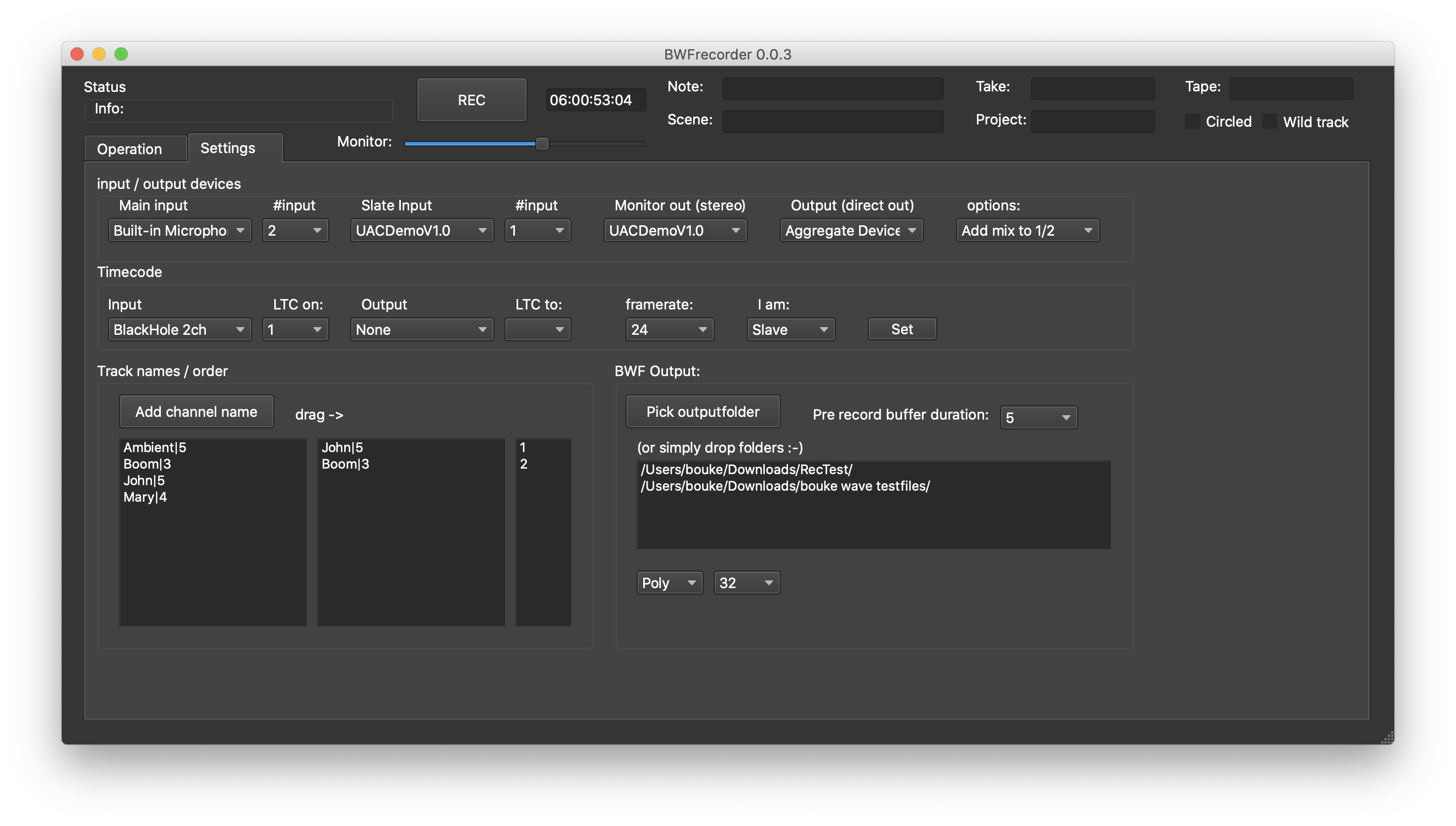

Bouke Posted March 10 Report Posted March 10 no-nonsense recorder. No eye candy, just functionality. Record unlimited tracks, with a mixdown, in 24 or 32 bits. (Well, the software is unlimited, no clue when hardware becomes the limiting factor...) Record to multiple locations Playback with all tracks under the faders again Customisable pre-record duration Pan / mute / solo / phase reverse (I added the last one cause it's just 'chan = chan * -1', as proof of concept that a M/S setup is easy...) Looooong faders (if you have a wide screen...) Buffer in case of slow / disappearing drives. (Files that are ripped during record are totally usable without any help!) Add metadata, even while recording Changing metadata, on 'any' BWF file, with an embedded backup in the file. Mute / solo for monitoring (that will NOT end up in the files / hop / direct out) Slate button to insert separate mic in Mix Left (does anyone still use that?) Lock function so no unwanted changes are made. TC in- and output, even with modern HFR framerates (up to 999 fps) up to 3 different devices for IO connection (I can imagine you don't want your expensive HQ card sacrifice channels for dirty slate talk / TC, a 5 buck USB thingy will be good enough for rock 'n roll.) ToDo: - make a second page for the faders where they act as gain, that will also end up in the ISO recording. - add password / secret keycombo for lock function - whatever you like to see Known issues - dust in the panpots, it might crackle on turning. (no issues when in a fixed position) Quote

Bouke Posted March 20 Author Report Posted March 20 49 minutes ago, codyman said: Is your goal to be able to "mix in the box" in addition to recording ISO's? Yes of course, it does that already, did you not try? Did you even switch to the 'operate' page? You end up with a MixL and MixR on top of all Iso's (that are unaffected at the moment, I could build in a gain for that.) The Monitor output has the mix only, but the Monitor output differs from Left / Right that it honours Solo and Mute. 49 minutes ago, codyman said: There is something to be said if all audio could go into an interface It supports THREE interfaces at the moment := ) TC and Slate could be different devices. For output, TC, monitor and Hop can be three different devices also. (At the cost of a bit of latency on sound. TC is predicted / can be made in advance, so that should not be an issue in latency.) 49 minutes ago, codyman said: control surface to create a "mix" in the box It now has mouse faders ... I can of course add hardware MIDI faders, but that means 'work'... I take it this is a bit of a backup / panic product, as you probably want to bill for you expensive black box recorder. So no idea how much it will be used in real life. Oh, there is a manual, look at it. And, I've found some turkey's of course, the link is updated, you might want to re-download. (Some stuff with playback not showing the proper channel names.) Quote
