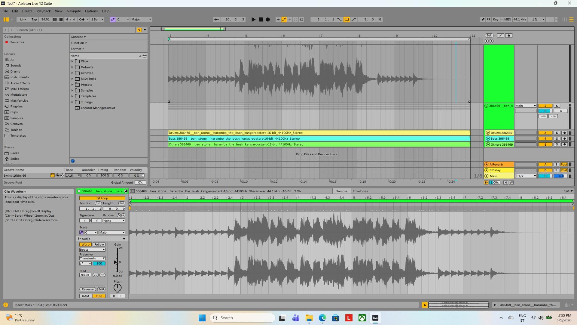

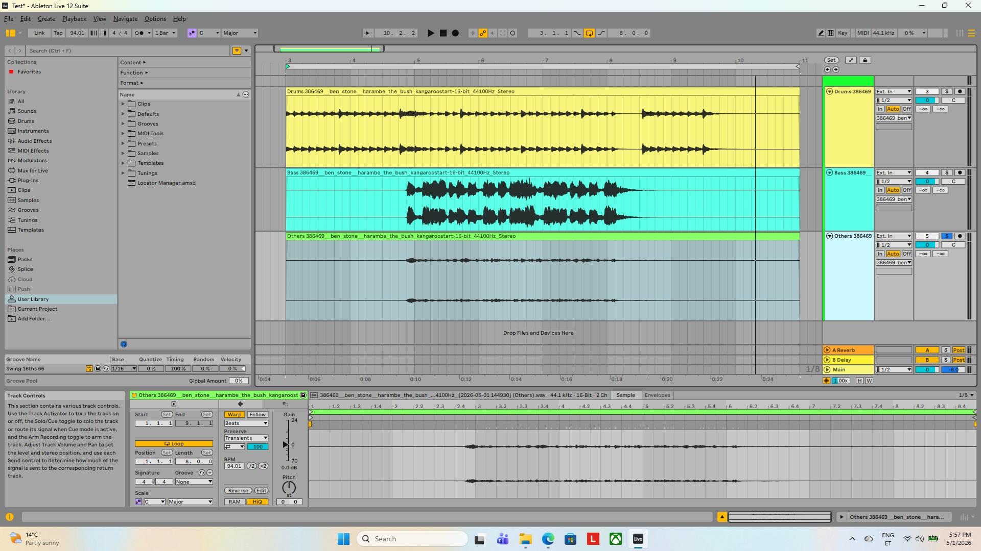

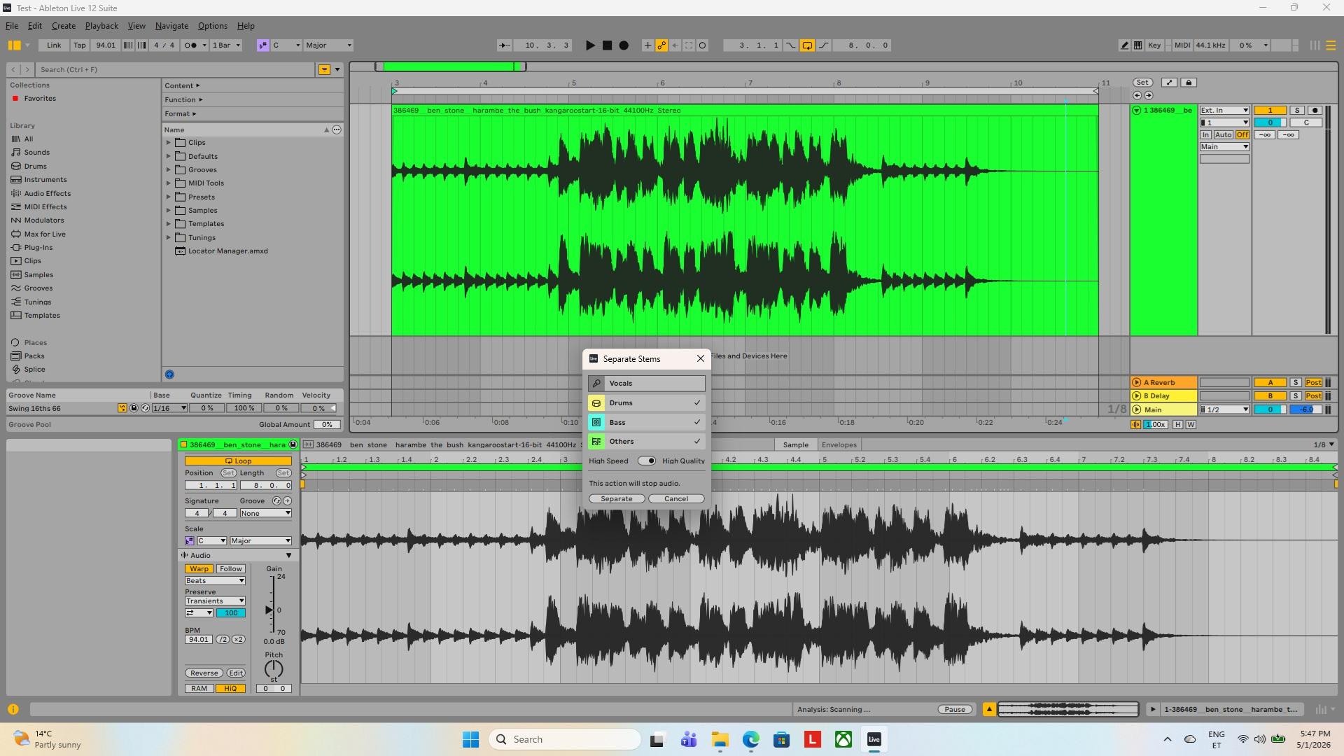

Ableton Live 12 Suite has an audio separator feature that easily separates into four individual tracks / stems: Vocal, Bass, Drum, and Other. NB! This feature is only available in the more expensive Suite version! And it works well!

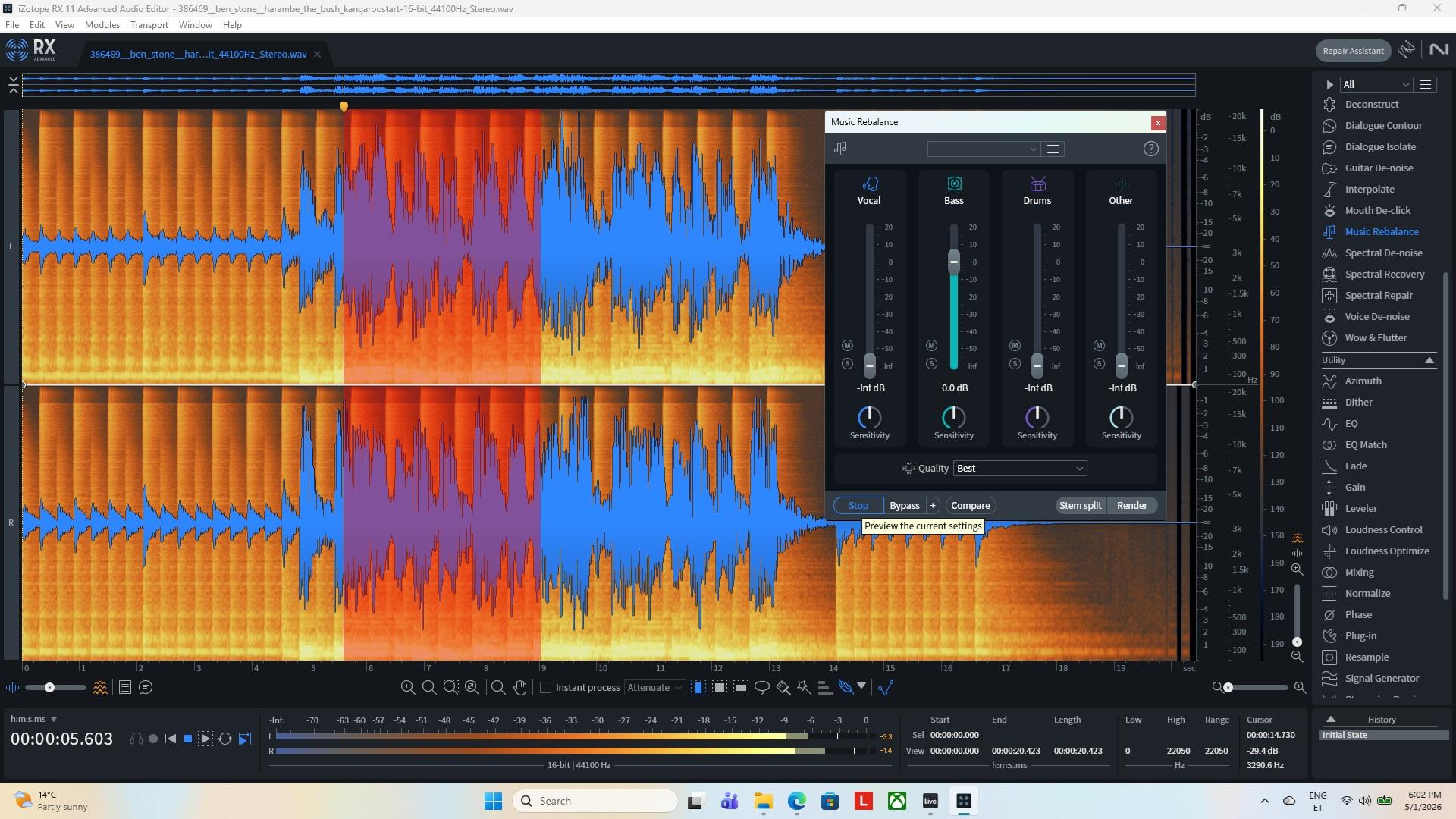

iZotope's RX Advanced is another option but it's expensive

I use both iZotope RX and Ableton Live 12 Suite. Both do a great job, but for this specific task Ableton works slightly better. Of course, it all depends on your needs! For example, RX is much better for Music Rebalance — if you need to adjust the level of the vocal (or bass, drums, or melodic instruments), I don’t know any tool that does it better.
