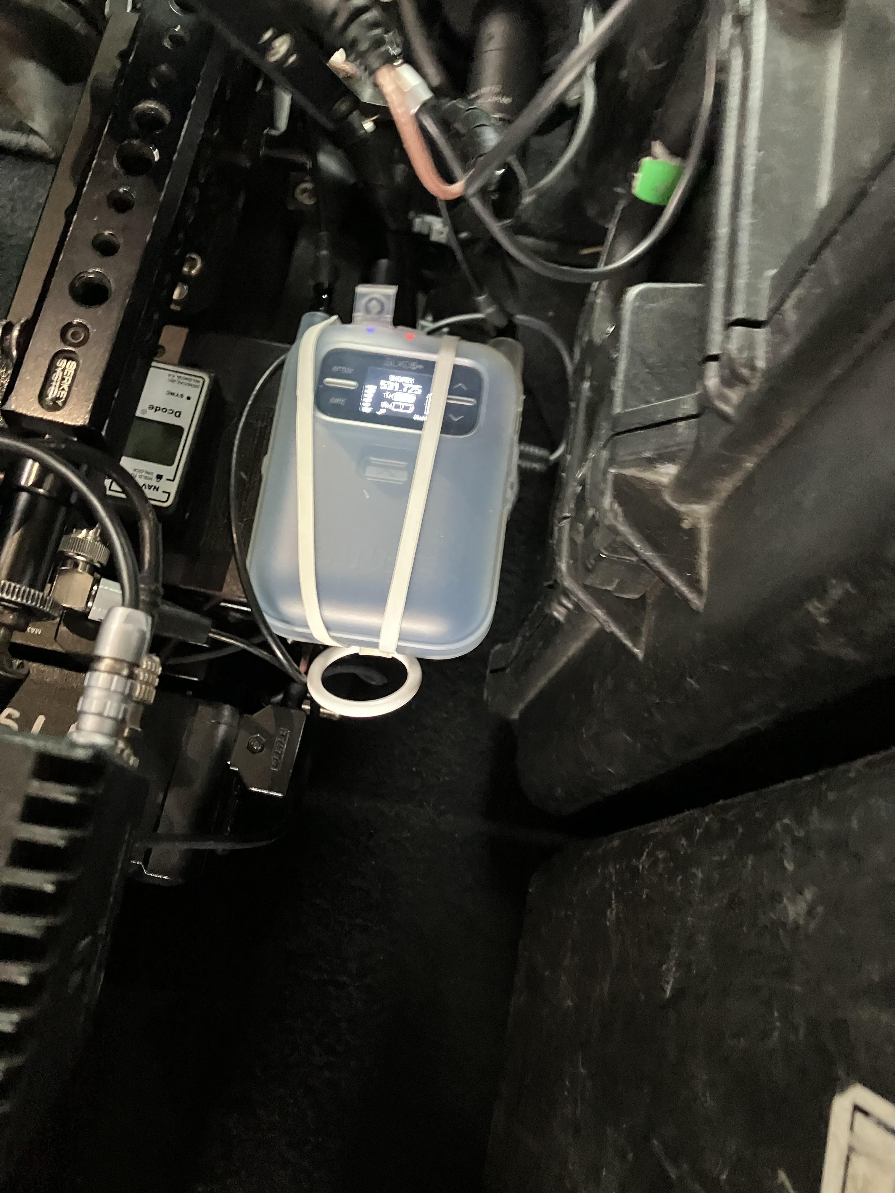

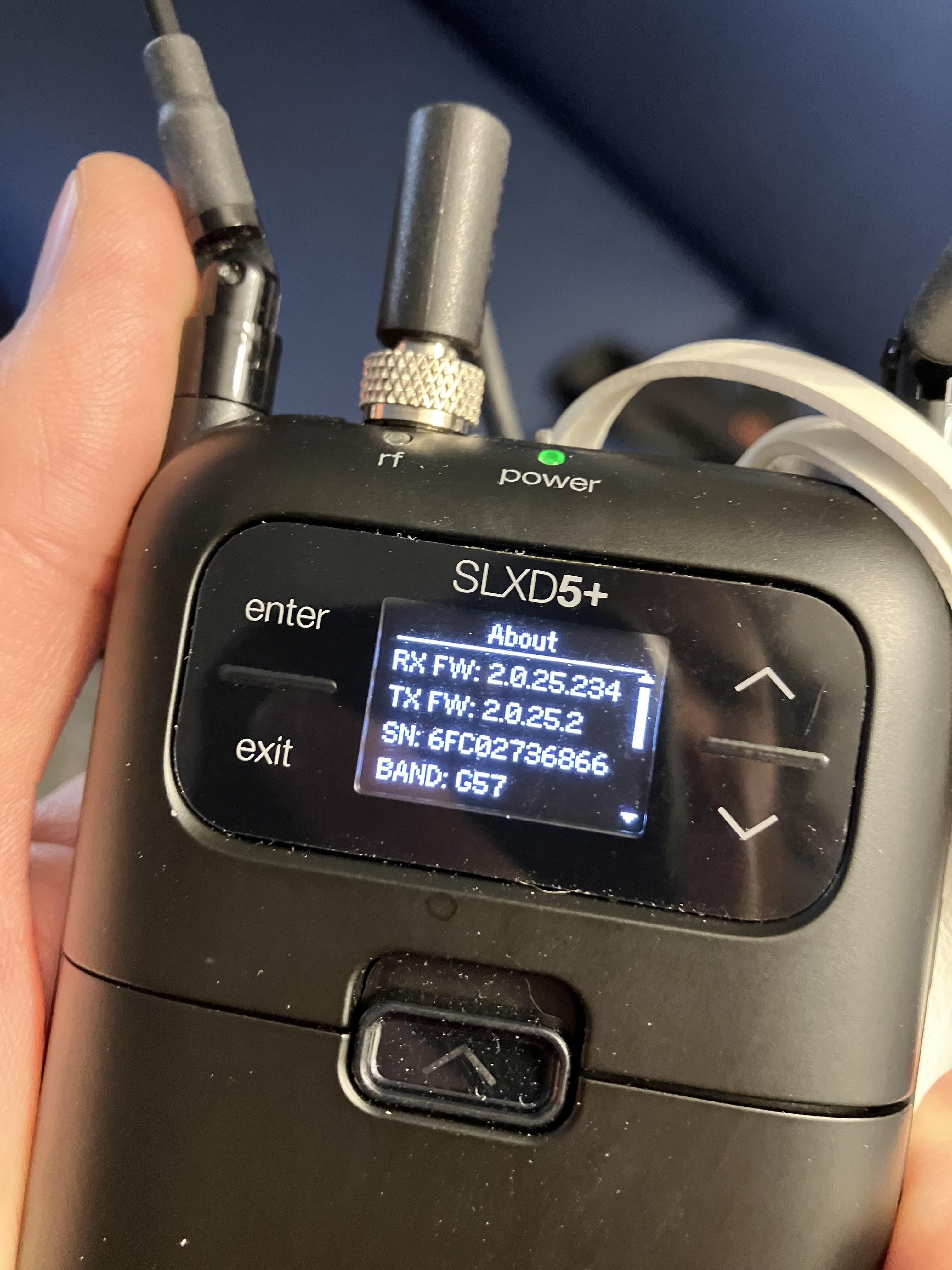

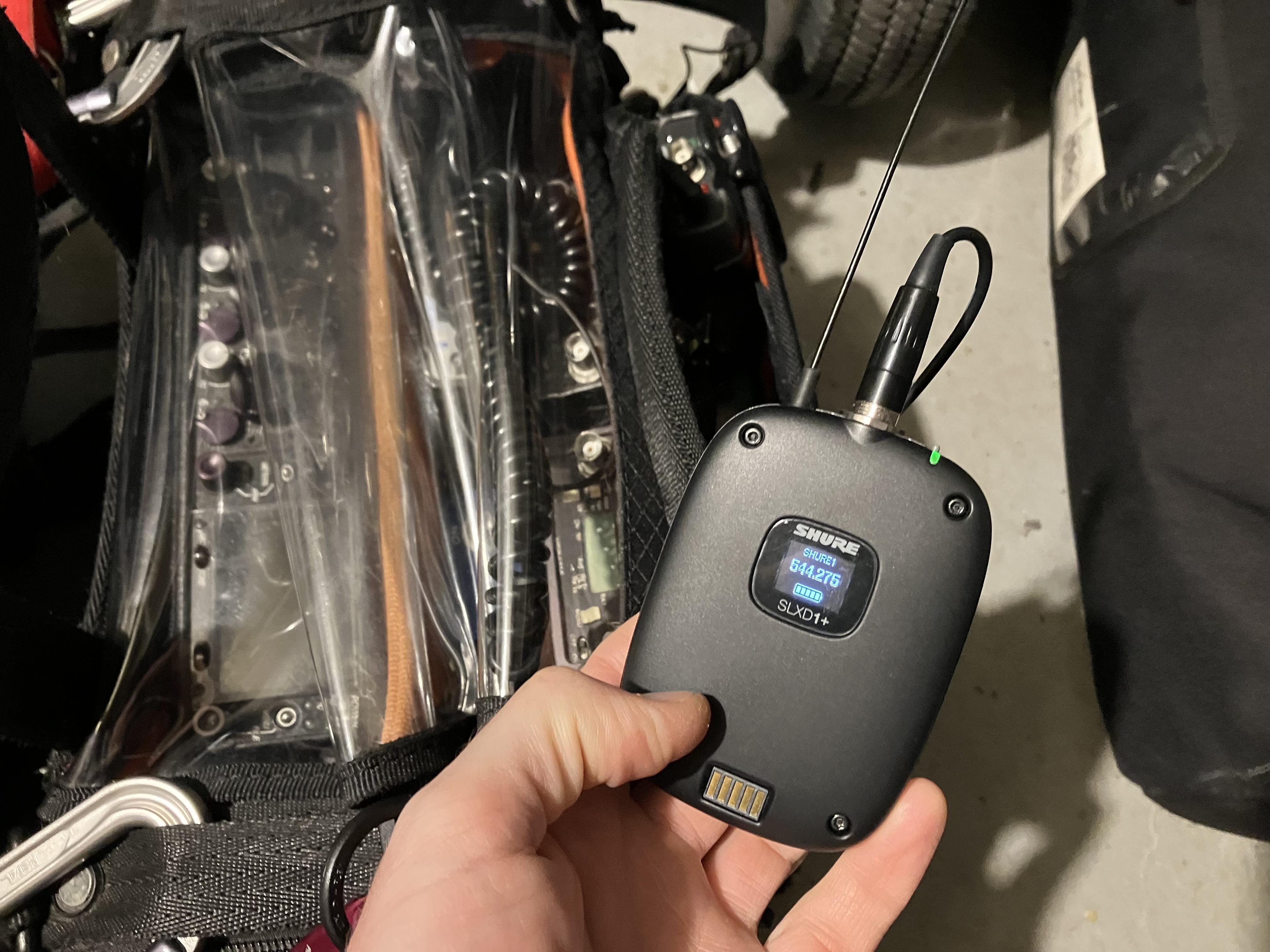

Derek H Posted April 28 Report Posted April 28 Just wanted to take a few minutes and endorse using the Shure SLXD15+ kit for camera hops. I just completed a documentary shoot using the SLXD1+ transmitter in my bag and the SLXD5+ body pack style receiver on camera. Didn't have any issues with it and seemed to play really well with the other equipment in my bag. Didn't notice any RF bleed over onto my Lectro 411s or SRb despite being placed very close to them and no unusual whining noises induced into the Comtek, just worked as advertised. Well, not really as advertised because Shure doesn't advertise using the SLXD1+ in a sound bag as a point-to-point link like I was doing here but you get the idea. Things I liked: - All metal receiver with solid, no-nonsense battery door. - Nice, physical on/off switches and bright top mounted LEDs to indicate if it's on/off or low batt. - Locking TA4F input connector on the transmitter. - Receiver ran 9 hours on 2x XTAR rechargeable lithium AAs (4150mWh version), the transmitter ran significantly longer. - Balanced output mode available from the receiver's 3.5mm jack (or dual mono for a DSLR, selectable in the menu) - Strong line level output, could easily feed the line level input on a Sony F55. This is really great. - Wideband 470-608. Easy to slot one channel in around all your inbound wireless. - Transmitter magically follows channel changes made on the receiver, even if the transmitter is off during the change (as it should be if you're scanning for a clean freq). Also, has an optional auto freq-hopping mode for dealing with interference though I didn't try that. - Channel scan works well Things I don't love. - Gain staging...Gain-adjustment-free input on the transmitter. It doesn't even have an input level meter on the transmitter or any way to indicate an overload. That said, it has a very wide-dynamic range input and as long as I had my 633 set to -10 I could not get it to audibly clip or distort, even with the 633 limiter off. This kind of dual A/D (or maybe it's dual preamp?) is not something I'm used to yet. There is a "trim" control in the transmitter menu but this a digital trim post-A/D and is only meant for matching two different types of mics. Say you alternate between a handheld and a body pack on the same receiver channel and you want them to match without touching the receive end of things. - Level meter on the receiver shows post-output-gain-trim levels and as such is kind of confusing. If you're used to a receiver showing you the transmitter modulation regardless of where the Rx output level is set then this takes a minute to get your head around. You'll find YouTube ding-dongs saying that the receiver remotely controls the transmitter gain but that is false. In my case setting the 633 output (X1) to -10 and all the "trim" controls on the the SLXD+ Tx/Rx units to 0 just about perfectly aligns both meters when you send a full-scale tone. The receiver indicates a slight overload but this is not audible, it sounds totally clean. Setting the receiver output to -2 or -3 dB clears the overload warning and that's what I went with. I need to confirm with Shure if the output level setting on the SLXD5+ is just digital gain or an actual amplifier stage but I'm assuming the latter for now. I tried running the 633 output to the SLXD1+ transmitter at mic level but this required a large amount of gain on the receiver side to properly feed a line input and introduced hiss. I decided to roll with my -10 configuration. Full line level out of the 633 was a bit too hot for the SLXD1+. I suppose a pad could be calculated and a special cable made but -10 seems to be very functional and keeps cable construction simple and more reliable. - No battery eliminator option for the SLXD1+ transmitter though I suspect you could remove the battery door and just use the same unit they make for the SLXD5+. Would be slightly sketchy though with no door to hold it in place. - Channel scan doesn't give you a graphic of the whole tuning range like you get with most pro wireless. It's like a G3 that way it just tells you the best group and then which channel is best via a text display. - Antennas are all permanently fixed. Seems like a matter of time before a camera op or AC finds a way to damage one. Not how hard the repair would be, not ready to open this puppy up yet. Still has the new smell. - Shure's documentation basically sucks and is lacking some answers that should be in there. Emailing Shure for answers also sucks and takes days to hear back and don't bother asking more than one question per message because they will only respond to one at a time. Shure thankfully has some helpful FAQs posted but you have to dig around in there to find what you need. I also hate how their website is firstly a sales shop. Just makes it irritating all around. Other Thoughts: - For sending a high quality mono-mix track to a camera this system seems like a winner. Price-point is correct for this use-case in my oppinion, sound quality is a step up from an analog Sennheiser system and the ergonomics and build quality is solid. - It has very nice modern features like the remote control channel switching which does save time and just works without having to fart around too much. - Though not a definitive test the remote control signal did not seem to interfere with the camera department's stuff at all. - Watched Nick Houston's Gotham NAB interview with Amanda Beggs at the Shure booth who seems to be using these for all sorts of fun aux purposes and uses the SLXD plug-on transmitters for everything. This is interesting. I was torn on which transmitter to order and I wonder how the plug-on compares to the body pack transmitter. More RF power with the former (30mW vs 10mW) but proper whip antenna with the latter. I asked Shure but they forgot to respond or are too busy selling SM58s to everyone on the planet. Amanda, if you're reading this and have an opinion to share please let me know! - Shure sells a nice silicone rain guard for the SLXD5+ that might help you in a light rain. Oddly, it only protects the side with the battery door and screen as well as the top connectors. - SLXD5+ receiver has a dedicated headphone jack kind of like the prosumer Sony's. Has a separate volume control that you can map to the front arrow buttons. Seems to work well and was able to drive a pair of 70 Ohm HD25s to loud levels but wearing this thing as an IFB would not be ideal, antennas are not flexible enough to be comfortable on a belt or waistband, kinda too heavy as well. Nice feature to have anyway and maybe good IFB alternative for a boom op who wouldn't mind the weight and a dedicated pouch or something but not so much to hand off to a director or village plebs. - Firmware updates are easy enough. Requires Shure's sort of goofy update-everything-we-make utility and take a LONG time. I thought something was wrong and I was going to brick it but it did eventually complete after 20 minutes of chugging along. You update just the receiver and load the transmitter firmware into the receiver as well and then you update the transmitter wirelessly via the receiver. Fun. Well there you go. Quote

codyman Posted April 29 Report Posted April 29 Any reason you didn't go with the plug on transmitter instead? For bag transmission, I feel that going directly into XLR would be easier to deal with? Quote
Derek H Posted April 29 Author Report Posted April 29 Because I wanted the whip antenna. Plug-ons are designed to use a handheld mic body as their antenna. I was concerned that without a mic plugged into it the transmission would be compromised. Probably would work just fine though. The plug on has more RF power available and a built-in pad. Quote

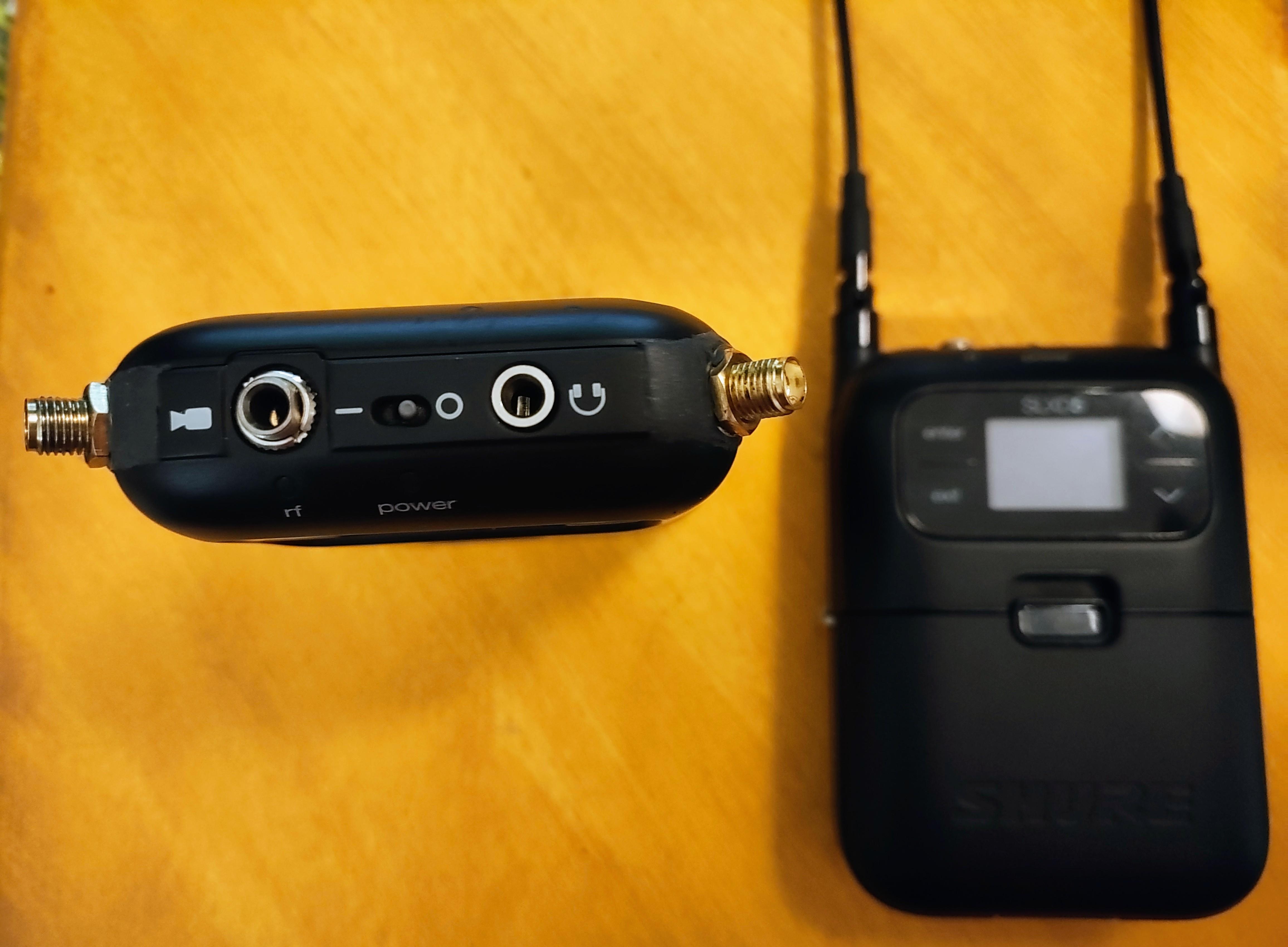

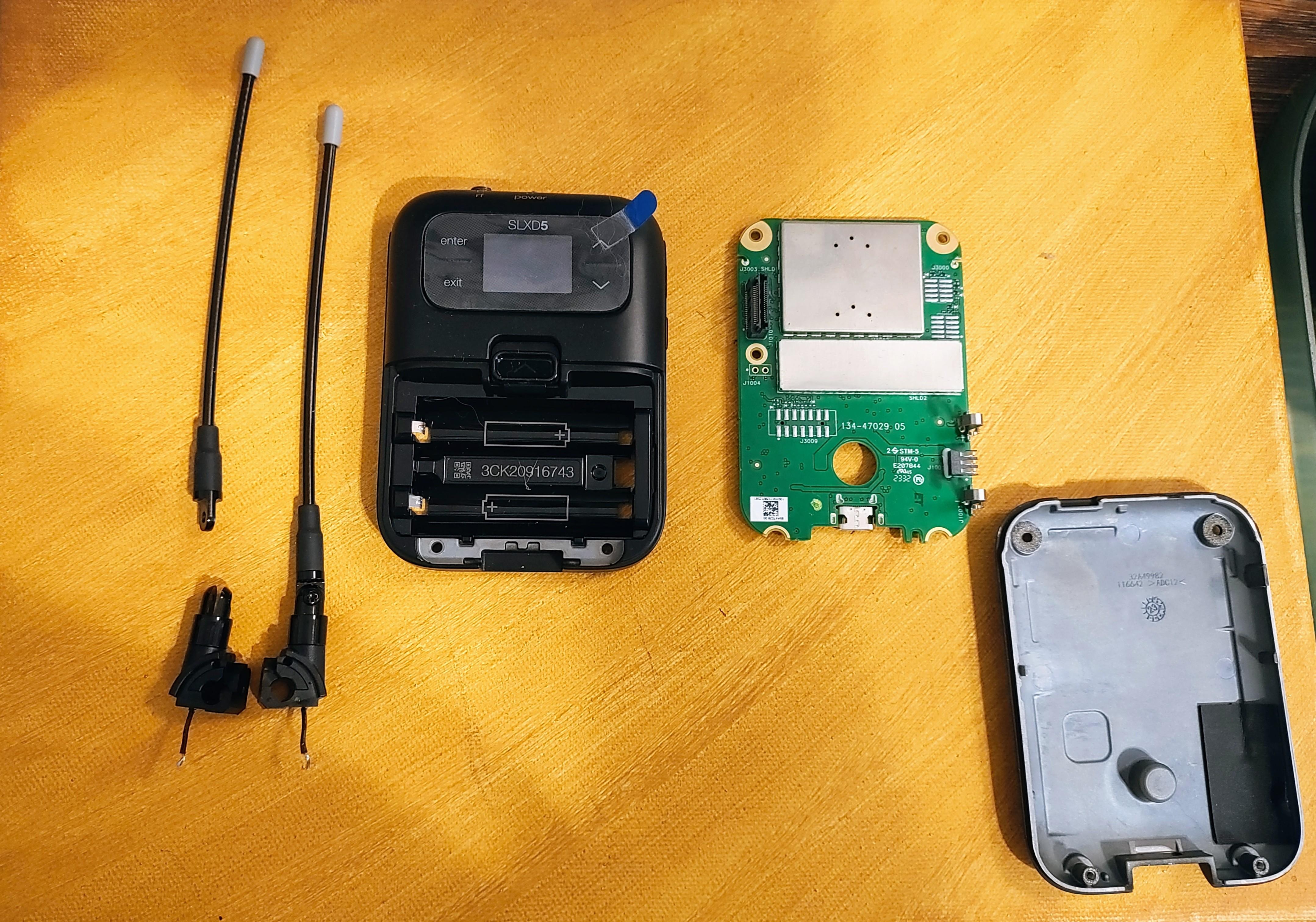

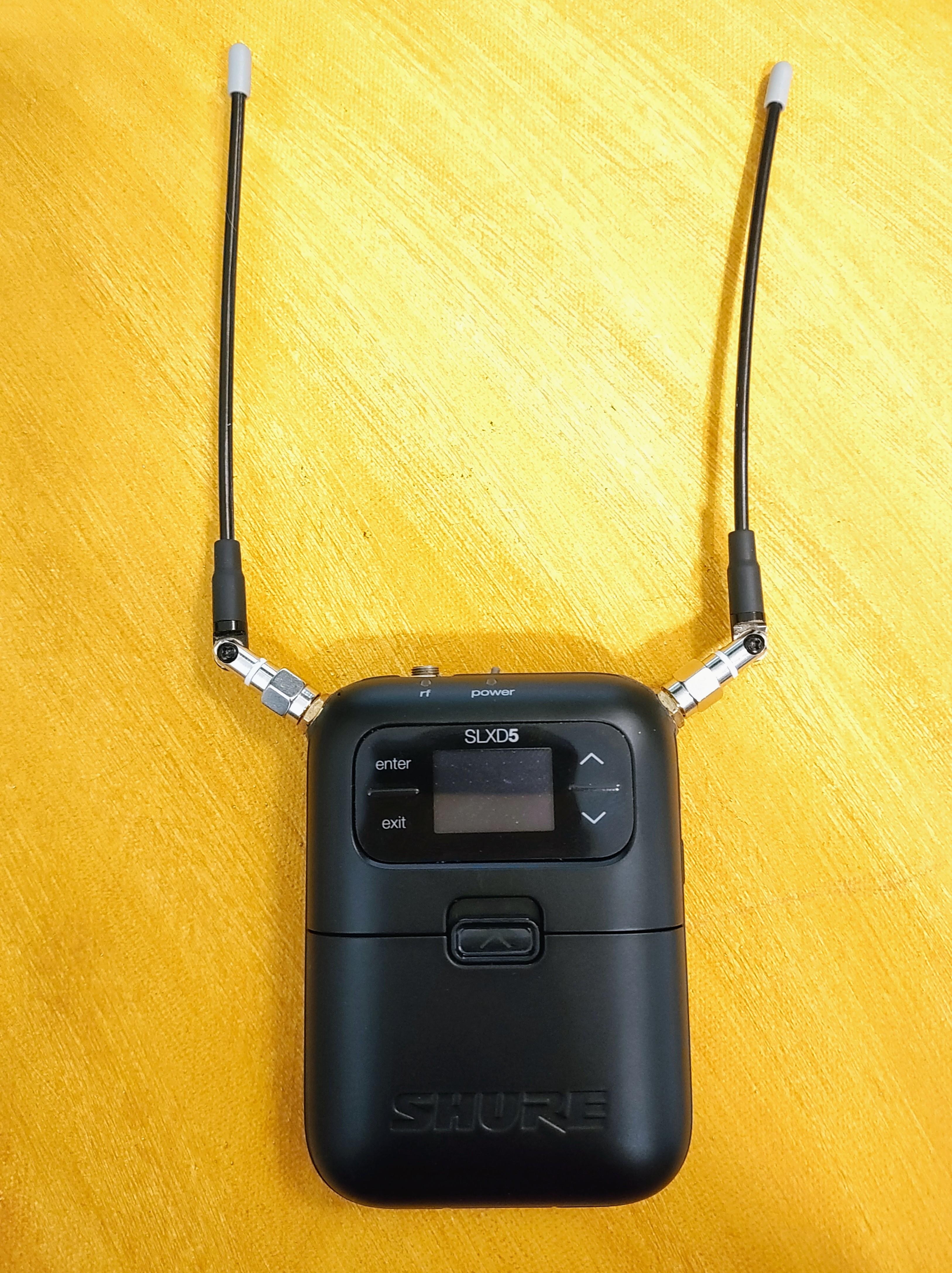

Pocketsizesound Posted September 1 Report Posted September 1 It will look more presentable with some 3D printing (when I get around to it) meanwhile I present the prototype "Viking SMA Mode" Works as should. We mostly use these Shure with a stationary rack receiver for live events, but the usage is expending. Quote
Olle Sjostrom Posted September 2 Report Posted September 2 If you rebrand them Shore, the Viking reference is even clearer. If you have a ROW of them it'll be even clearer. Nice job! Quote
johngooch Posted September 2 Report Posted September 2 Very interested in SMA mod for SLX RX.... NIce job. j Quote
Pocketsizesound Posted September 6 Report Posted September 6 On 9/2/2026 at 1:36 AM, Olle Sjostrom said: If you rebrand them Shore, the Viking reference is even clearer. If you have a ROW of them it'll be even clearer. Nice job! Hehehehe, that's a good one I can't believe I haven't thought of it, heheh Quote
Pocketsizesound Posted September 6 Report Posted September 6 On 9/2/2026 at 1:33 PM, johngooch said: Very interested in SMA mod for SLX RX.... NIce job. j Hi, we don't have any SLX on hand currently....Though I used them in the past and it's probably not too complicated. Quote
