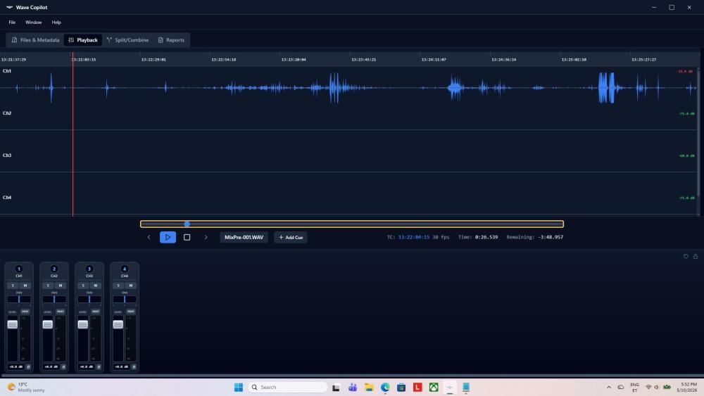

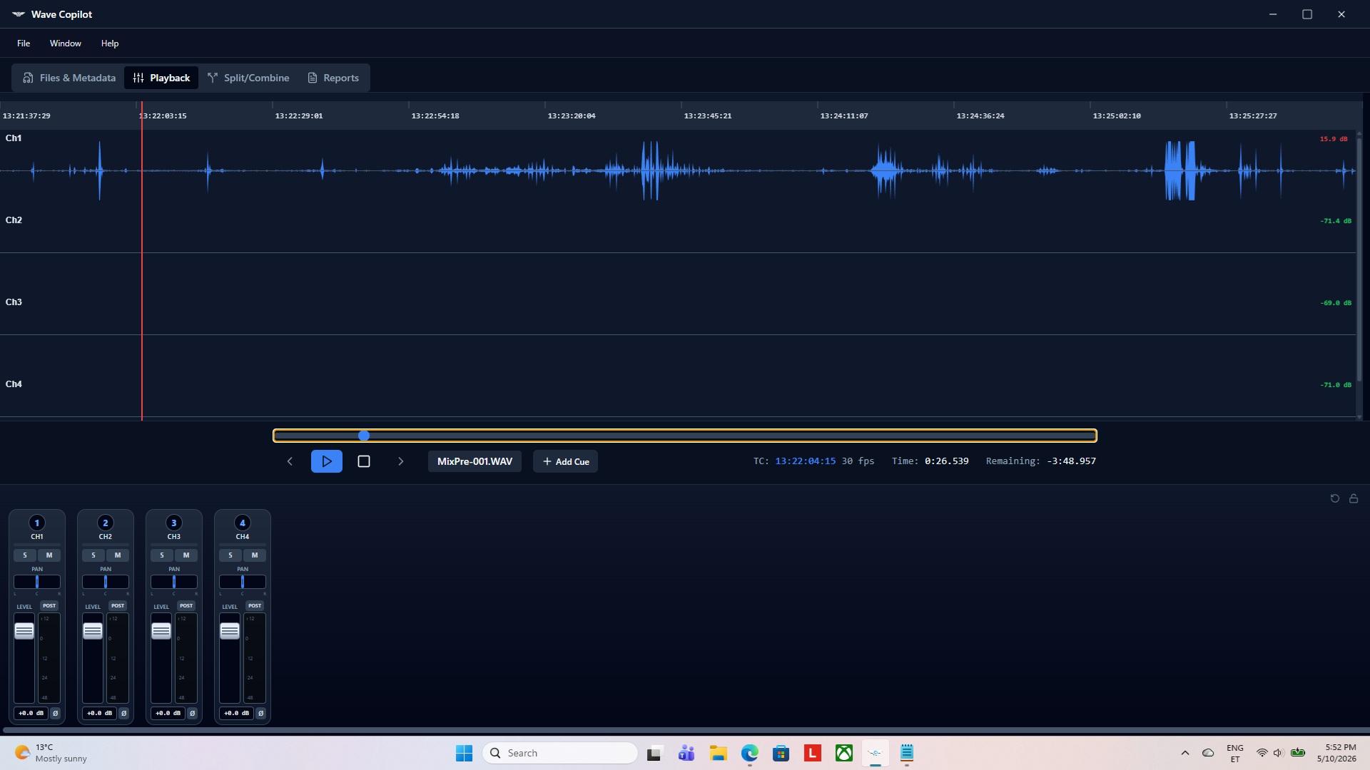

inspire Posted May 10 Report Posted May 10 I agree with this suggestion. In real production workflows, it is actually quite common to intentionally leave a backup recorder armed and recording even if a microphone is temporarily disconnected or not in use, simply because it is safer than accidentally missing a recording entirely. I also noticed that in the Playback view it is already visually quite easy to spot tracks that contain only silence or near-dead air (see attached screenshot). Because of that, I think some kind of optional visual flag or warning indicator for likely empty/silent ISOs could be a very useful workflow enhancement. Not necessarily anything complicated — even a small icon, marker, or “possible dead air” indication could help users quickly avoid accidentally reconforming empty tracks into new poly files. Also, thank you for the clarification regarding panning information and poly WAV metadata. That explanation was very helpful and clarified a lot for me. Interestingly, I have noticed that with the Tascam Portacapture X8, the pan information seems to carry over correctly between files. However, the Portacapture X8 does not record in poly WAV format, so that may explain the difference in behavior. Quote
Matt Nantel Posted May 10 Author Report Posted May 10 1 hour ago, inspire said: I agree with this suggestion. In real production workflows, it is actually quite common to intentionally leave a backup recorder armed and recording even if a microphone is temporarily disconnected or not in use, simply because it is safer than accidentally missing a recording entirely. I also noticed that in the Playback view it is already visually quite easy to spot tracks that contain only silence or near-dead air (see attached screenshot). Because of that, I think some kind of optional visual flag or warning indicator for likely empty/silent ISOs could be a very useful workflow enhancement. Not necessarily anything complicated — even a small icon, marker, or “possible dead air” indication could help users quickly avoid accidentally reconforming empty tracks into new poly files. Also, thank you for the clarification regarding panning information and poly WAV metadata. That explanation was very helpful and clarified a lot for me. Interestingly, I have noticed that with the Tascam Portacapture X8, the pan information seems to carry over correctly between files. However, the Portacapture X8 does not record in poly WAV format, so that may explain the difference in behavior. On the playback tab, each channel shows its peak dB level in the top-right corner. Thank can give you an indication if the track has some data, but I agree that it would be nice to have an notice when conforming to make sure you don't replace the track with something empty. Quote
