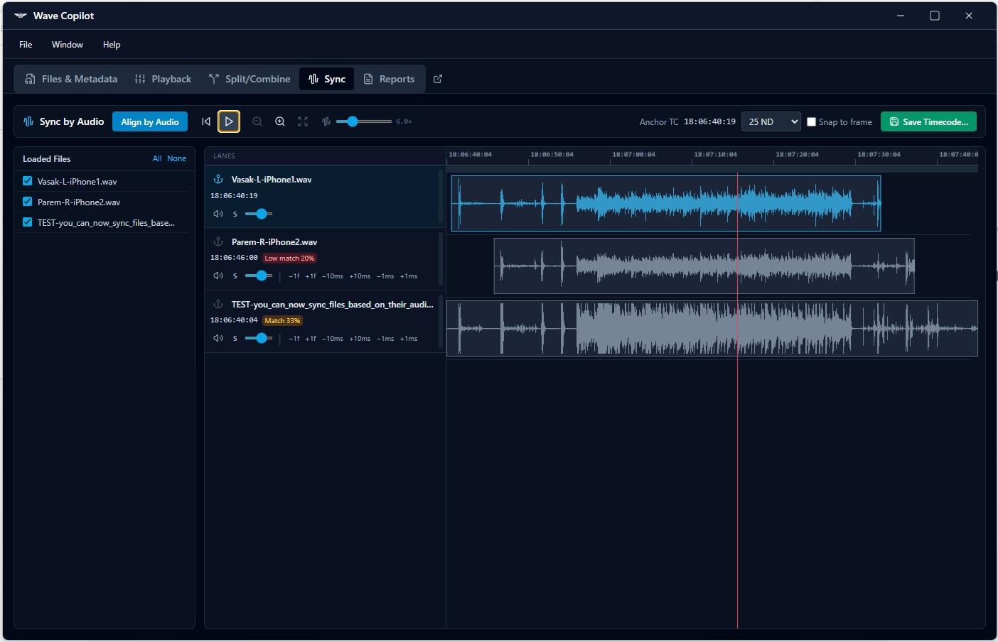

inspire Posted August 8 Report Posted August 8 I have now tested the new “Align by Audio” feature with two recordings made on separate iPhones, plus a third independent stereo recording. It works very well! I can see the alignment clearly in the waveform display, and the result looks great. Very useful feature! I also figured out the Playback part, including the panning, so that works well too. The only thing I haven't figured out yet is how to export or save the two aligned mono files as a single stereo WAV file. What would be the correct workflow for this in Wave Copilot? Quote

inspire Posted August 8 Report Posted August 8 I have uploaded the test files to my private server: http://37.0.31.83/TEST-you_can_now_sync_files_based_on_their_audio_content/ Vasak-L-iPhone1.wav Parem-R-iPhone2.wav Recorded with a Schoeps MSTC 74 microphone and a Sound Devices MixPre-6 II STEREO.wav The two iPhone files were converted using iZotope to make them compatible with the Schoeps MSTC 74 stereo recording, so that they can be combined together. I have two questions: Question 1: How can I combine the two iPhone mono files into a single stereo WAV file? I assume this should be done using the Combine function? Question 2: How can I combine the two mono iPhone files and the existing stereo recording into one combined file, with everything properly aligned and in sync? Is this already possible in the current version? A short step-by-step guide would be very helpful. Thank you! The iPhones is placed according to the A/B Stereo Recording Technique, and the Schoeps MSTC 74 is positioned in the center. Quote
Matt Nantel Posted August 8 Author Report Posted August 8 33 minutes ago, inspire said: I have uploaded the test files to my private server: http://37.0.31.83/TEST-you_can_now_sync_files_based_on_their_audio_content/ Vasak-L-iPhone1.wav Parem-R-iPhone2.wav Recorded with a Schoeps MSTC 74 microphone and a Sound Devices MixPre-6 II STEREO.wav The two iPhone files were converted using iZotope to make them compatible with the Schoeps MSTC 74 stereo recording, so that they can be combined together. I have two questions: Question 1: How can I combine the two iPhone mono files into a single stereo WAV file? I assume this should be done using the Combine function? Question 2: How can I combine the two mono iPhone files and the existing stereo recording into one combined file, with everything properly aligned and in sync? Is this already possible in the current version? A short step-by-step guide would be very helpful. Thank you! The iPhones is placed according to the A/B Stereo Recording Technique, and the Schoeps MSTC 74 is positioned in the center. Have you tried what I commented on your previous post? Quote

inspire Posted August 8 Report Posted August 8 I managed to get it working now! It is actually quite interesting — and a little mind-bending at first. 😄 You really have to know exactly what you are doing, but it does work. The workflow is not something I would have thought of immediately. As you explained, Wave Copilot creates separate files such as: Parem-R-iPhone2_poly_backup.wav Vasak-L-iPhone1_poly_backup.wav with the necessary empty sections added where the recordings were missing at the beginning, so that everything is correctly aligned. I then split those two poly backup files into their individual components again and imported the correct pieces into my DAW. So yes, it involves quite a bit of playing around and you definitely need to understand what you are doing — but the final result is correct and everything is in sync. I did not include the separate stereo recording in the final result — I only used it as the reference for the alignment test. So, my test was successful! 🙂 Quote
