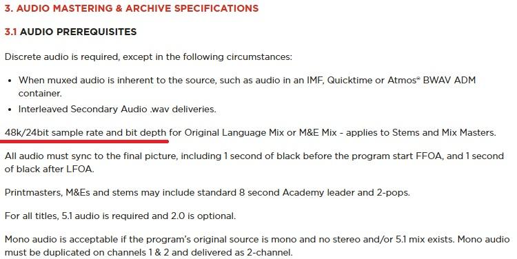

Jason Nightall Posted July 14 Report Posted July 14 I On 5/15/2026 at 5:58 AM, Jason Nicholas said: He told the other fellow that it used to be 24bit but that was an ancient standard…like from back in the 90’s. I never thought I’d feel dated by my bitrate. Netflix delivery specifications require audio masters to be 24bit. If 32 bit files were submitted they would be rejected. Quote
Bouke Posted July 14 Report Posted July 14 6 hours ago, Jason Nightall said: Netflix delivery specifications Now, does Netflix already support an open source tool for their 'strange' loudness specifications? Quote
Johnny Karlsson Posted July 14 Report Posted July 14 "48k/24bit sample rate and bit depth for Original Language Mix or M&E Mix - applies to Stems and Mix Masters." I could be wrong, but to me, this looks like it's specs for the final master mixes delivered from post(?) Quote
Jason Nicholas Posted July 23 Author Report Posted July 23 On the Netflix thing, yes that would be for delivery. I can’t imagine a situation in which one would offer a deliverable in 32bit as we are wanting to rather hone down the dynamic range of the output rather than widen it out (it would not be desirable to subject an audience to the range of sound contained in a 32bit file and then we are also considering data rates, file sizes, etc). There was a recent Tonebenders podcast discussion on this regarding the acquisition side of things. A fair point was made that many of the wireless TX units now offer internal 32bit recording and there is a sensible workflow to deliver those ‘raw’ files to post so that the editor has more to work with. Production Sound still does a 24bit mix on the day to deliver for the picture edit but the original ISOs are prepared and delivered for post sound as well. I think it’s going to be a period of both/and till the post workflow catches up; as noted above, there is still a need to ‘get it right on the day’ and actually monitor and, you know…mix. I’m seeing more of a space though for this in documentary and ‘pro-sumer’ work. I’ve just been handed a short doc to do post sound on. It’s all over the place (zoom calls at 32khz, some 16bit/44.1, some 24bit but clipped because the levels weren’t monitored). I’d rather have to parse through and sort out a 32bit workflow on this if it meant actually getting usable audio I didn’t have to massively process to try and save. I’ve ordered one of the new Deity PR-4 units to experiment with (though I ordered it months ago and still waiting for it to appear here in Australia). I’m shooting two short docs right now myself as a one man band; I’m certainly capable of setting proper levels but it’s one less thing to worry about when doing everything yourself. Quote
