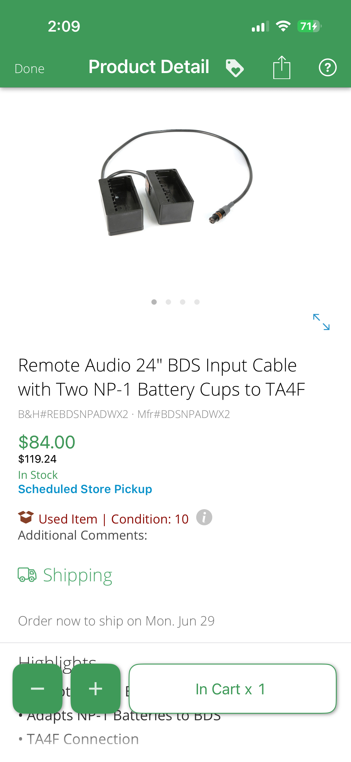

teamrawfish Posted June 28 Report Posted June 28 Curious if I could have one Cup with a battery in it and another running off AC so if I lost power it would switch over to the battery seamlessly. Or would it constantly be drawing off the battery and the AC at the same time and eventually kill the battery? Quote
The Documentary Sound Guy Posted June 28 Report Posted June 28 You need to spell out more details about how you are converting AC into something that plugs into an NP-1 cup. There are ways to do AC failover, but a dual battery cup is not one of them. Quote
teamrawfish Posted June 28 Author Report Posted June 28 I would use one of those ac cup adapters that slot into one of the cups. Run to a remote audio v4 bds system Quote
The Documentary Sound Guy Posted June 28 Report Posted June 28 I haven't seen one of those, but it's a start. How it interacts will depend on the relative voltage between the battery and whatever the DC adapter puts out. It will always pull to some extent from both, but it will favour the higher voltage source, which will often be the battery (meaning, the battery will not stay charged as an emergency source). I don't think it does what you want it to do, which is draw from AC and only pull from the battery if the AC is removed. You need a proper fail-over circuit to do that. Quote
The Documentary Sound Guy Posted June 28 Report Posted June 28 In that case, it would probably draw most of the power from the AC, but you'd still get residual draw on the battery that would slowly deplete it. It wouldn't stay at full charge. I'm also not sure what the long term effect of having a voltage difference in parallel would be on the battery. It should tolerate it to some degree, but there's a reason for the standard recommendation to use similar brands & age when pairing multiple batteries. You'd be violating that recommendation. I would think most NP batteries should have circuitry to prevent damage, but it's not a scenario I'd be happy with long term. If you feel like trying it, I would think it should be safe enough to 'work' in the short term and you can see if you can live with the oddity around running the battery down, but it's not something I'd recommend. Quote

JesseF Posted June 29 Report Posted June 29 On 6/28/2026 at 2:49 PM, teamrawfish said: The AC plug on outputs 15V/5amp. I've not experienced an AC to DC converter for NP-1 cups that outputs 15v. If yours does, then you should be fine. All of mine did 12-13v which was way lower than my NP-1 output and so I never got this particular setup to work properly. I did use the dual NP-1 cup for two NP-1 batteries and that worked great. However, take care if you decide to hotswap NP1 batteries with dual cups, if the battery voltage is too disparate you can snap drain a fully charged battery and run into problems. Quote
