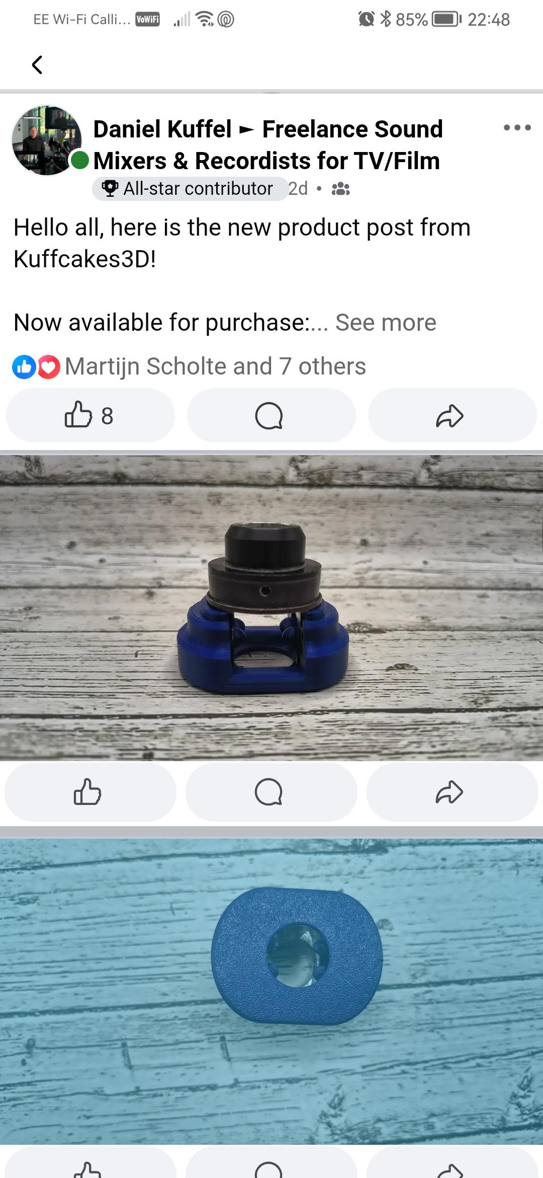

3 hours ago, r.paterson said:
This has been released for Loon boom. Poles.. https://www.kuffcakes3d.com/
Thank you for the link i see a bunch of accessories i need to consider
