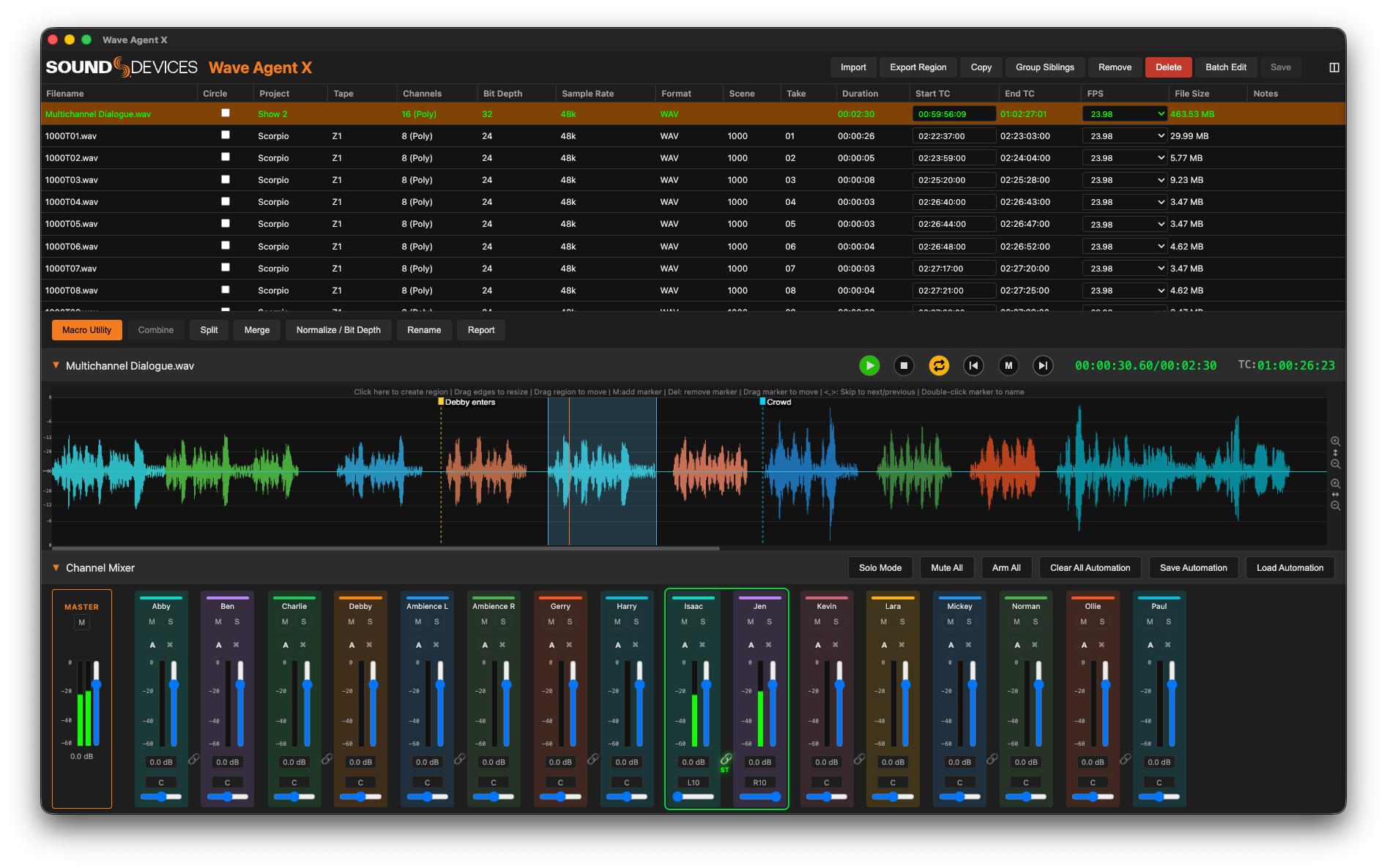

Jim Feeley Posted September 16 Report Posted September 16 [Note that I'm not connected to Sound Devices other than as a customer and acquaintance of some people there. --Jim] "Designed for Production Sound Mixers and Post Production Editors, Wave Agent X provides a comprehensive and indispensable toolset for reviewing, editing, and preparing audio files for problem-free passage through complex production workflows. Available for Mac and Windows." It's been a loooooong wait, but we can finally download Wave Agent X here: https://www.sounddevices.com/product/wave-agent-x/ Quote
Izen Ears Posted September 16 Report Posted September 16 This looks like it's 97% stuff I'll never use, but apparently it can be used to refresh iXML. Does anyone know how to do this? I guess I need to do this to merge Deva files using Bouke's BWF Merge. Also - why does this version automatically say 24FPS when the files are all 23.98? Dan Izen, dummy Quote
Philip Perkins Posted September 16 Report Posted September 16 Am glad to see support for more channels (32). The group/ungroup siblings feature is cool. It still does the other things I liked (split/combine, batch change of frame rate etc). Snazzier graphics, and a mixer with waveforms too. It's cool for me to be able to record as mono files then be able to "sibling" them so I can play all the files of that take at once and mix them during playback. And still FREE! thanks again, SD! Quote

inspire Posted September 21 Report Posted September 21 I’ve installed Wave Agent X and I’m very happy to have both Wave Agent X and Wave Copilot. Although some features overlap, I don’t see them as competing tools. Wave Agent X is a very capable free WAV/metadata/multitrack utility, while Wave Copilot has some more specialized production features, such as audio-based sync between recordings without TC. So for me, they complement each other rather than replace each other. I’m definitely keeping both. Quote

resonate Posted September 29 Report Posted September 29 Something is funky with the X version. Files from my Nomad recorded at 25fps Tc also "show up" as 24fps in Wave agent X. Or maybe the GUI is misleading, because it shows fps as a drop menu? Ready to fix the fps tc rate after the lazy sound mixer ? ;-) anyway the iXML and bEXT tabs show proper fps, which is 25. Quote
paul isaacs Posted September 30 Report Posted September 30 7 hours ago, resonate said: Something is funky with the X version. Files from my Nomad recorded at 25fps Tc also "show up" as 24fps in Wave agent X. Or maybe the GUI is misleading, because it shows fps as a drop menu? Ready to fix the fps tc rate after the lazy sound mixer ? ;-) anyway the iXML and bEXT tabs show proper fps, which is 25. Will be fixed in next release. In the meantime, you can batch convert FPS. Quote
