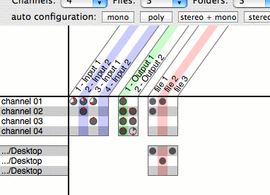

takev Posted February 3, 2007 Author Report Posted February 3, 2007 Hello Everyone, I have made a user interface for the mixing, I hope it becomes more clear with what is happening. The amount of signal is shown as a pie, a full pie means the full signal, a half pie means -18 dB, en empty pie is at least -36 dB. The red dot shows a little change, 1 dB at a time, it goes 6 dB in full circle. The whole thing works pretty much like a clock, except there are 6 positions instead of 12. Where the big hand is the red dot and the little hand is the pie. You can simply change the value by pressing on the + or - keys on the keyboard. Quote
takev Posted February 3, 2007 Author Report Posted February 3, 2007 Hello everyone, I think I am now pretty happy with the results of the mixer, I have added color coding to the pies so that you will be able to see and control the amount of attenuation from 0 dB to 108 dB in increments of 1 dB (or mute). From AppleScript you can control the attenuation from 0 dB to 999 dB (or mute) in increments of 0.001 dB. I am planning on releasing version 7.21 fully, but I would like to have some feedback of the beta first, as a lot of core functionality has been changed. You can download the beta version here: http://www.vosgames.nl/downloads/BoomRecorder-7.21b7.dmg I hope everyone has fun with this new version. Cheers, Take Quote

Ramsay Posted February 4, 2007 Report Posted February 4, 2007 Take, As you know I am super happy with Boom Recorder. I like that you have made the patch bay squares a bit bigger. I guess I am similar to some other mixers in that we like Boom Recorder for it's ease of use and robust behavior. Changing Metadata after the fact is the only thing I can think of which might help me although I only needed it once on the last movie (out of two thousand "roll sound's"). Anything you add is a bonus to me. All the best, Patrick Quote
takev Posted February 5, 2007 Author Report Posted February 5, 2007 Hello Ramsay, I don't think I have made the squares bigger, they are still 14 pixels across. I did make the buttons inside the squares bigger otherwise it would be impossible to read the level from it. I do have to work on the editable metadata, that is more important than the Audio Units thing. The new version is a continuation on this effort, it now can handle variable-header-lengths, this is needed when editing files that are foreign to Boom Recorder. I will now focus my effort on having a very robust wav file reader to handle foreign files without crashing and reading all possible metadata. This has to be done, before I feel confident in editing any wav file (foreign or Boom Recorder native). Cheers, Take Quote

larry long Posted February 5, 2007 Report Posted February 5, 2007 Take, I downloaded the Beta BR and just installed it. I'm confused about something. Do have to use applescript to control those parameters? LL Quote
takev Posted February 5, 2007 Author Report Posted February 5, 2007 Hello Larry, No, after you have turned on a joint, you can use the minus '-' and '+' keys to change the volume of that joint. You will have to keep your mouse pointer on top of the joint. Cheers, Take Quote
larry long Posted February 5, 2007 Report Posted February 5, 2007 Derr ! I was using the page up and down keys lol Thanks Take nice work, LL Quote
