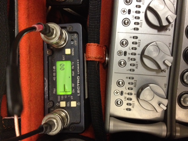

ProSound Posted November 1, 2011 Report Posted November 1, 2011 I just loaded up my new Petrol 601 with my 3 211 block 27 units and my 788T and I am greeted by some serve RF spray. The Scan with 788T powered on is same whether it is powered from common power source (BDS Box) or the 788T is powered from internal battery all 3 of my 211 block 27 units show similar scans as well. I didn't think the 788T had any RF spray and hadn't experienced any with same set up in my larger Petrol PEGZ-2 bag Any thoughts? Quote

ProSound Posted November 1, 2011 Author Report Posted November 1, 2011 Spray became much more evident in the smaller bag. I am going to move thing around some more in the bag and see if I can help it out Quote
