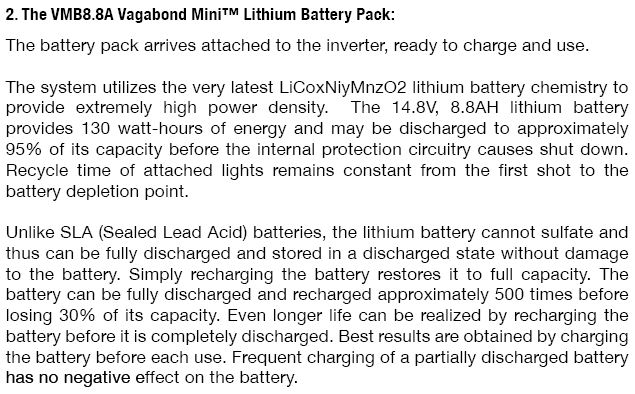

benr Posted January 8, 2012 Author Report Posted January 8, 2012 More info on the battery. The manual is actually pretty informative. Heres a link to it if any of you want to look it over: LINK Quote
soundslikejustin Posted January 8, 2012 Report Posted January 8, 2012 Have you seen any information revealing that the charger will automatically shut off once the battery is fully charged? I usually charge when i'm asleep so having to manually unplug once its done isn't an option for me. That's the only thing holding me back right now from doing my custom LiFePO4 battery setup in the other thread here. Most 'smart chargers' and even some rudimentary ones can detect the end of charge voltage and stop the charging process. Some then apply a 10ma or so trickle charge, some don't. Check the specs on the charger, and see if it terminates the charge, or just changes an LED to indicate the battery is at full voltage. This is the difference between being able to leave the battery on charge while you sleep, or not. Quote
soundslikejustin Posted January 8, 2012 Report Posted January 8, 2012 More info on the battery. The manual is actually pretty informative. Heres a link to it if any of you want to look it over: LINK It doesn't say if the cut-off is inside the actual battery, or within the main unit (inverter section). This may mean that it is up to the inverter section to cut the battery off when it is empty. Because you can charge directly into the battery (you don't have to go through the inverter), I'd say there's at least some circuitry inside the battery itself - for balancing (hopefully), and possibly in the charger (my initial thought was that it might just be a 'dumb' 12VDC power supply). So you're probably protected while charging, we just can't be sure that the battery has a LVC in it... Quote
benr Posted January 8, 2012 Author Report Posted January 8, 2012 It doesn't say if the cut-off is inside the actual battery, or within the main unit (inverter section). This may mean that it is up to the inverter section to cut the battery off when it is empty. Because you can charge directly into the battery (you don't have to go through the inverter), I'd say there's at least some circuitry inside the battery itself - for balancing (hopefully), and possibly in the charger (my initial thought was that it might just be a 'dumb' 12VDC power supply). So you're probably protected while charging, we just can't be sure that the battery has a LVC in it... Very true... Hmmm... Might have to shoot an email to them and/or check their forums. Ill post back with what I find. Quote

benr Posted January 8, 2012 Author Report Posted January 8, 2012 Based on this thread one of the manufacturers tech support admins stated that the LVC is in fact in the battery. http://www.paulcbuff-techforum.com/viewtopic.php?f=8&t=1793 Quote
