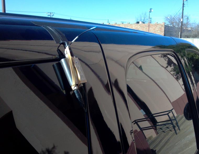

pverrando Posted March 31, 2013 Report Posted March 31, 2013 Great story. Similarly, I had 2 SMV at 250mw mounted externally on two police cars, fed by plant mics inside the cars and taking power from each car's 12 volt cigar lighter. Our follow vehicle had two SNA600 dipoles mounted about 12" above the roof on fiberglass poles, feeding a Venue Field. On the highways, we would get up to 1/2 mile range, sometimes more. In the city, we would routinely loose the cars in traffic, but could usually hear them. Quote
Jack Norflus Posted March 31, 2013 Report Posted March 31, 2013 Pete How did you feed 12 volts into the transmitter? Quote

pverrando Posted March 31, 2013 Report Posted March 31, 2013 Lectro makes am AA batt eliminator for SM's that takes 6-18 volts. Quote
