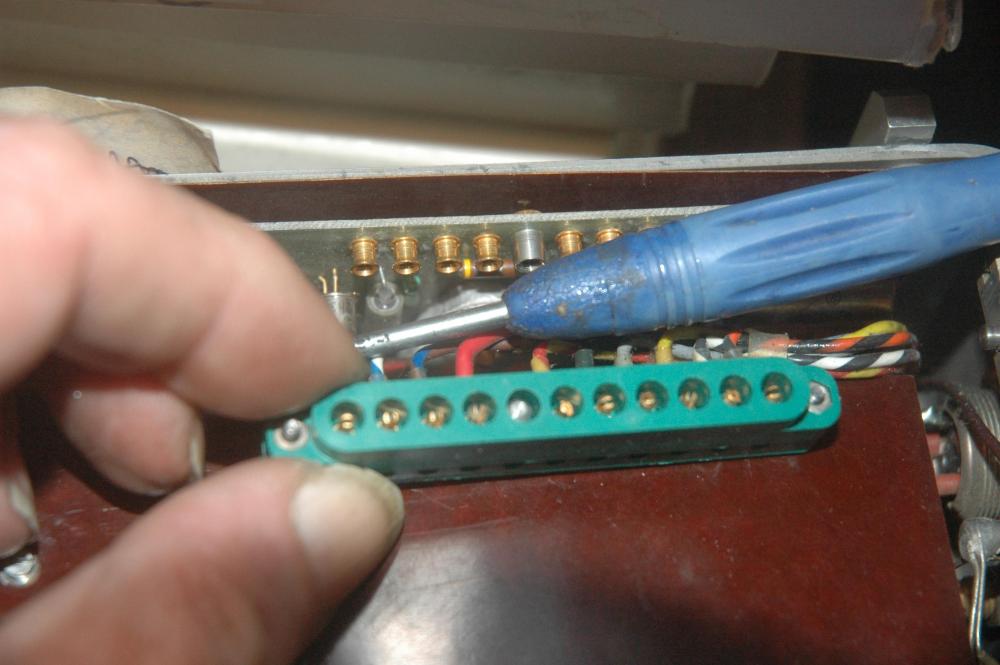

one of my 4.2's was running about 20ips , irrespective of speed switch.
no , it was not in f fwd.fault traced to poor gold  split connections to the speed control board at rear.. unsrew the 2 screws securing the 2 green plugs and gently, with a jewellers screwdriver, prise each  split gold pin , slightly wider, to ensure a better tight fit.
this cured the problem.
