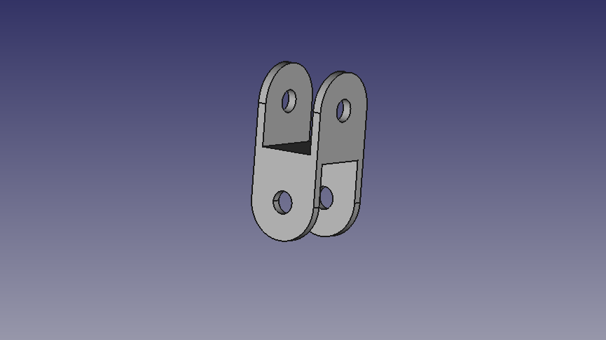

Easyrig send me their apparently last piece of the upper profile assembly, that did not have the nose. I have not yet installed it, as pulling the current one out of the arm is quite tricky. I'd also like to try out what happens if I replace the roller chain connection link with something like this, but I have no idea what it would be called or what to search for. I might consult a locksmith/some local metal person to make it, but this likely already exist and could be cheaply available and I only want to experience the behavior with this mechanical configuration. The fork width is roughly 13mm (inside). Wall is 1,75mm (my drawings are 2mm).
