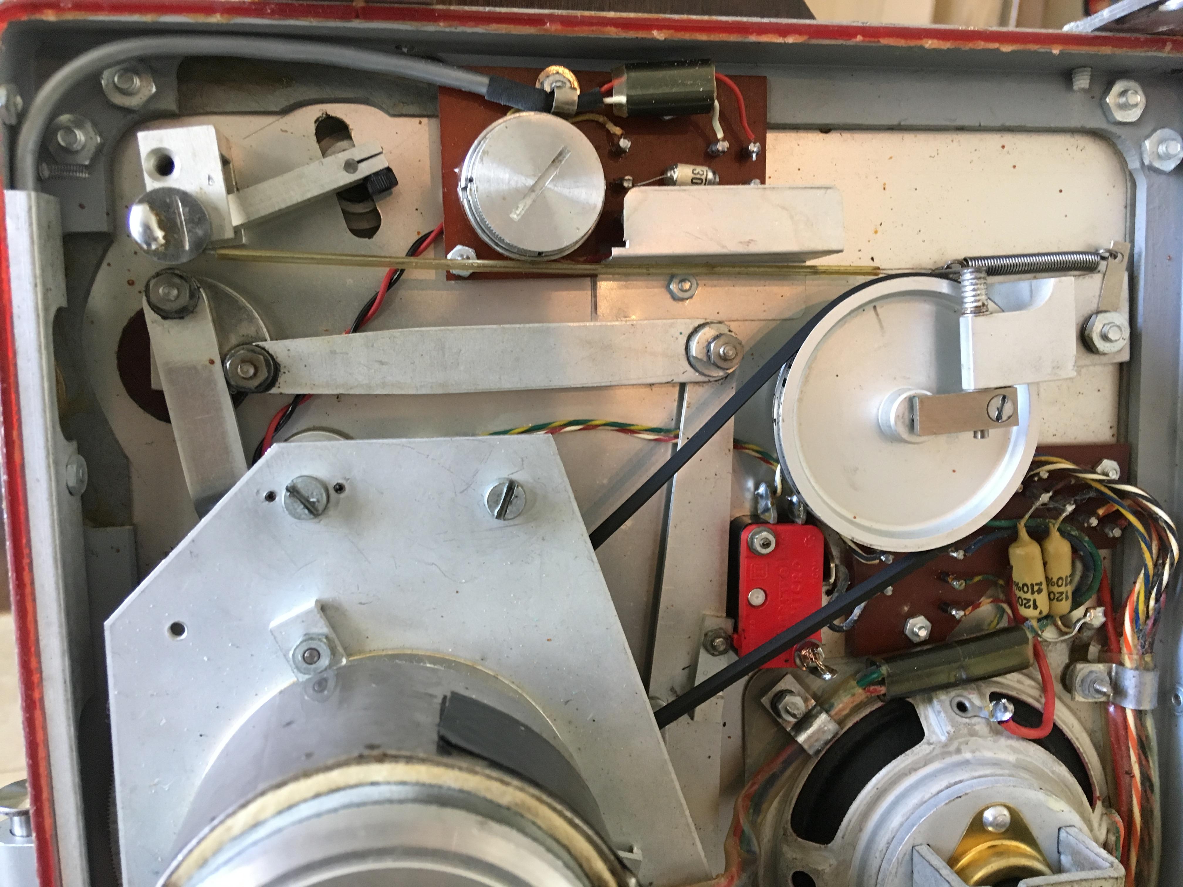

SonicBoomPole Posted February 20, 2021 Author Report Posted February 20, 2021 Thank you so much for your reply TBFAN! I have uploaded a few photos of the inside of my Nagra for your diagnosis. I have not tried to use batteries due to a note written inside the battery compartment as seen in the photo. It reads: When battery operated a shorting plug MUST be used Pins 2 and 4. So if I just take a piece or wire and connect pins 2 and 4 together would that be sufficient? The belts are not tight and should be replaced. I need help with that. I have some resources to follow but have not taken the time since it will take me a while to complete carefully. I will look at the service manual you provided and see if I can make any sense of it. The troubleshooting at the end looks helpful. Thank You again! Kevin Quote
tbfan Posted February 21, 2021 Report Posted February 21, 2021 Ok this is going to be a little more difficult. I think someone has changed something on their Nagra. I guess judging by their location they should be able to speak perfect English and (if they haven't done so, have a look at the user manual) (https://www.nagraaudio.com/product/nagra-iii/ scroll down to downloads ) First the belts: The Nagra has 3 round (!) belts: 2x 90mm x 2.5mm or 3mm 1x 64-66mm x2,5mm I can't explain the exchange exactly, but if you have some time I will make a video about how to exchange all three belts without having to readjust everything afterwards. On page 15 (Electrostatic discharge) is something about a small brush ... Read this passage and compare it with your Nagra. You can find this brush on the Honywell switch for the fast rewind (this little red box, on the take-up reel) https://museumofmagneticsoundrecording.org/images/R2R/NagraIIIManual.pdf Page 27 block diagramm. On the bottom of the page is the wiring of the Tuchelbuche as it should be. (To the left of the playback head) Contact 2+4 would be: Ground (2) and motor stop (4) Quote
SonicBoomPole Posted February 21, 2021 Author Report Posted February 21, 2021 4 hours ago, tbfan said: Ok this is going to be a little more difficult. I think someone has changed something on their Nagra. First the belts: The Nagra has 3 round (!) Belts: I can't explain the exchange exactly, but if you have some time I will make a video about how to exchange all three belts without having to read just everything afterwards. Great observation! Strange. This is exactly how I received it. The replacement belts I ordered are round, 3 of them. A Video of the belt installation would be INCREDIBLY helpful, thank you. 4 hours ago, tbfan said: On page 15 (Electrostatic discharge) is something about a small brush ... Read this passage and compare it with your Nagra. You can find this brush on the Honywell switch for the fast rewind (this little red box, on the take-up reel) OK I will investigate this and report back, thank you. 4 hours ago, tbfan said: https://museumofmagneticsoundrecording.org/images/R2R/NagraIIIManual.pdf Page 27 block diagram. On the bottom of the page is the wiring of the Tuchelbuche as it should be. (To the left of the playback head) Contact 2 + 4 would be: Ground (2) and motor stop (4) Yes, that seems correct. So is that standard to have to short these pins to use batteries? I prefer to use the EXT DC input for my purposes going forward. Thank You for shedding some light on this mystery of mine and giving me something to do during this time of no work and no light at the end of the tunnel. Quote

SonicBoomPole Posted February 24, 2021 Author Report Posted February 24, 2021 New belts were installed yesterday and now I can rewind a tape, I'm so excited! It wasn't as bad as I thought but there were some moments of shouting expletives. I was not able to remove the smaller belt under the motor. I couldn't get the old one off. It seems to be in good shape however and if it becomes a problem I have a replacement. I also found the electrostatic discharge wire and put that back how it should be (I hope). My next challenge will be the Playback Amplifier. Test mode and Record mode seem to be working fine. I get good mic and line level signal input and sound through the recording amplifier to the monitor output (phones) but upon HiFi playback there is very low output and no movement on the modulometer at the same output level on the fader (0db). I'm assuming there are out of spec components in the PB amp that need replacing. Tested at 7.5 ips NAB and 15 ips with the same results. Also, FYI for anyone reading this hoping to get service on a Nagra III I did call Forrest Forbes formerly of Trew Audio and left a voice mail but never got a response. Quote
