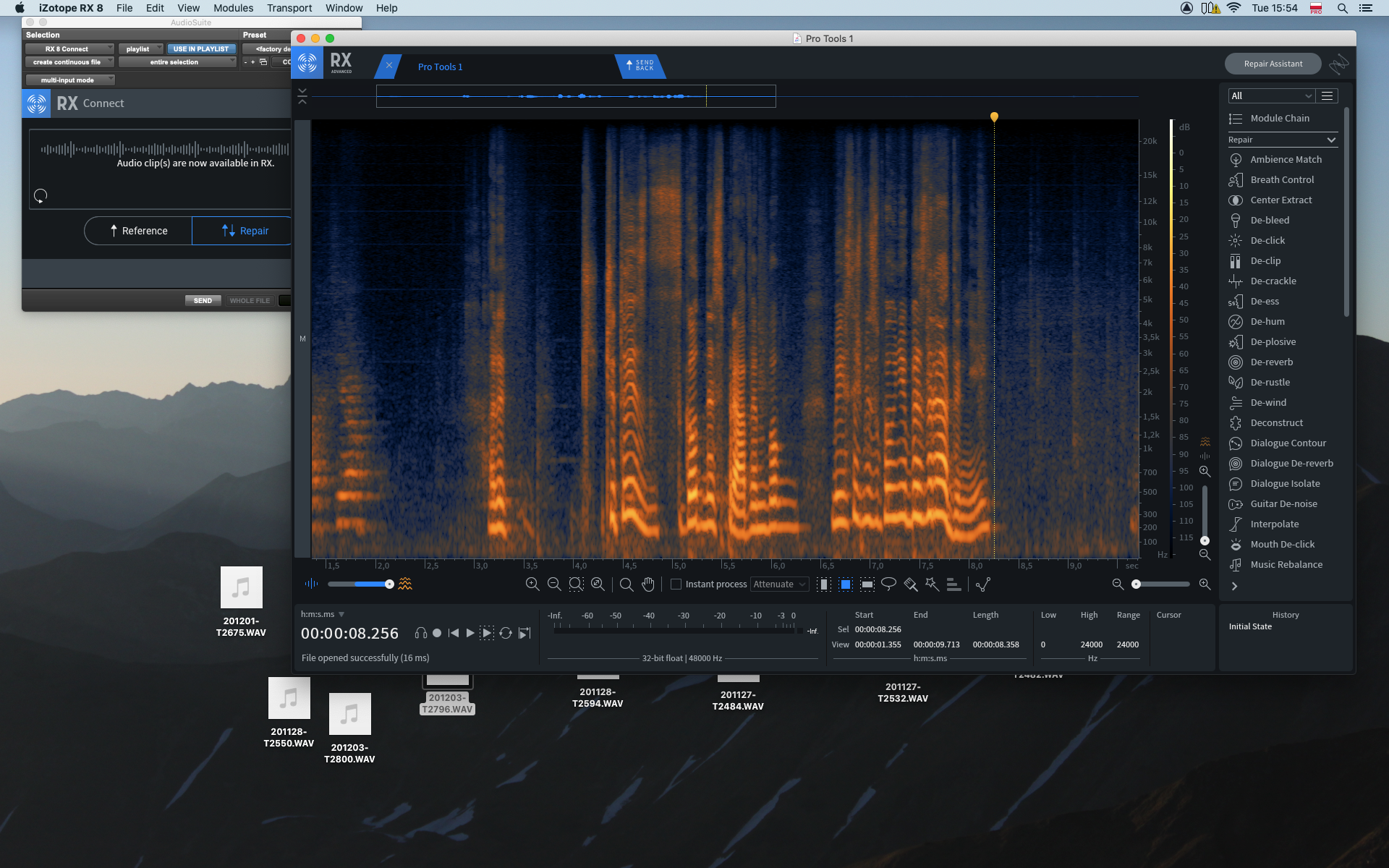

IYS Posted February 28, 2021 Report Posted February 28, 2021 Hi, I have the same situation with SMWB, I ve bought 3 units on September 2021 with SRC receivers and the hiss is still much recogizable even after turned off rc... (which I actually need to use), its starts at 2750 Hz... (screenshot attached) any ideas very appreciate, Thx! Quote
karlw Posted March 1, 2021 Report Posted March 1, 2021 IYS - I'm not sure this is the same issue as reported by the OP. What mics are you using with these transmitters? How are they wired? Have you tried other microphones, or line level sources? How is your input gain set? What compat mode are you using? Karl Winkler Lectrosonics, Inc. Quote
IYS Posted March 2, 2021 Report Posted March 2, 2021 Hi Karl, Thanks for answering! I used them with DPA4061 and 4060, comp EU Hybrid, and NU, but actually tested with others to with the same results.. gain around 25/27 sometimes lower, but I didn’t see changes at hiss level much, didn’t try line level, but I pluged DPAs direct to the recorder and the sound was clear.. Quote
