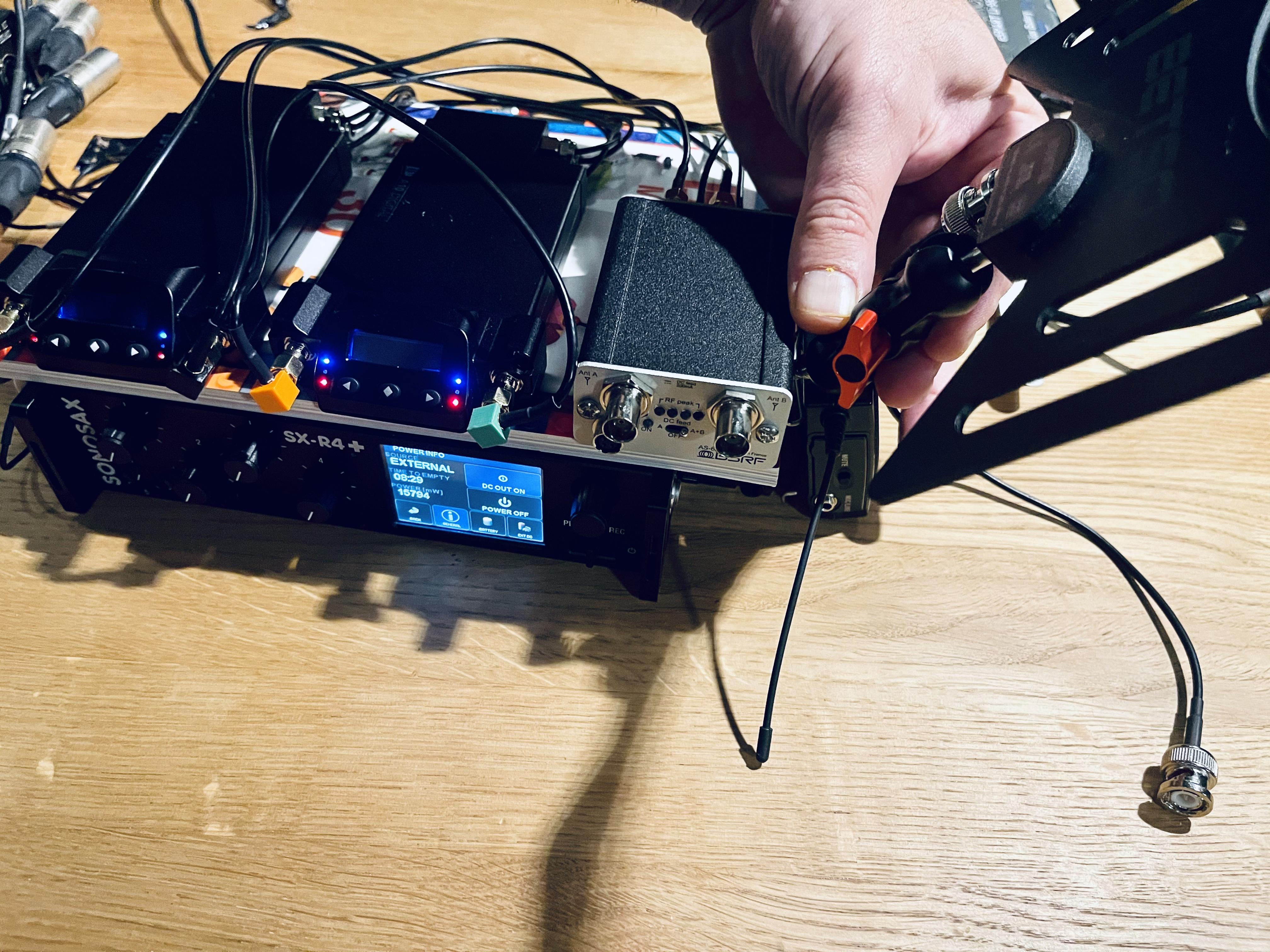

  1. I am trying to «compress» my soundbag to be as light and small as possible. I will be ordering a custom bag and i am now testing the «layout». Trying to make it really really compact. Is there a minimum distannce between rf receiver / antenna distrubution / bowtie antenna and sennheiser g4 camera hop? In other words will the performance be a lot better if there is 20 cm vs 5 vs 2 cm from say bowtie to g4 ? Any reason not to have the two rx receivers and the distro almost touching eachother inside a «pouch» ? See picture of my initial plan. (Antenna distro is filtered between 470 and 700 but my g4 hop is in the same range )
