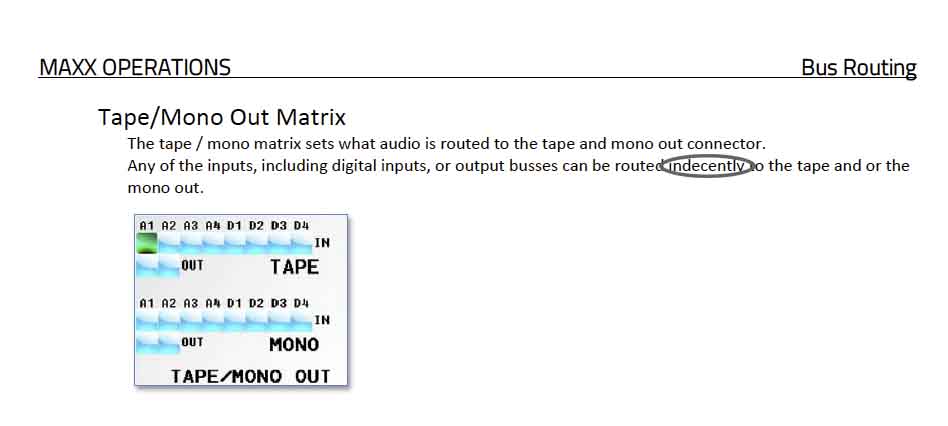

A dangerous practice as noted in the Zaxcom Maxx Manual. Please be careful out there.
