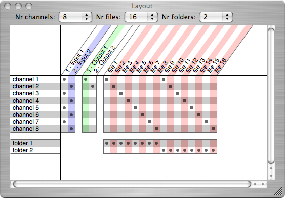

takev Posted April 16, 2006 Author Report Posted April 16, 2006 Hello everyone, So I finally have a screenshot to show you; for the new layout window. input and output assignment are already working, they have a circle shape because you can only assign one of them per channel. Cheers, Â Â Take Quote
Jeff Wexler Posted April 16, 2006 Report Posted April 16, 2006 That screenshot looks pretty good and is a nice clear matrix. Does "Nr" stand for "Number" of tracks or whatever? - JW Quote
takev Posted April 16, 2006 Author Report Posted April 16, 2006 Hello Jeff, Yes, the "Nr" stands for "Number". There is probably enough room to write the word "number" out in full, or just drop the word completely. Quote
Jeff Wexler Posted April 16, 2006 Report Posted April 16, 2006 Yes, the "Nr" stands for "Number". There is probably enough room to write the word "number" out in full, or just drop the word completely. Just drop it. CHANNELS FILES FOLDERS - JW Quote
Philip Perkins Posted April 16, 2006 Report Posted April 16, 2006 Cool--this would allow a Metacorder style split of recorded files into "telecine" and "split-track backup" folders, except that it looks like you could specify more folders than two if you wanted. Philip Perkins Quote
Darren Posted April 17, 2006 Report Posted April 17, 2006 Cool--this would allow a Metacorder style split of recorded files into "telecine" and "split-track backup" folders Philip Perkins I used the dual polyphonic capability on one of the 1st movies that I used Metadorder on. Now I just instruct telecine to only transfer tracks 1 and 2. -Darren Quote
takev Posted April 17, 2006 Author Report Posted April 17, 2006 Hi, Ok, I'll drop the "Nr". And yes it would allow different files in different folder and use more than 2 folders as well. Does anyone think it would be a good idea to also be able to select at which bit-depth 16/24/32 you like to record per file? Or something else you would like to select per file? Take Quote
